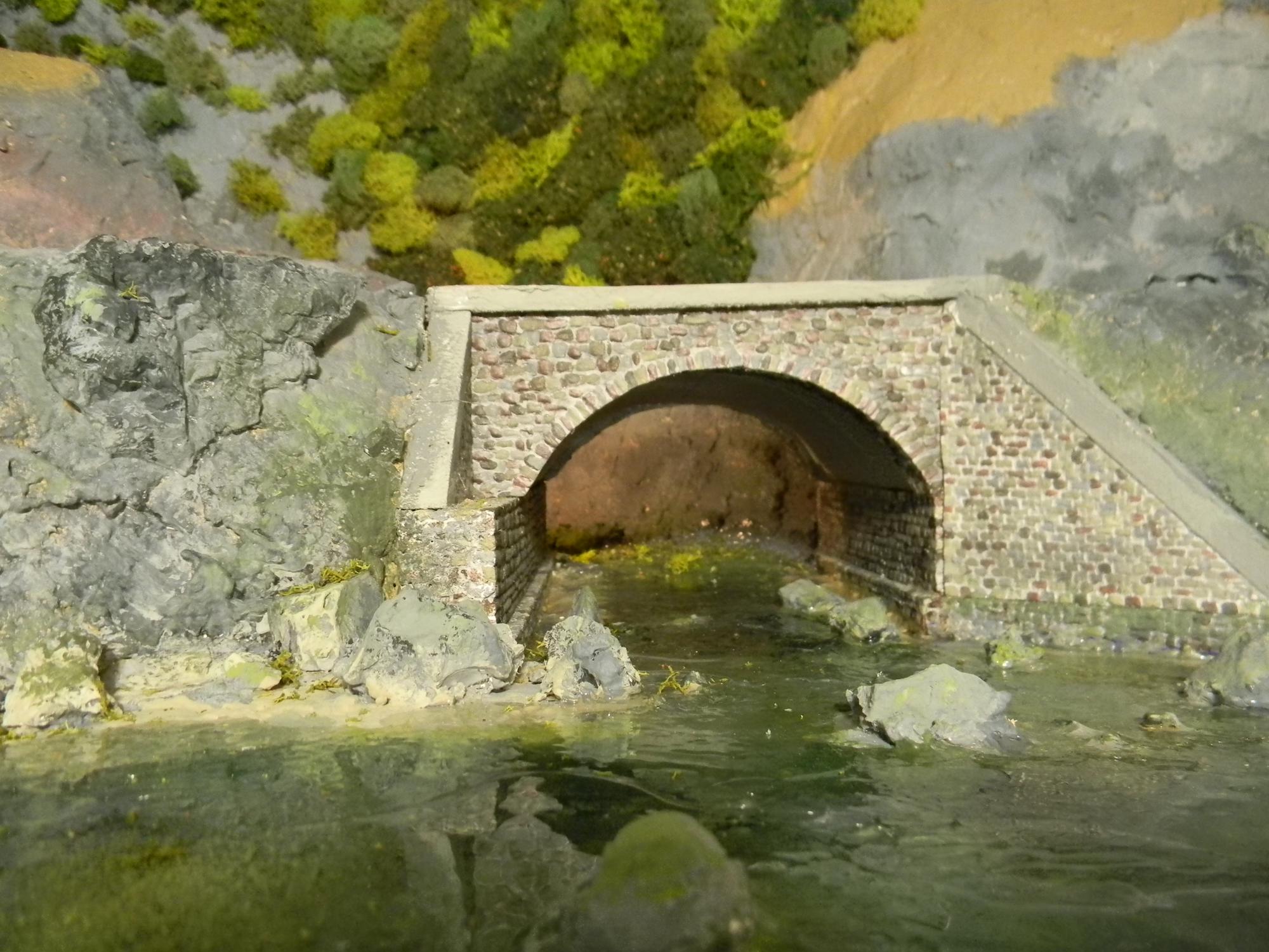

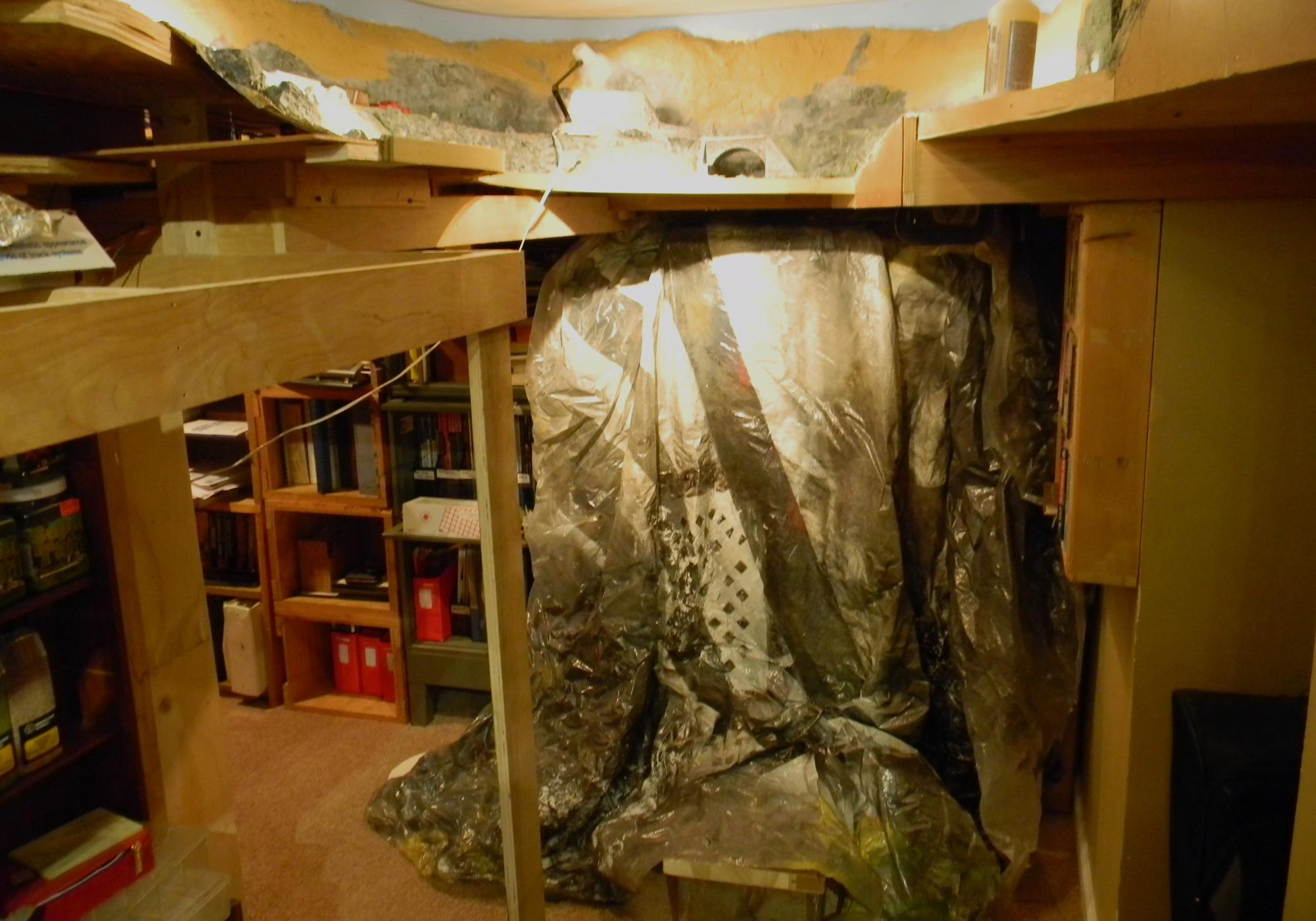

Now that I've done some last minute touchups, it's time to lay down the Realistic Water.  There are always leaks and gaps, and because I have a carpeted office, I need to take a few precautions.  The drop cloth got draped under Mud Run and I did my first pour from the backside of the bridge into the Lehigh.  I'll let this dry and harden up before deciding where the next pour will be - probably from the uphill portion of the Lehigh tomorrow.

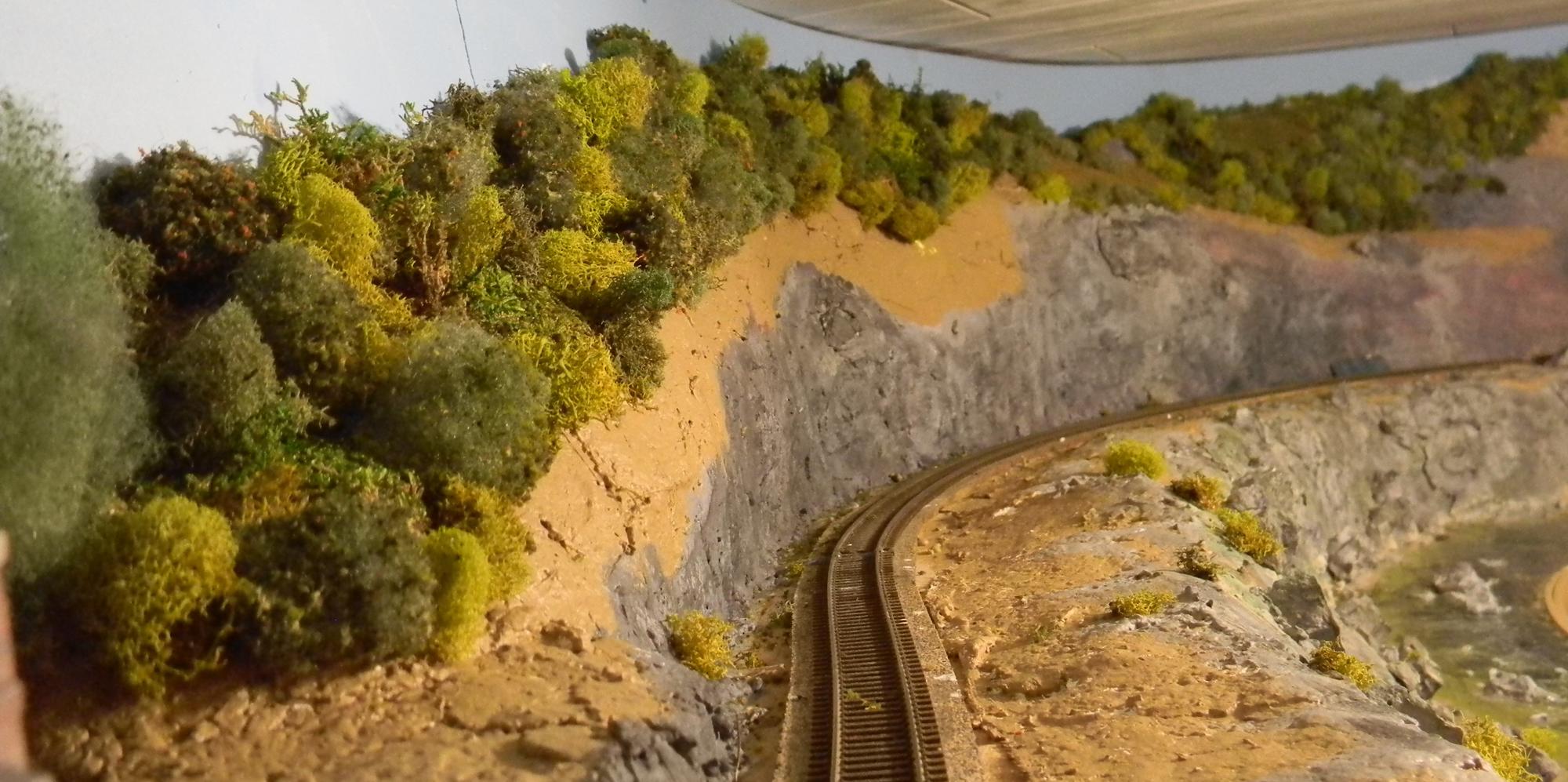

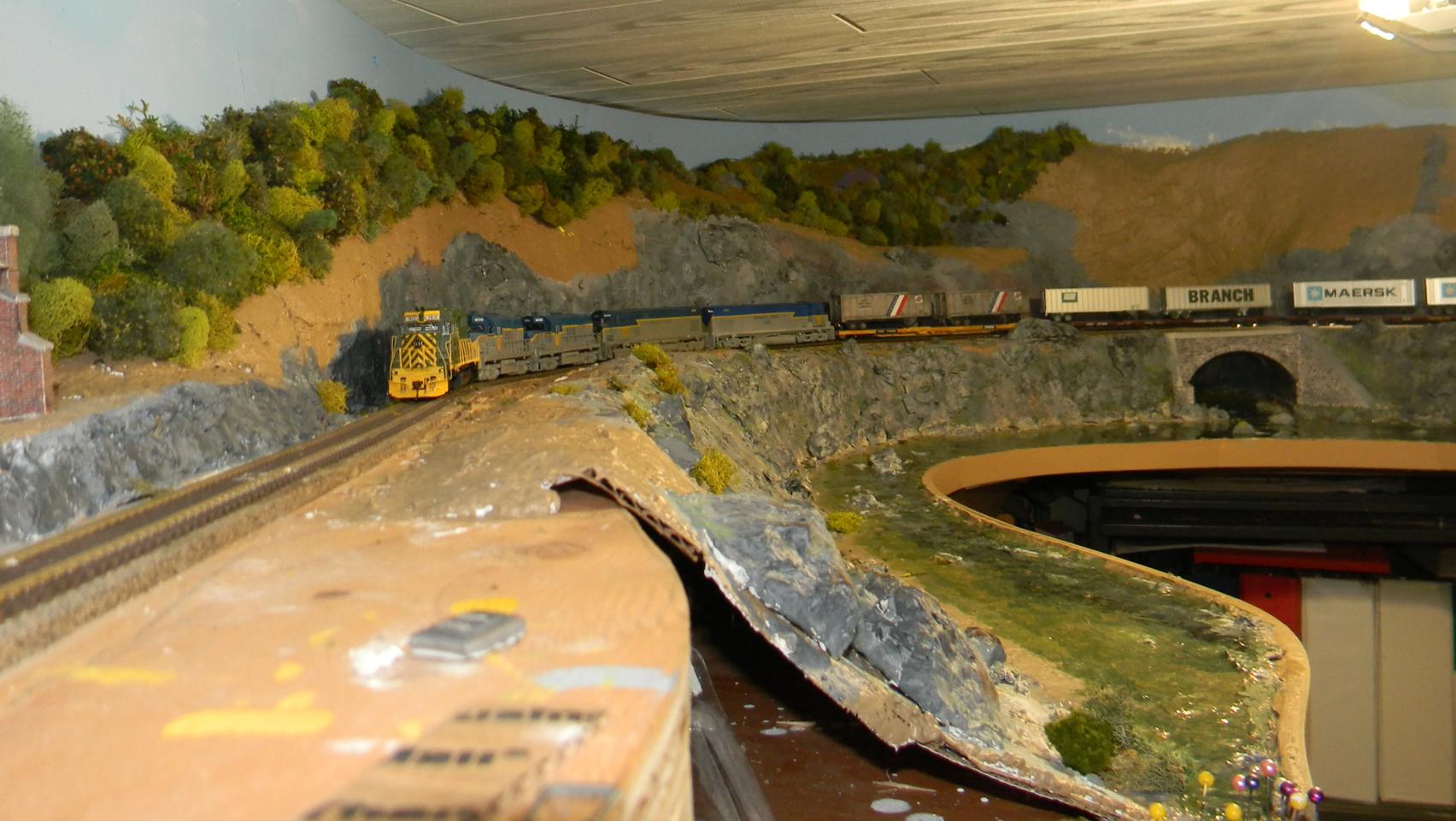

Today was the transition day - from the river to the background scenery on the upper reaches of Mud Run.  Got my favorite "puff ball" tree stuff out of my big scenery box - including puff ball trees (polyfil balled up and sprinkled with ground form), lichen, 2 different colors reindeer moss, moss sheets, Woodland Scenics clumps, etc.  Put some wood glue on a plastic lid and off we went - just filling in the upper portions of the hills.  I got a little bored of that and decided to eventually create some pasture/fields.  If I can find an N-scale farm tractor, I think that would look really good (and due to the forced perspective, probably the right size) up on those fields.
Plan for the rest of the week after work is to continue this effort all the way around to the tunnel entrance.

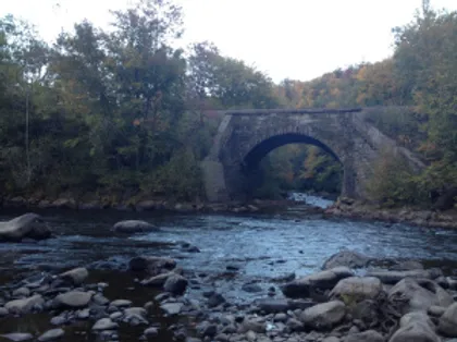

Had the spark of an idea last night before laying my head on the pillow.  My current lighting of Mud Run is from an overhead light which provides lots of light, but not into the area behind my bridge - everything's in shadow back there.  As you can see in the picture below (the real Mud Run bridge), there is substantial light behind the bridge which can highlight some of my scenery that (eventually) will be back there.

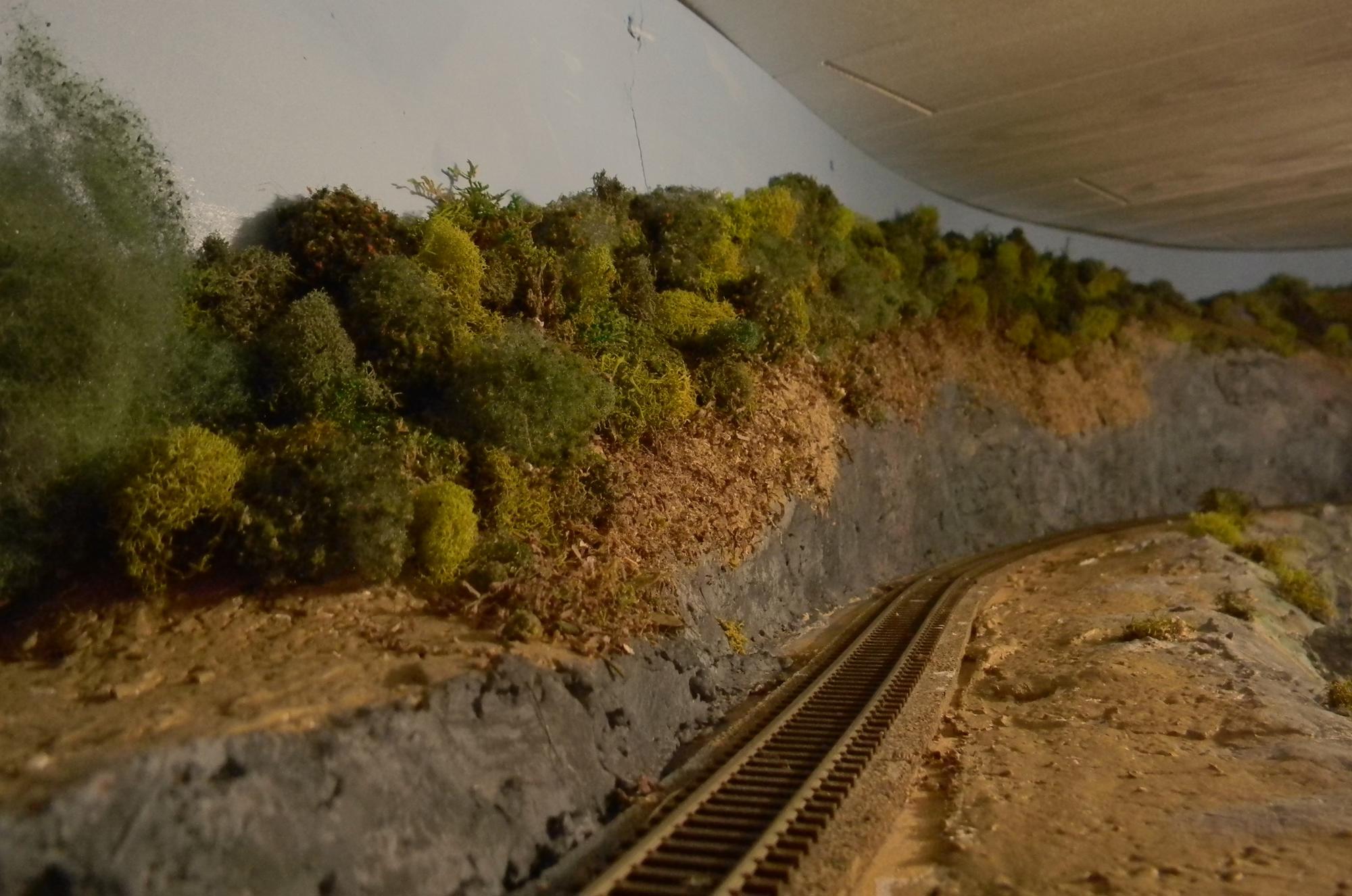

Continued adding puff ball trees to the upper reaches above Mud Run this evening until I realized I was out of one of my favored colors of moss - I should be able to pick some up tomorrow if I can get to Michaels or JoAnn's.  I'm also about out of polyfill ball trees and need to make some more of them.  What to do with another hour or so of layout time?
Got my shaker of mixed brown stuff out.  It's sawdust, coffee grounds, tea leaves, planer chips, leftover lichen, ground foam, moss, etc.  Slapped on some wood glue over the brown-painted areas under my new trees and added the brown stuff to simulate leaf-covered forest understory.  Eventually the shrubbery will also be added to these areas and then the detailed, layered trees.  Got the ShopVac out to pull up all of the extra brown stuff off of the track, and tomorrow is another day.
RE: Rainbows in the Lehigh Valley Gorge - tompm - 12-15-2022
I really like your "brown stuff." It gives the scenery that extra kick.
RE: Rainbows in the Lehigh Valley Gorge - TMo - 12-15-2022
Thanks Tom. I use an empty ground foam container and collect the brown stuff over time. I little of this, a little of that, shake it up and it's ready for dispensing. Looks a lot better once I start putting the trees and shrubs in - which may be sometime soon depending on what's going on at my house during the holiday season. My son's coming up from Texas with his two dogs, so I may be otherwise occupied with little time for scenery.
