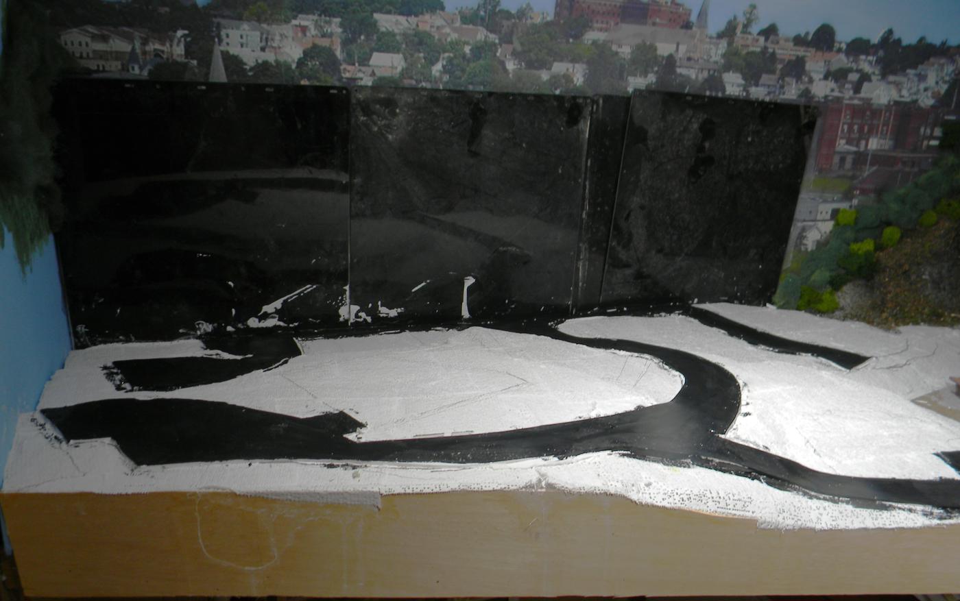

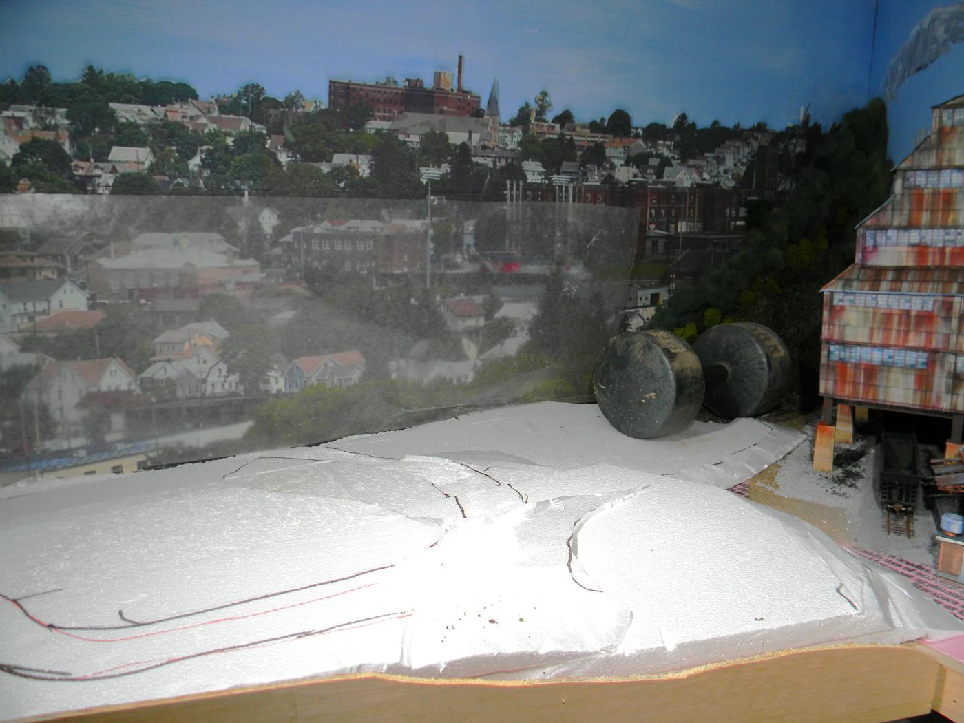

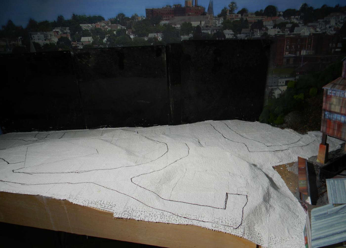

Put plaster cloth down on Monday night, repositioned my structures and drew around their bases last night.  Tonight was spent working out where the roadways will travel through this area.  I think I'll do a little roadway work tonight before calling it quits - I'll be putting down some double-sided tape on the edges of the roadways and then applying Smooth-It for the road surfaces.  This is an industrial area of town, so no sidewalks.

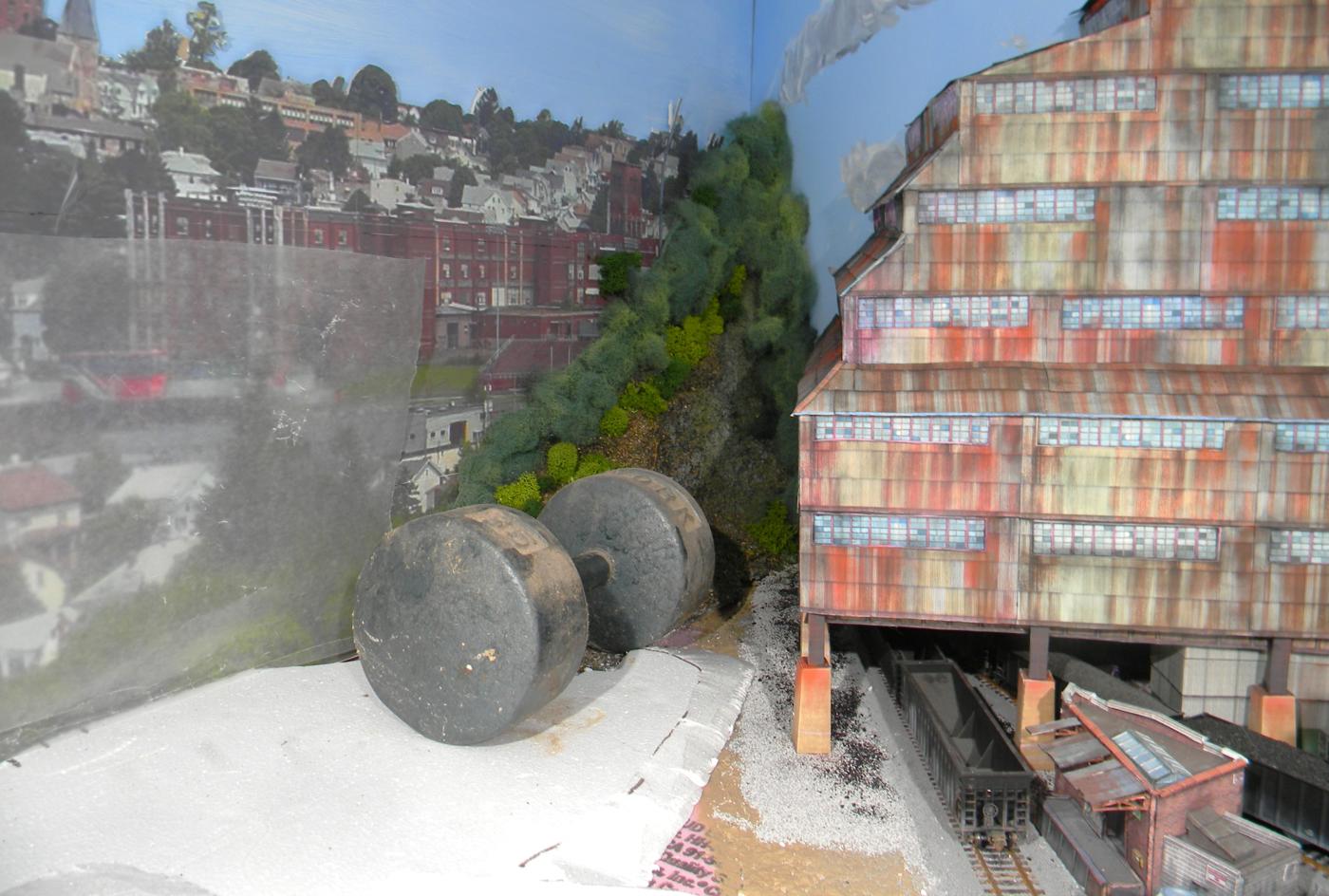

You may notice the black material wedged between the backdrop and the foam/plaster cloth.  I'd remembered that I had those plastic squares in my workshop, and they'll make excellent buffers to prevent the water in the Smooth-It and Sculptamold from migrating into the paper of the backdrop.  Once the plaster hardens, I'll run a razor blade against each piece of plastic to separate them and I should be able to pull them free without too many touch ups.

Smooth-It was laid two nights ago, so after some sanding, I applied the base (black) layer to the pavement.  No glamor or glory here, but necessary activity.  The roadways will get a good weathering coat of gray - only fresh asphalt is black - with some detailing, potholing, patching, etc. after the black dries.  Once the roadways are finished, it'll be time to add the base layer of Sculptamold on the areas that won't be covered by structures and then a covering of brown paint over everything but the roads.  At that point I'll remove the plastic barriers  that are shielding the paper backdrop.

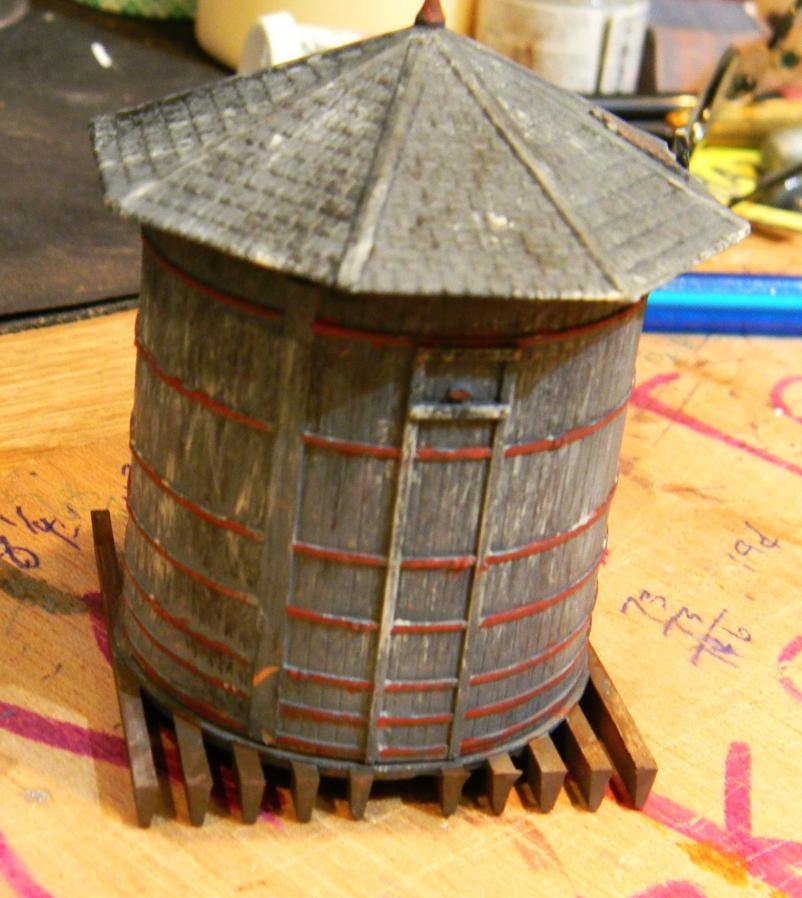

Sculptamold is setting up and drying today - I might get a chance to paint it with some "Road Pizza" brown late tomorrow.  While watching football yesterday afternoon I decided to paint up a water tank that I'd lopped off another one of my childhood kits - one of those classic sand and water facilities.  Might have been a Tyco kit, but can't remember exactly.  Walthers has it in their current catalog like this one:  https://www.trainz.com/products/walthers...fd=0&_sc=1.  I wanted to add some water storage for the roof of either one of the two warehouses in the Hazleton module.  As usual, the plastic water tank looks like a plastic water tank until I got out some paints.  First hit absolutely every surface with a medium gray and while it was drying, hit it with some ivory and black highlights until I was happy.  After drying, I hit the bands with a barn red and the support timbers with a medium brown.

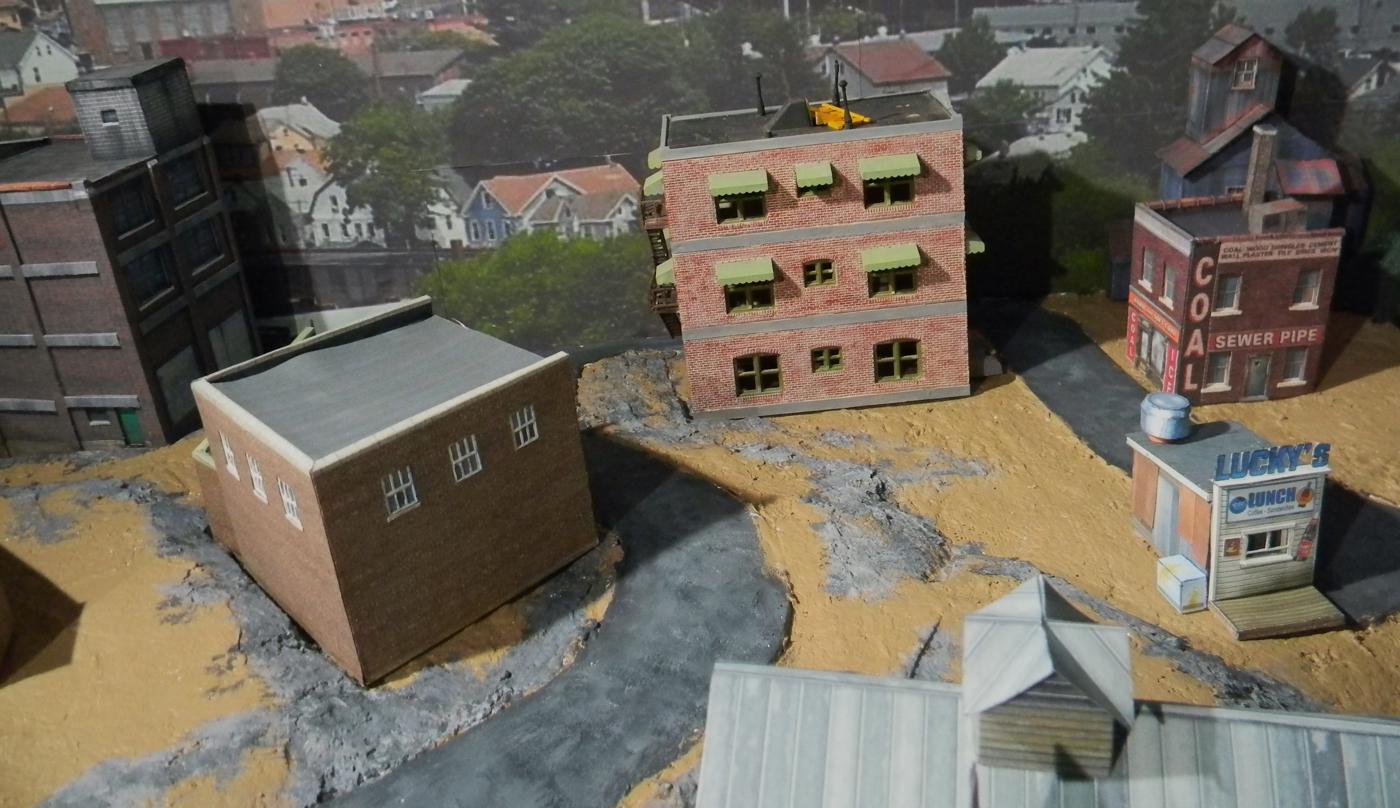

The road pizza painting commenced tonight - a blah brown to serve as a base for the scenery.  I overpainted road edges to make sure I didn't have any more white showing through.  I'll have to retouch the roadways at some point.
Things will slow down now as I work from the back to the front adding scenery details and structures.

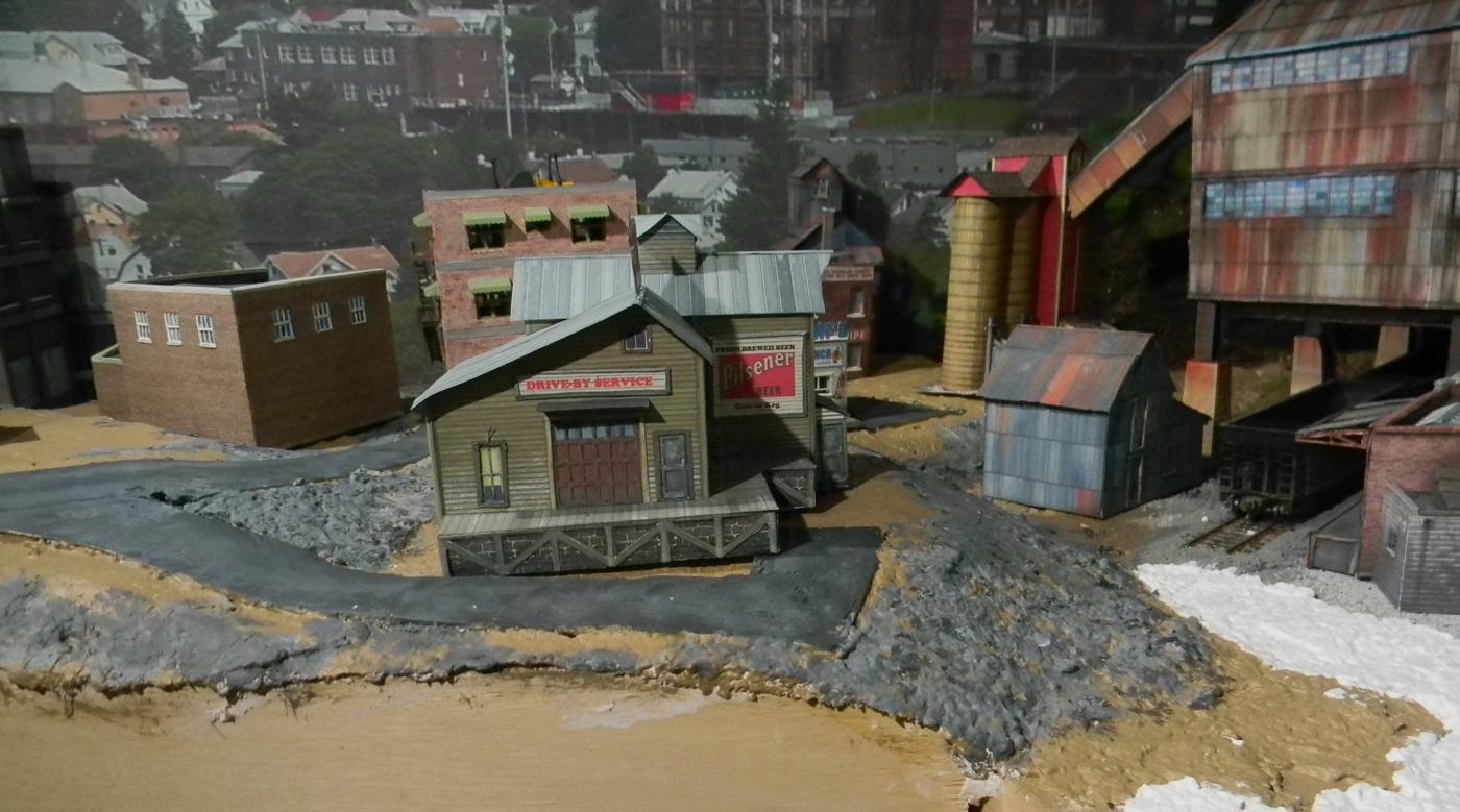

To get a better idea of the scenic elements I want to employ, I stuck the structures on the dry paint.
I'm going to start in the extreme right corner and work my way to the back left before I work forward with scenery and details.  I'm also taking a page from the Charlie book - he inspired me to buy my own static grass applicator and a variety of grass colors that arrived today in the mailbox.  I'm sure I'll work some of that into the scenery, and I think I'll be employing a lot of it in my foregrounds after seeing Bruce's shots over the last couple of years.

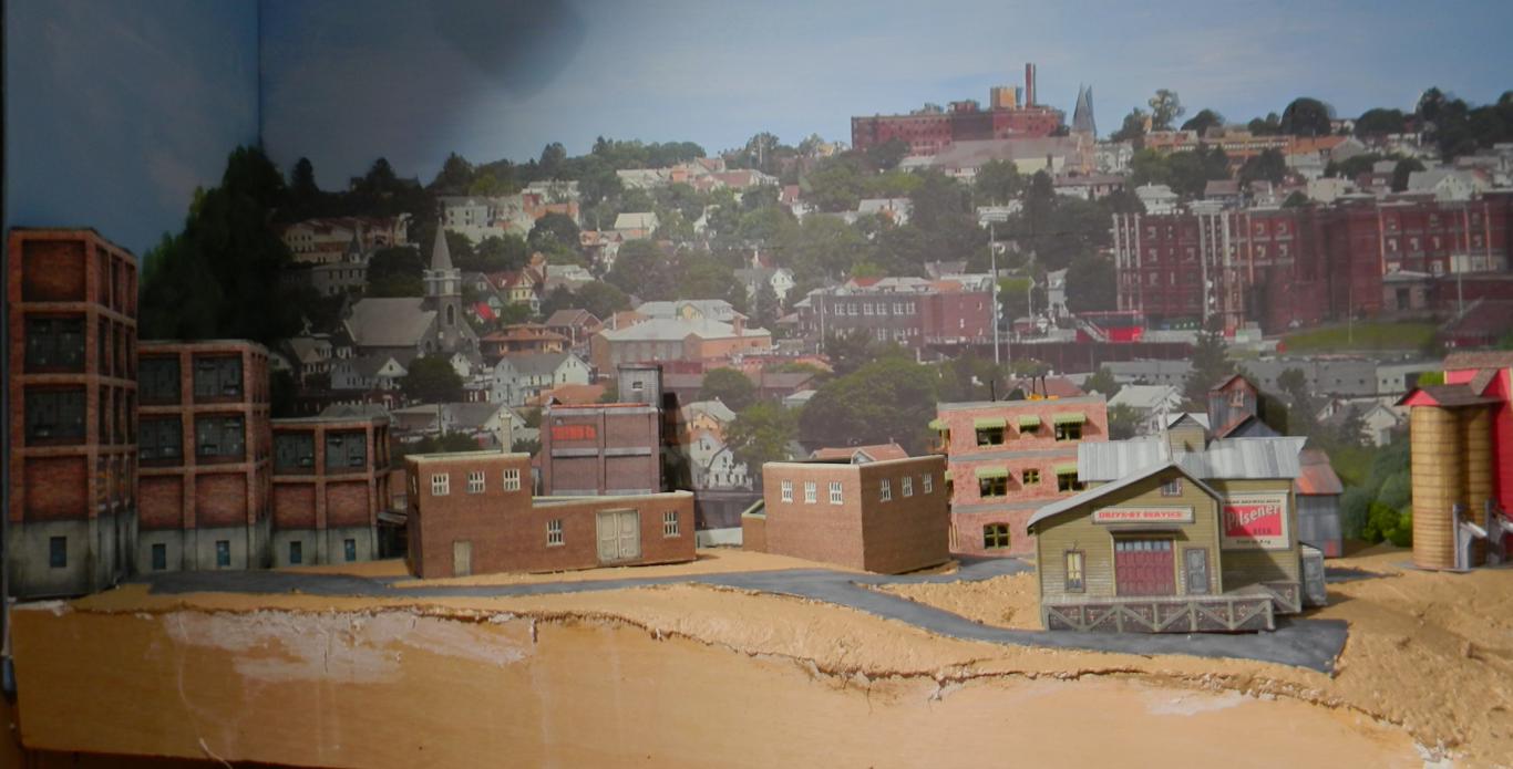

While I was roasting the turkey yesterday morning and before company got here, I started working on some fencing to go up behind the brewery.  If you recall, one of my desires is to make this area of the layout appear to be a good deal deeper than it actually is, and I want to really give the feel that it's receding downhill - the backdrop helps, but I've found that incorporating vertical elements (whether that's structures, walls, fences, or trees) is a great way to break up the sight lines between the front and rear of the available space.
In scale, this fence is about 8 feet tall, and I'm going to place it at the back edge of the hill behind the first section of the brewery and run it between the Duplan Silk Mill and the road near the beer distributor.  It's another Clever model (the HO scale wood fence) made out of cardstock (great intro kit, but I wish there were other colors available) and includes some vertical posts and some additional horizontal stiffeners that I haven't incorporated yet.  The picture below just shows the fence propped up in place temporarily, but just adding the fence is a great way to add perceived depth to the scene and really enhances the perception that the scene runs downhill and away from the viewer.  I won't do a final install until I scenic the areas behind the fence, but it's good to get a good idea of how things look as you go.
