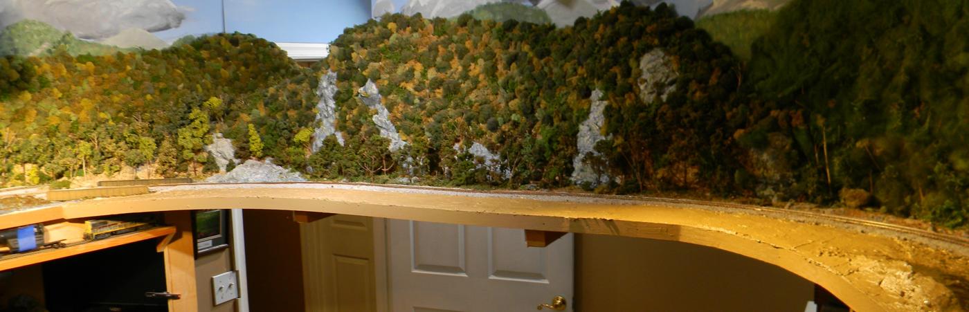

I went for a more "burnt out" look to the grass with the final layers - more like the end of summer with some greener highlights.  I like the scruffy look, and the relatively quick install.  I'll probably add some more shrubbery and maybe some trees, but I would like to preserve some easy access to the track in case of derailments here.  I'm not modeling the prairie, so I made do some selective ripping, expose some rocks, maybe add a few groundcover patches.  I also need to add a little more ballast on the edges.
Checked my supply of plaster rocks and thought I'd need to make some more to apply to the face of the mountains I'm going to scenic next - my stock was pretty low, so I got out my Woodland Scenics molds (3 of them), sprayed on some "release agent" which is nothing more than water with a little dish soap in it, mixed up some plaster and poured it in.  Since I want to apply these to mountain surfaces, I only filled up the deep ones about halfway.  I'll wait for them to dry before painting the faces with a basic gray.

layout looking good , but there is one word of caution I would give you where the track runs close to the edge i(from experience) would add 1/8 or 1/4 quarter plex glass to the edge to prevent locos and cars from having a close encounter with the floor.
