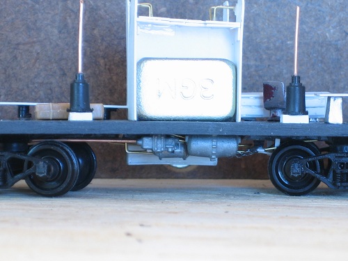

Time to add some weight... By the NMRA standards of 1oz + 1/2 oz per inch of car the cabins should weigh in at just over 3 oz.     At this time they come up at a smidgen over 2 oz. So I'll add a half oz to each side of the car behind the two bunks.     For one car I folded some sheet lead and glued them in place with some CA. As for the other car I used some of the balancing weights that you get when you buy a celling fan. I removed the adhesive tape from the and glued the together with some more CA.

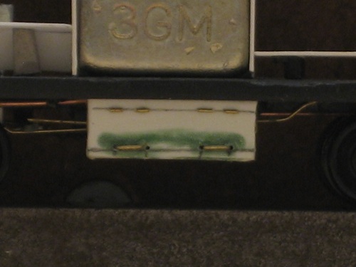

While the CA set up I added the details to the tool boxes. I bent some grabs From some .016 brass wire and installed as per the prototype pics. I used the same wire to make the hinges also.

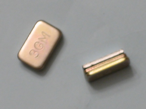

Ocalicreek I work as an electrician ,my shop does a fair amount of residential work so I come across the celling fan balancing weights quiet often. The circuit breaker knockouts from breaker panels work well in rolling stock that is closed in like box cars , refers, and the such.

e-paw Wrote:The circuit breaker knockouts from breaker panels work well in rolling stock that is closed in like box cars , refers, and the such.
Icon_lol never throw anything away!! Icon_lol

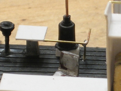

Last night I put in a little more work. At this point the two cabins will start to take on slightly different appearances. # 580 fallows LNE's normal practices looking like all the others in it's class. # 582 Is the anomaly in the group. 580 has two stacks and a vent in the corner, while 582 only has one stack and no vent.
I added a second stove in line with the new stack to the interior of 580 .
You can see the standard roof configuration here.     Note the difference in height of the two stacks, It's hard to see here but the one in the background is shorter. That's not a mistake, It's what I've noticed in the prototype photos and can't find a reason for this. I still will need to add the rain deflectors to the top of the stacks as they are of a different type from 582.

"Note the difference in height of the two stacks, It's hard to see here but the one in the background is shorter. That's not a mistake, It's what I've noticed in the prototype photos and can't find a reason for this. I still will need to add the rain deflectors to the top of the stacks as they are of a different type from 582."
Just a thought......I've had an understanding that wherever possible, the caboose was coupled up with the stove stack "behind" the cupola ( keeps the smoke out of the caboose )......therefore, the taller stack of the two would be the one to the "front", so the exhaust would carry above the cupola..... not necessarily fact, just "logic". :|

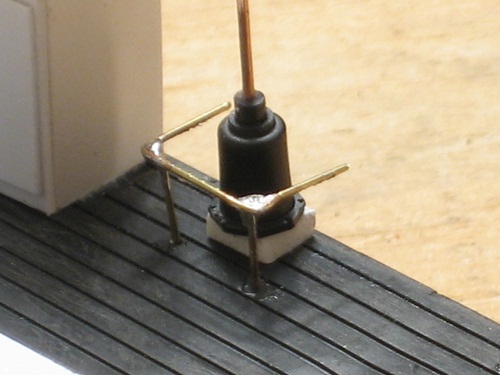

I added the safety rail around the stoves. Two of them got rails like this.     Where as #580 got an extra rail like this.     I also started on the end details. Here you see the ladders in place.
