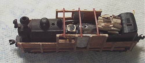

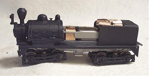

Here we do a test fit of boiler to running board.

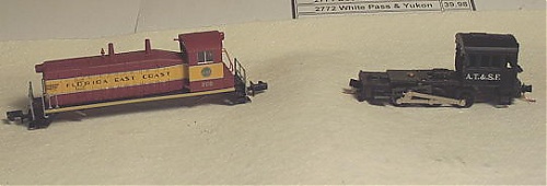

Here "No Fingers" sees if what we have so far will still run (thankfully it does).

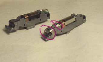

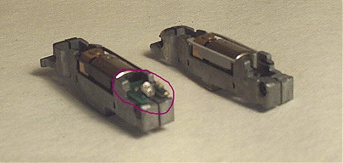

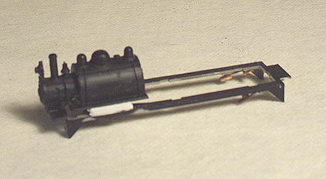

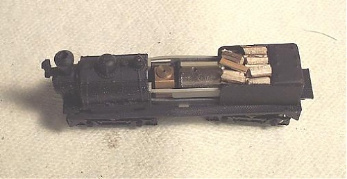

The circled areas show were lead was filed off the back off the chassis, which will be the front of the Climax.
On the other end the only mod so far is removal of the printed circuit board.

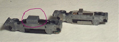

As much as I hated to lose all that weight, the underside of the Climax is fairly open and airy. With only the smallish gearbox and driveshafts able to be seen so the big hunk of lead that the sand/fuel tanks fit over has been downsized a bunch.

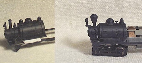

Here is the boiler mods that I've done. Comments are always welcome.
1- Removed the section that had the bell on it. This was done mainly to help shorten the loco. The bell will be remounted on the roof as was the more common practice.
2- Added the balloon stack
3-Moved the headlight out over the front of the smokebox as was again the more common practice
4- Removed the dome that was to the right of the bell and the lines going to it, most pictures I have don't show one there.
I hope this helps to hide the 0-6-0 heritage some and give it more of a Climax look.

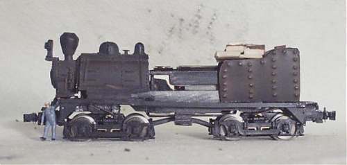

Here is a side view of my 1st attemp at a water tank w/firewood.
A top view. Duh, forgot the hatch so you could put the water in! :o One more thing on the to do lis

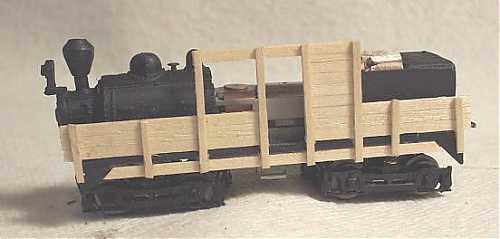

My 1st thoughts on a car body side. I would still want to close in the window opening some, also need to build a door. Comments anyone?????
Thanks Pete! Shamus you are correct in that many didn't have doors, but I need something to keep the motor from being seen. May try the cloth hanging in the door like I've seen in some photos, what do you think?
How about painting the motor area black.Then put a standing crewmember in the doorway on each side.

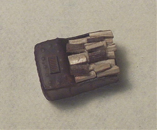

Well here is the final (I hope ) version of the water tank. I sloped the sides some from the top of the tank down to the firewood, did (again I hope Icon_lol ) a better job on the rivets and added a hatch so water could actually be put it the tank! Goldth
Top view

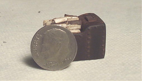

For a sense of actual size
Quote:sure looks great, those pieces of fire wood looks amazingly real, how did you do?, both the wood and the tank, what is it made of?
Jesper
Jesper the firewood is real. It's a dead twig off a maple tree that was cut to length and then the peices were split with a single edge razor blade. The tank is made out of styrene, the pointed end of a mini-file was used to "punch" the rivets from the back side. The water hatch is half a window shutter off a cheapo model power house. The weathering was done with pastel chalks. Hope this helps you! :mrgreen:

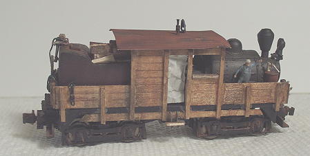

Well this is what is finished so far. I have added the driveshafts (bend-a-rod) and the couplers. Also learned Curse don't waste my time building car sides until AFTER the couplers are on cause the sides will be too short otherwise!

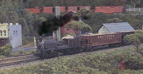

With a bunch of fake puter smoke we see "No Fingers" going for a test run. She took 6 cars and a caboose up a 4% grade while going thru a compound curve, 12 cars no problem on a 2% grade and thru a curve . I'm satisfied with the performance needless to say!
Thanks guys! O.K. David, I'll bite. You don't have the space??? Man it's only 3" x1/2"x3/4" Goldth

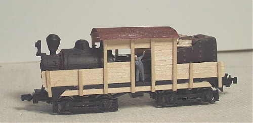

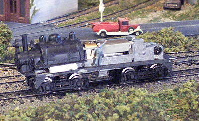

Well here is a stuck together mock-up? The sides would still have to be painted/weathered as would the roof. Still need to make the wood ends for the front and back, weather the trucks and add details like foot boards etc. While I haven't seen any with front windows and only a few with rear windows, side windows were fairly common. Also thinking about cloth curtains for the doorways, while trying to see if it is truly starting to look like a Climax. Comments????????????????
Now my question is does that look like cloth or canvas hanging in the doorway?

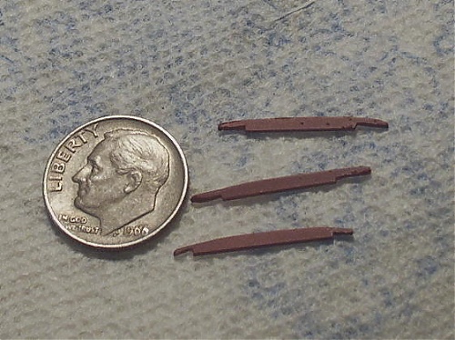

Roof braces
What I hope will work for the step
And the braces in place

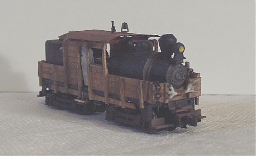

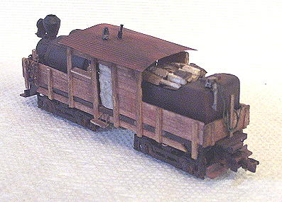

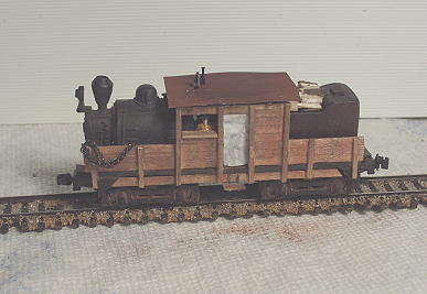

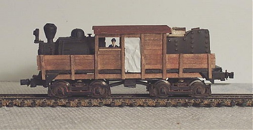

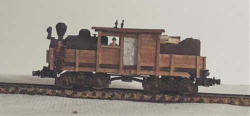

Here is one with the step, roof, bell and whistle installed. Put a chain on the front boards for effect , also dirtied up the canvas and hired a good ol' boy who don't wear no coat or tie I also filed off the rivets off on the water tank, just couldn't make em' small enough
Well 1 step forward, 2 steps back . :cry: :o :cry: Got to looking and the right side of the body was leaning in slightly so I removed the roof and side. Reglued the side on straight only to find the roof was now to narrow. :cry: :o :cry: ! So I now have made a new roof and reattached it. Maybe after going backwards today I will be able to go forwards tomorrow??? :?

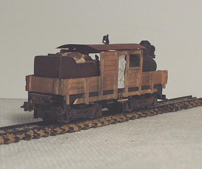

ell I think the back-end is done. Most pictures I have show angle iron for foot plates so that is what I did here. With black on black the front one shows up better :o . Now to work on the front-end .

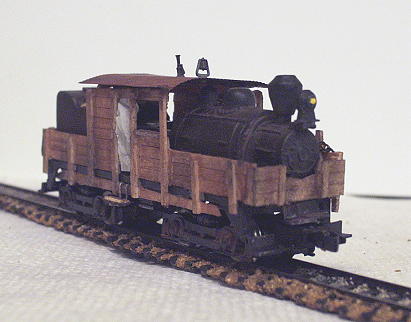

O.K. here's some pics of the front.
The headlight is just painted in for now, I know Icon_lol I got a jewel type marker here somewhere and when I find it...............................................
And a profile so you can see the driveshafts, chain etc.

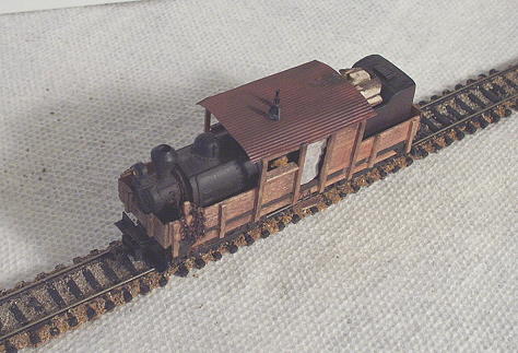

No, the train wasn't climbing a 5% grade in that last pic, I just forgot to level the camera :? Misngth Icon_lol . At this point I pretty much consider this done, however if you can think of any additional details or whatever please let me know. As far as lettering and numbering goes, the vast majority of the pics I have don't show any. I think this is due in part to the fact that a lot of companIEs that owned Climax's only had 1 so no need for numbers, as far as no names I don't know the reason, any guess' ???? Maybe finances played a part in it. I still haven't decided what I'm going to do
Casey Feedwater suggested a water pump and hose was in order to put out the fires the loco would start. So here is what I came up with, it's the little thing on the top back of the water tank.
One from behind

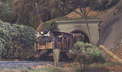

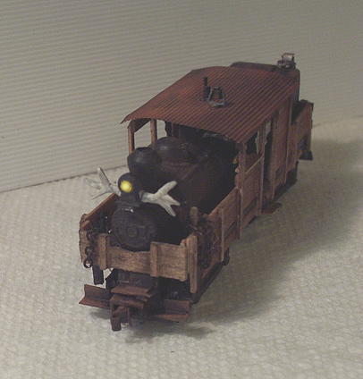

Well I found some suitable antlers and now everyone can have a chuckle on me. After amutating them and splicing, painting, weathering and mounting em' on the roof, I set back with a cold one to watch her run around the layout! You guessed it! everything was fine until the first tunnel portal :cry: Sad Icon_lol :o :cry: Wink , sigh , back to the workbench for repairs and remounting. Here they are in the new location.
And her she is AFTER safely exiting a tunnel Goldth
O.K. this is where I am at with my "horny" little problem Wink Goldth . All the pics I have seen not many locos had antlers on em' Eek Icon_lol . The ones that did were on the roof, the head light or on the front boards where I now have em'. I made em smaller, shaped em' some etc. Please be honest, should I keep em'?, get rid of em'? keep em' but make changes (if so what changes)????

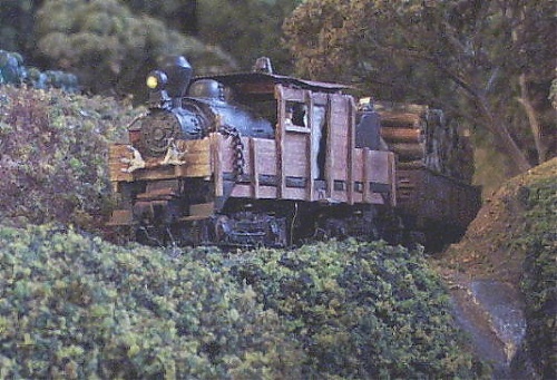

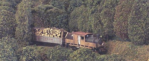

A shot of her pounding upgrade on the Tellico Gap loop.
Thanks guys! :mrgreen: Tad all my pulpwood eoads are hardwood twigs cut to size. Most are Maple and Hickory, some Oak.
