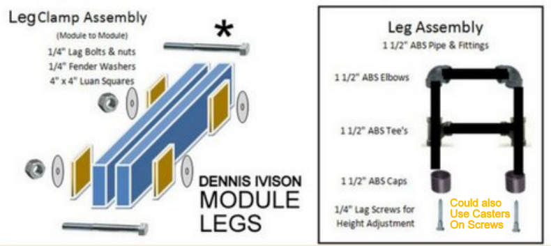

Here's a module system developed by Dennis Ivison from Garden Grove CA. It uses 2" Styrofoam only for the modules & PVC pipe for the legs. He built his home layout using these modules for his fictional narrow gauge On30 South Pacific Coast RR. His are all 30" by 72" to hold up a lot of scenery & structures. The foam was glued together using "Liquid Nails for Paneling & Molding Adhesive". But if you chose this system the modules could be whatever size works for you. The modules are very strong but are also very light compared to wood or steel frame & plywood ones.
Andy Jackson
Santa Fe Springs CA
ATSF/LAJ Ry Fan & Modeler
Andy,
Thanks for adding that. I have a friend who built his home layout in a similar fashion, using just the foam and steel studs.
If your modules are going to be transported to a club or display, the wood frame protects the foam, and the modules are actually boxes together in pairs so the "good sides" face inwards.
To lighten my design further, the 1/4" ply could be replaced with the 1/8" door skin or luan, and it could also be used for the sides. By gluing the foam to the support panel, it becomes incredibly strong.
