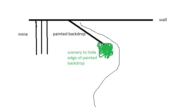

A mirror could be used directly behind the 3 tracks to the mine loadout and a short painted backdrop attached to the wall hiding the "portal" Paint it like a mountain and taper it down to nothing. Look up mirror usage , especially John Allen, who was a master. There is a lot of information to be had and you have a good place to use a mirror illusion.
I am not an artist but I hope this will help you see what I mean.

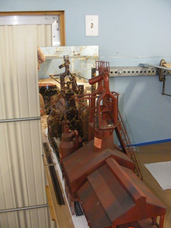

I'm going to have to review that info on the use of mirrors when I try using one to make my steel mill blast furnace look larger,...or rather duplicated
Please excuse that 'decorative mirror', it was a piece of tile mirror I had laying around for experimentation.
Posts: 10,617
Threads: 244
(07-29-2019, 08:35 AM)railandsail Wrote: Mirror Images
You certainly understood what I was saying in a hurry. John Allen was a master with mirrors. The mirrors will certainly increase the mine tracks and the only thing reversed will be the small marks on the end cars.

http://cs.trains.com/mrr/f/88/t/145241.aspx and he also did a building that had burnt with the smoke painted on a mirror in the proper location. Not being an artist I am attaching this very crude drawing to try to explain a little better about the backdrop. It is so crude it could be used to illustrate the word in the dictionary.
