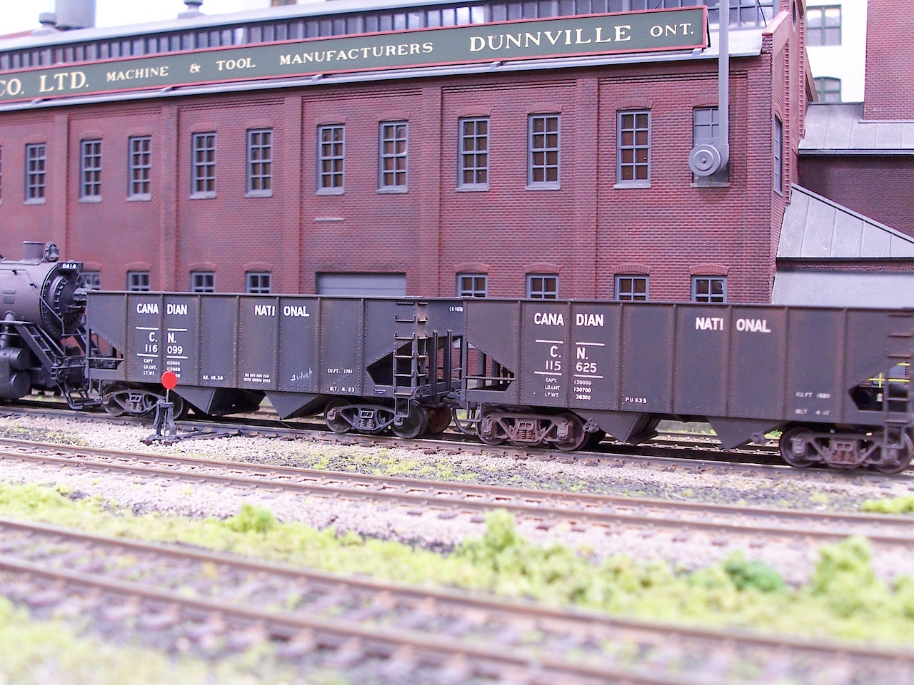

A couple of Accurail cars with C-D-S lettering...
...and a couple of Accurail boxcars with factory lettering...
...and another Accurail car with lettering from C-D-S...
Every once in a while I'll grab a couple of random cars and add some weathering to them.  I do find the airbrush-applied weathering more controllable, though.
