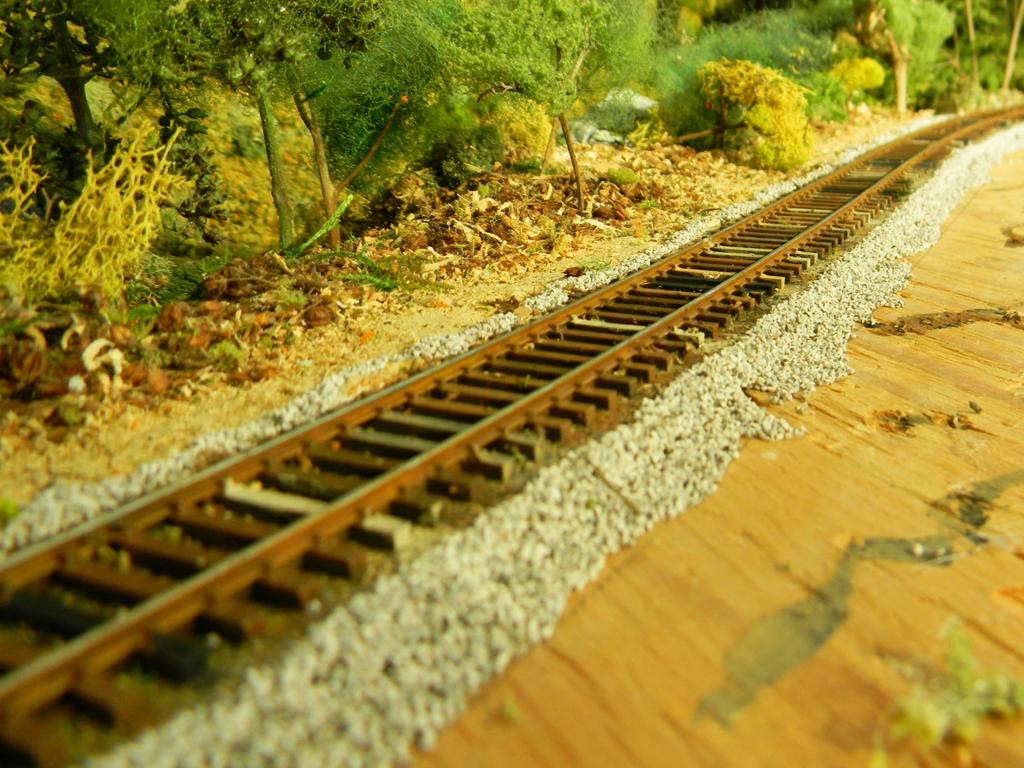

Here's a shot of the "edge ballast" after a night for the glue to set up and the vacuum to be employed.  Just makes it a lot easier to dress the ties after you do this step.  I've been able to spend some time doing the final ballasting on about 10 feet of track.  Unfortunately, I'm going to get decent at it and then I'll never have to ballast another piece of track!

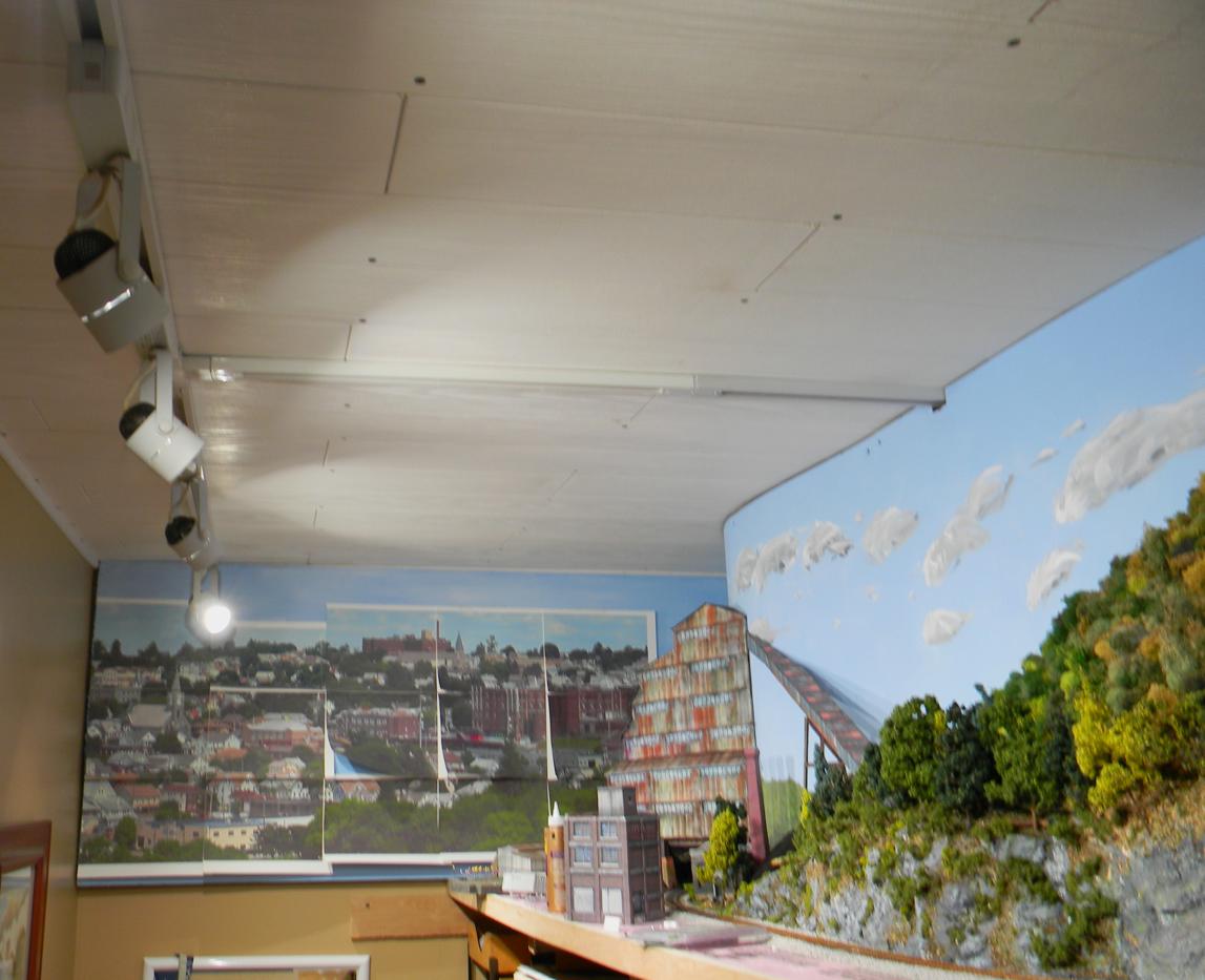

I'd purchased a short (2-ft) add-on for my track lighting to increase the distance between the lights and the layout on the Hazleton section of the layout and picked it up the night before leaving for the long weekend.
Track lighting might not be the best light source for simulating natural light, but I like the flexibility that it gives me.  Here's the before:

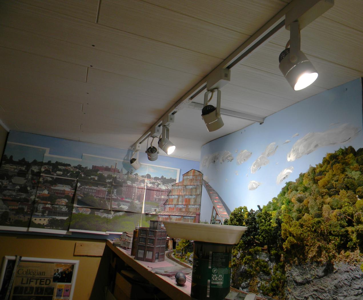

and the after:
Still working on finishing ballast, but we're real close to being complete on that mission, at which time I'll start working seriously on the city backdrop for Hazleton.

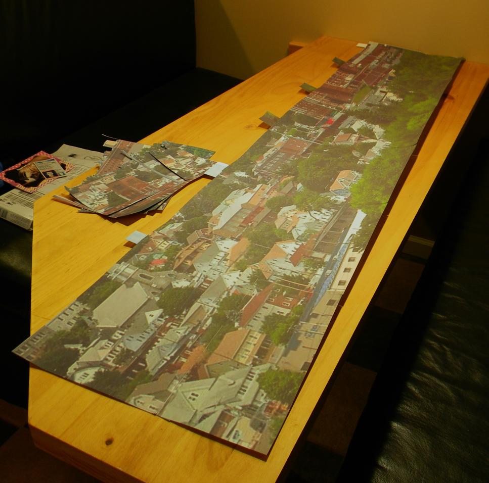

Back to the backdrop for the city of Hazleton.  After printing and cutting, I started joining the bottom two layers of cardstock using Elmer's Stick Glue, gluing to a strip of cardstock between individual panes (you can see the top of the strips jutting out of the top of the joined panes).  I cut out along the edge of the sky on the top layer (that's the stack above the joined section in the photo below), and I'll join that layer to the others tomorrow.  I'll further refine the gaps between individual panes of the picture. Then comes the posterboard backing before placing it permanently on the backdrop.

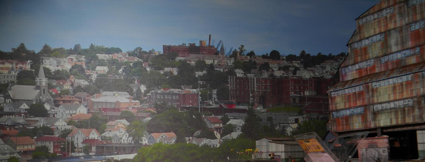

Finished the joins and installed the posterboard backing - toughest part was cutting the posterboard to an equivalent horizon line to match the cut cardstock on the top layer.  I got some thick posterboard we use for tire prints at work and the stuff is thick.  Laid it against the backdrop for the time being to get it off of my bar table.  I still need to work a little on the seams and do a little more touchup on the gluing before I mount it permanently to the backdrop (homasote), which will eliminate all of the shadows at the top.

The background looks great. Really gives depth to the scene.
RE: Rainbows in the Lehigh Valley Gorge - Amalynn - 02-22-2024
That backdrop looks phenomenal and the improvements to the layout lighting look much better.

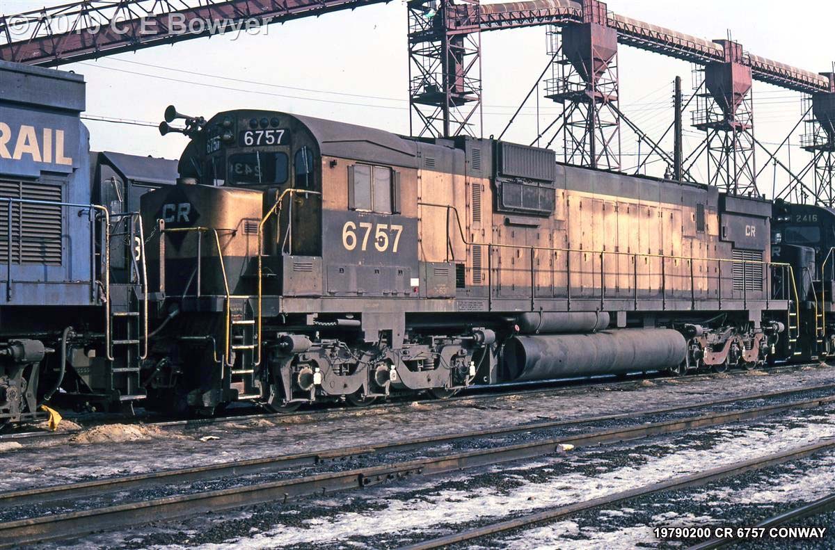

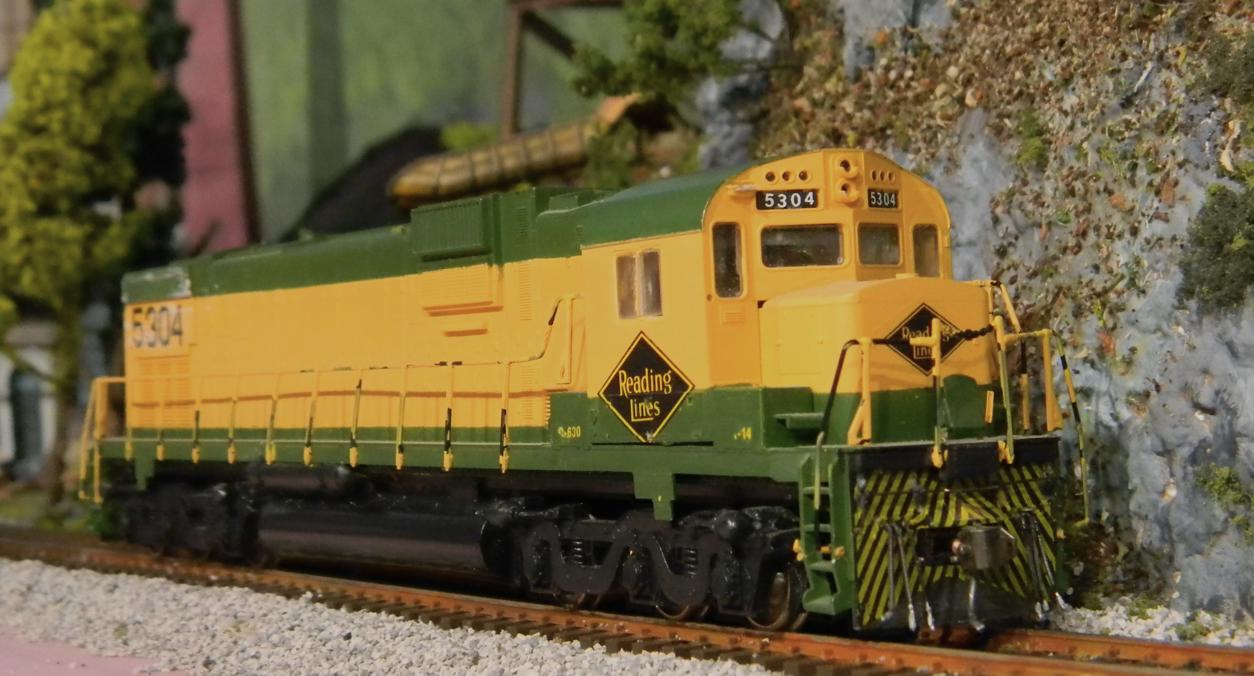

I've had plans to patch out a Reading C630 with CR stencils and an appropriate Conrail road number.  Here's the Stewart Hobbies Reading #5304 which I picked up (at least) second hand a few years ago.
Added a decoder previously, but really haven't addressed some missing parts and non-prototypical details I thought I could do something about.  What I really want to produce is something like the locomotive in this link:
CR 6757 Dayton, OH 05-3-1978 | Conrail Photo Archive (thecrhs.org)
So, black patches over the diamonds, a new set of road numbers, "CR" stencils.  I also want to try to add the Reading "rain gutters" on top of the roof above the windows (if I can find a good way to do that), add a set of horns in the right side of the roof, and I'll have to purchase a new set of railings to get the missing short corner piece on the front of the cab, and I need to get the air tanks installed so they won't fall out, and then a ton of weathering.
As I get a little time I'll be pecking away at this project and I'll try to post sporadically.  Stuff like this is going to be my limit until I hit the summer months.

Todd, I managed to get one picture of that unit. I don't have any thing else but at least this is one side
