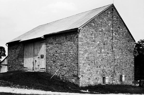

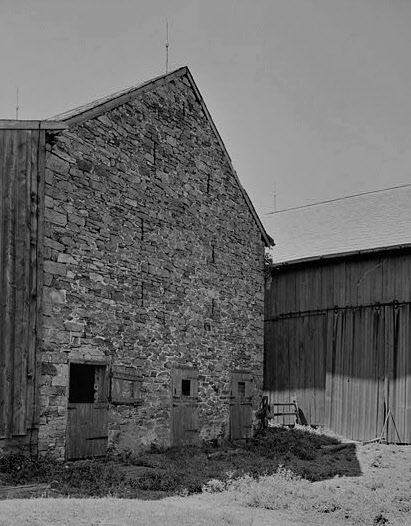

Re: A Stone Barn Scratchbuild - jim currie - 05-31-2010
Matt here are some more barn shots.sorry for the poor quality but being on dial up Wallbang you know why.
you will note that the ends of these have vent slots built into them. and some are wood and stone.
jim

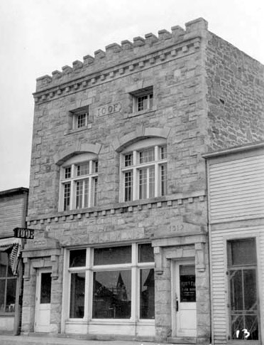

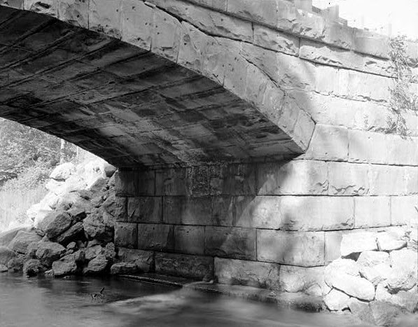

here are other stone shots.the first two have cut stone fronts the first is a lodge , the second is the Central City Opera House that as far as i know is still being used today.the other are how a arch bridge is laid.
jim
