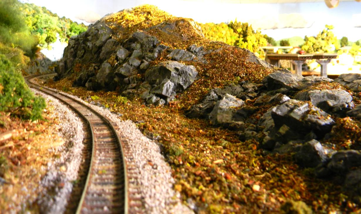

Making some additional headway into the tricky portion of this project, a lot of it done with mirrors to see what I'm doing as I suspend myself over the mountaintop to add glue into crevices and near the track to apply the brown and green stuff.  The first layer went down with nothing more than a coat of straight wood glue followed by the vaccum and then dressed again to get the coating I liked.  Followed that up with a dribble of alcohol with a syringe and then a 50/50 mix of white glue and water (just like you'd do track ballast) over the new added material.  When the green and brown stuff dries, I might add some areas of static grass on top as an experiment.  They come shrubs, and finally trees. Here's a shot from the bridge end of the project.
RE: Rainbows in the Lehigh Valley Gorge - tompm - 06-29-2025
Looking good. It is coming along nicely.
RE: Rainbows in the Lehigh Valley Gorge - ngauger - 06-30-2025
Looks great so far!!!

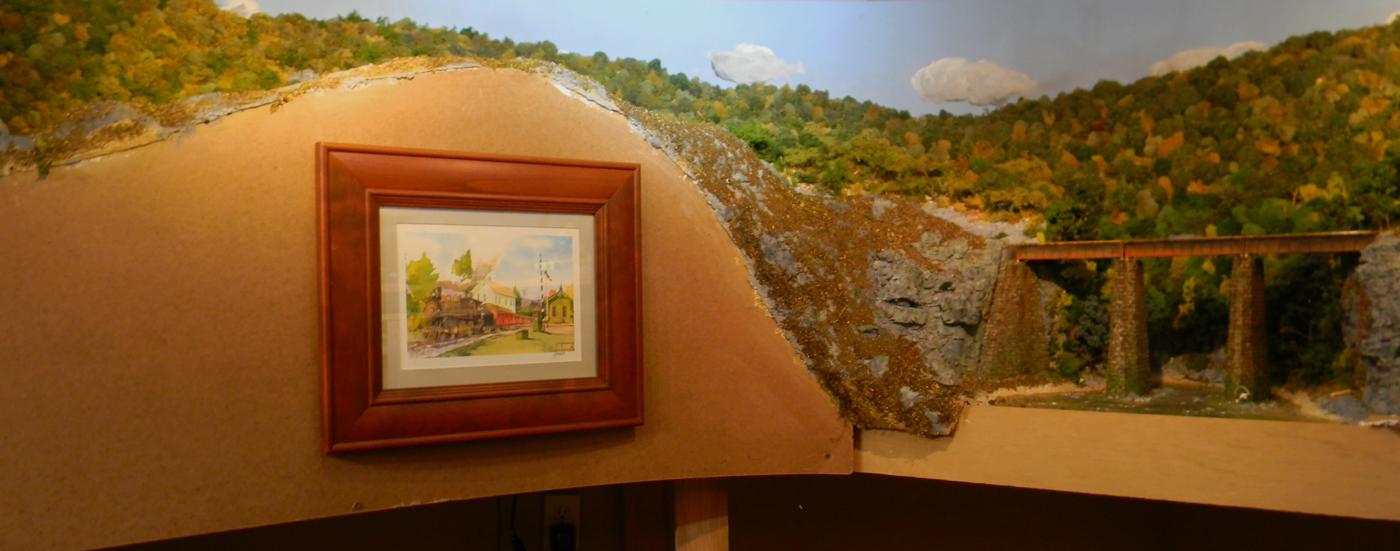

The big flat piece of Masonite that I installed as a support for the mountains I'm currently working on was bringing me down a bit.  I'd turn around from my desk and see a big brown slab of nothing.  I inherited a couple of watercolors when my Mom moved from her farmhouse in Reeders down to Northhampton, PA.  She just didn't have room for all of the paintings in her new place.  These were painted by one of my favorite teachers in middle school, John James.  Immensely talented - I could watch him draw, sketch and paint all day.  His niche was a combination of watercolors and markers, and at the end of the year if there was a teacher in the middle or high schools that was retiring, he'd make a collage to present to them - the stuff was magic.
Anyway, the two watercolors I inherited were on the wall here in the office, but I thought maybe one of them could be mounted on the Masonite.
Immediate improvement, and the subject matter is tied in a way to my model railroad.  The Erie Lackawanna mainline used to run from Scranton through Monroe County down to Delaware Water Gap.  Before it was the EL, the Delaware, Lackawanna and Western (Lackawanna) ran through Cresco, PA - and I believe Mr. James got hold of an old black and white taken before 1930 as the basis for this painting - a 4-4-0 powered passenger train headed up the mountain out of the Cresco station.  This station (I believe) still stands and I used to pass it a lot on trips up to see my aunt and uncle in Mountainhome, which I believe at one time was also a stop on that same line.  I believe that a portion of that line (from Mount Pocono through to Scranton) is still in use by the Delaware and Lackawanna Railroad, which also helps service Steamtown excursion trains.

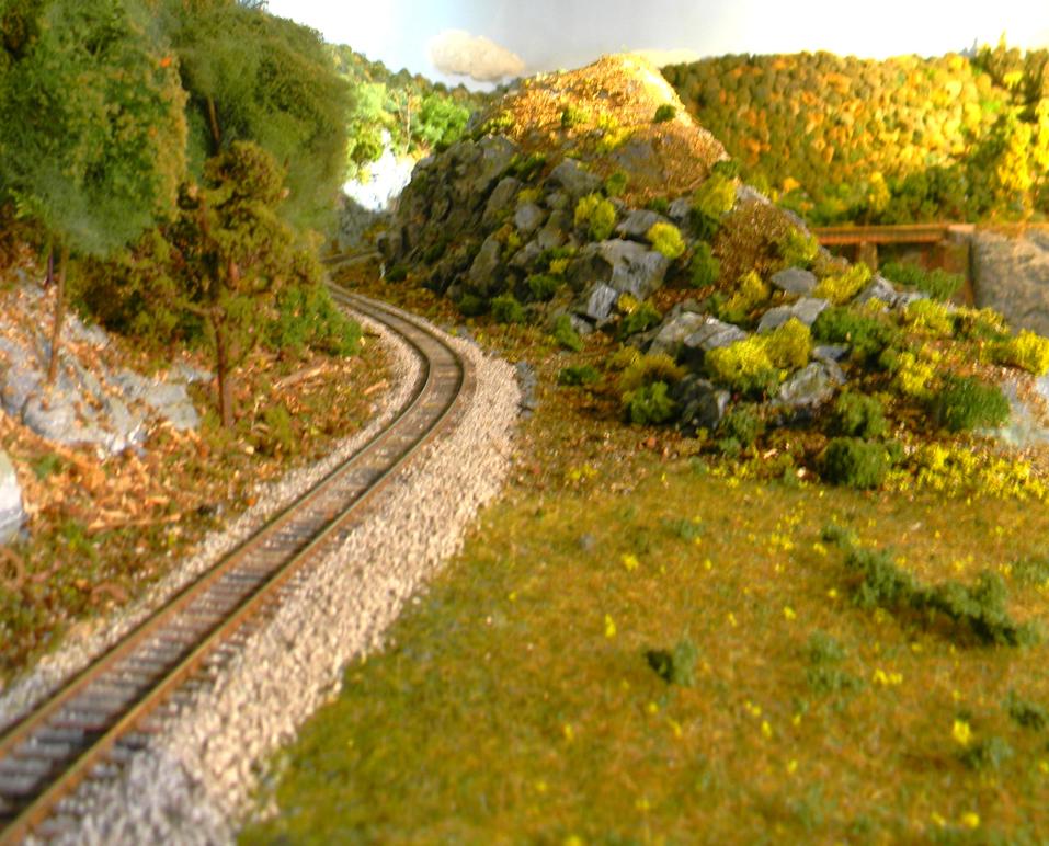

Detail painting done, ground cover of brown and green stuff done.  Now on to adding some shubberies....  (Hopefully, I will not encounter anything like this... The Knights Who Say "Ni!" - Monty Python and the Holy Grail)

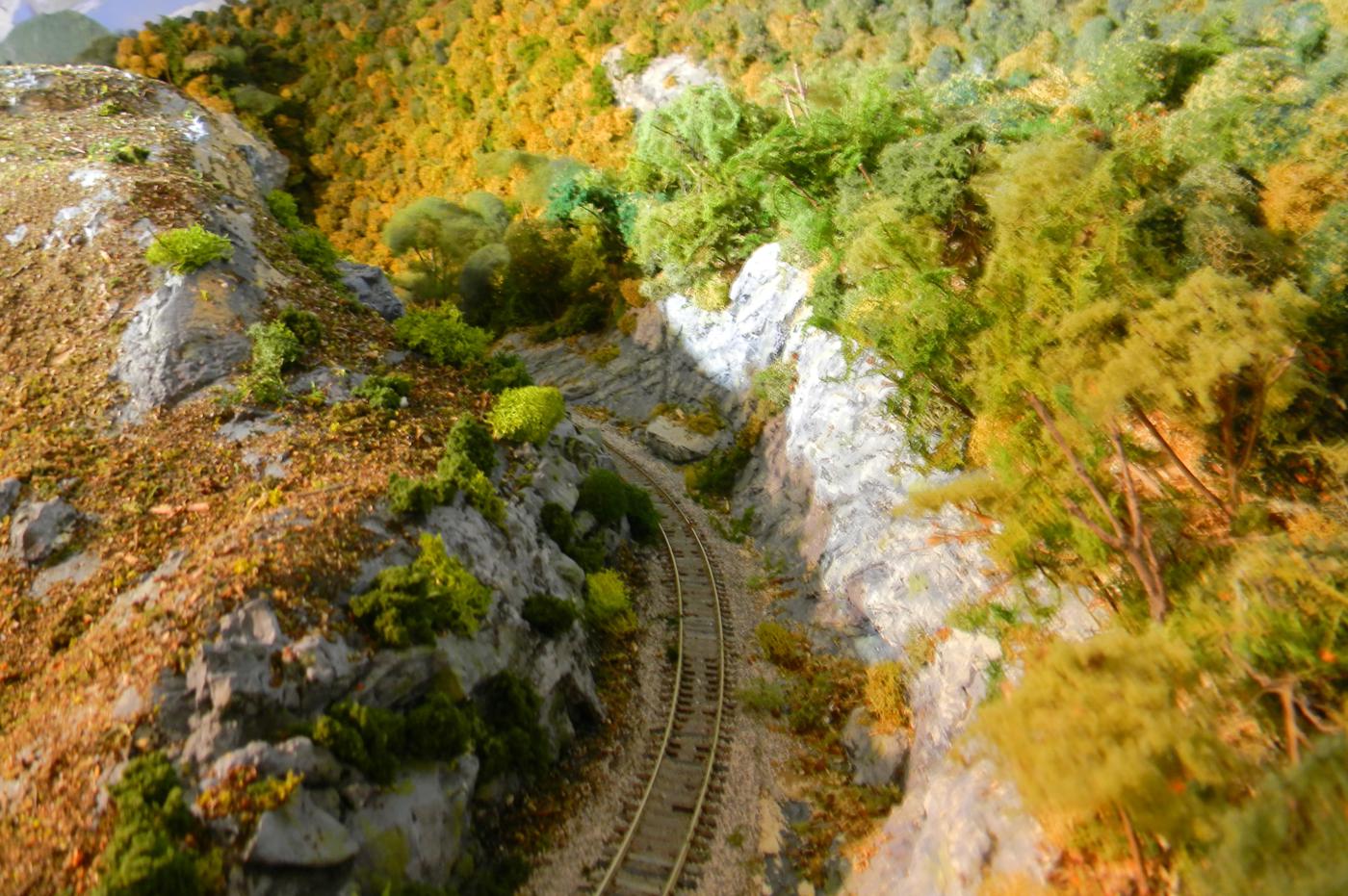

Made it all the way to the bridge planting shubberies upside down with a mirror.  Nice parlor trick, but I'm glad that's mostly over.  I'll run some trains through there to aid in identifying potential snags (you can see one glaring example in the photo on the inside of the track).  Due to the nature of the effort, I think I'm going to go right to trees in the same space to avoid having to reach over shrubbery on the top of the hill and plant those as well while there's less stuff to interfere with.
