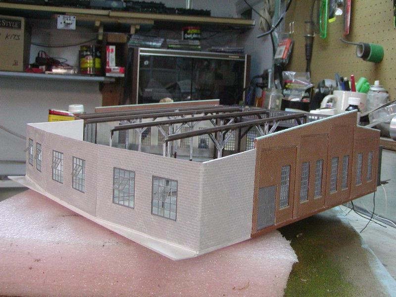

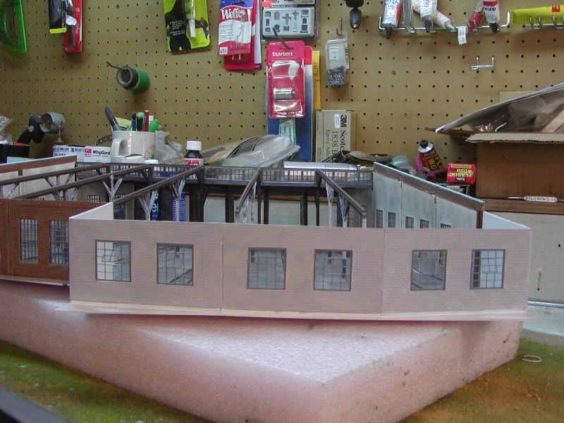

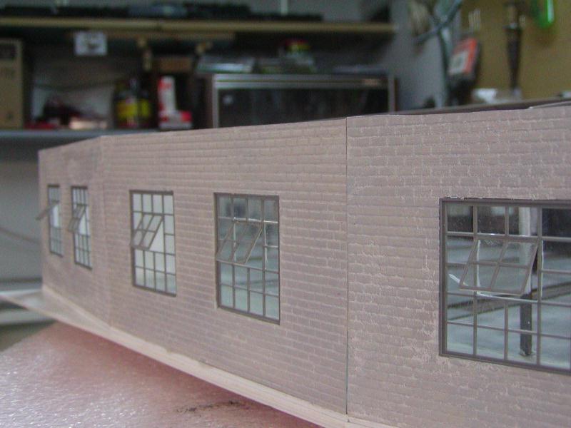

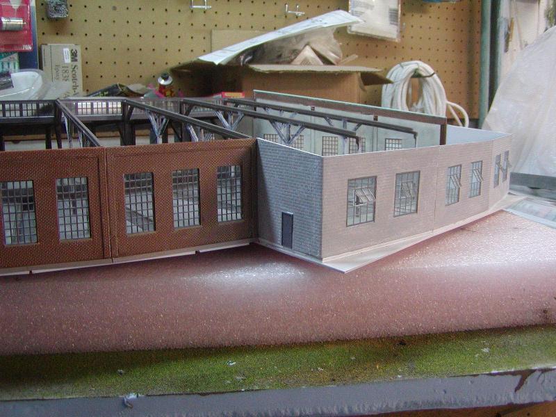

Re: An engine servicing facility for the JGL - tetters - 02-05-2009 That is nice big round house. Would some ivy crawling up the wall be an appropriate suggesting for covering up the seam as well in this case? Just something I thought of when looking at it to give the structure as sense of time like ivy growing up the side of a wall. :?: Re: An engine servicing facility for the JGL - MasonJar - 02-05-2009 Believe it or not, some brickwork looked like that - with the gaps. I can't recall seeing cinderblock used in such a way, but there are definitely examples of standard brick joints being made like that. Especially where the house or building in question is a double, triple or quad-brick wall. I'll see if I can find some pictures. (Very) quick google did not turn up anything. Edited for clarification... Andrew Re: An engine servicing facility for the JGL - Bob C - 02-05-2009 Gary, the walls look fine, and the idea of covering the troublesome joints with a column of blocks (or concrete) is a fine solution. I think these features are called "pilasters", and they stiffen/strengthen the support for the roof trusses - there are similar brick pilasters on the "kit" walls, (but the joints fall in the middle of them, making them less obvious as a solution to the joint cammoflage on the extension). Just score the mortar lines into the edges and align them with the wall mortar joints...outta come out fine. Bob C. Re: An engine servicing facility for the JGL - doctorwayne - 02-05-2009 Gary, if you do decide to go with the downspout solution, I, just today, found some nice ones by Micro Engineering. There are six 35' lengths of eavestrough, and six 23' long downspouts in a package, moulded in light grey styrene. The part number is 80-163. While I don't have any immediate need for these, I bought a pack anyway, and will save them for a rainy day. Wayne Re: An engine servicing facility for the JGL - Steamtrains - 02-05-2009 Hmmm...Could'a sworn I posted a reply here a few minutes ago...But no see...It went something like this... Doc...Good one...!!! Gary...I've been following this thread closely as I'll be building one, a little more "rustic" (board & batten construction) in the coming months. I like that interior..!!! Any chance of making the roof removable so folks can peek inside & see all that great work..?? Re: An engine servicing facility for the JGL - Trucklover - 02-05-2009 Man you are doing a fantastic job on this thing!! I love the open windows, thats a great detail!! Re: An engine servicing facility for the JGL - jglfan - 02-06-2009 Thanks for all the encouraging replies. I have not as yet decided on a pillaster or downspouts. I know brick structures use pillasters but I am not sure about cinder block, hence my hesitation. For now I am working on extending the roofs, and some basic detailing for the interior, which I do not think I will light, but am still not sure! What I m thinking is to get the structure in place on the layout with the roofs, at leadt on the extended stalls, not in place, but ready to glue in place. Leaving them not glued in doesn't seem to be a viable option, as when the structure is slightly bumped, they tend to fall. But with the structure in place and the roof panels sitting on top I will see what the view thru the rear windows is like. I'm going to put a line of lockers on one of the extended side walls, the one with the angle most favoring viewing. The other extended side wall has a door in the center, and I have an air compressor casting I will place to the side of the door. That's going to be the extent of interior detailing I think. If I can add lights thet will accent loco fronts and these up close details, I may do so. Here are a few pics, the kit roof with the roof extension next to it (the kit roof is 60 thousanths so is easy to match up) I realized that if I left the roof like this, the exhaust stacks would no longer be over the loco front. So I cut up the roof sections as shown in the next pic. Last pic is one locker I made up, only raised detail is the strip around the edges. The louvers and handle are just painted on, and none to well. However I am sure it will look ok thru the windows, if they are even visable! |
