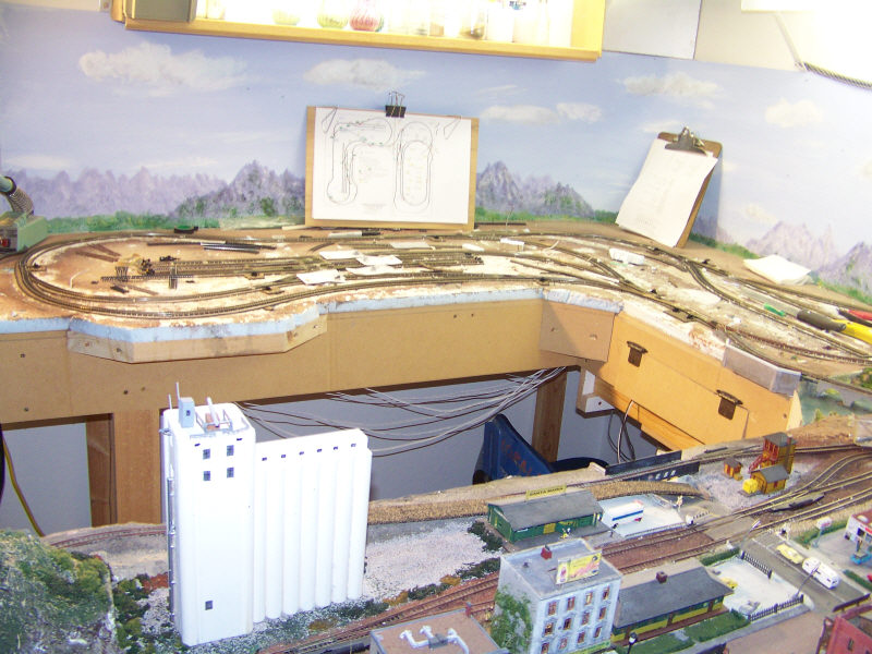

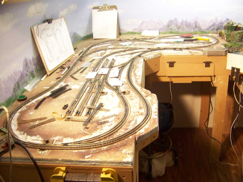

Well, I was thinking a bit about my own situation when I decided to start this challenge. I won't say that I'm a procrastinator, but it's been longer than I hate to admit that I started redoing about one-half of my layout. I wasn't happy with two attempts and so I stripped it back down to the foam for the third time and started fresh. I'm not sure if it was complacency, laziness or just burn-out, but in the past two years, I've done little on it. Yeah, I can probably look to a few health issues that kept me distracted and usually too tired to do much of anything, but then I need to rise above this and so this challenge is the incentive that should get things going once again.
As you can see by the pictures, the trackwork is in, but not ready to run anything just yet. I've got some basic work yet to do, nothing fancy, but at a minimum, I need to get my trackwork completed so I can start on my scenery. My resolution is to finish the trackwork up to and including ballasting. That will include installing all the ground throws, complete soldering the joints and wiring the track for DC (with the option of going DCC). The wiring you see underneath is old wiring that needs to be taken out. I will have the trackwork completely ballasted and be able to run trains between the two sections of my layout (a major step). I may even have time to do some work on my cityscape scenery, but that will be a bonus.

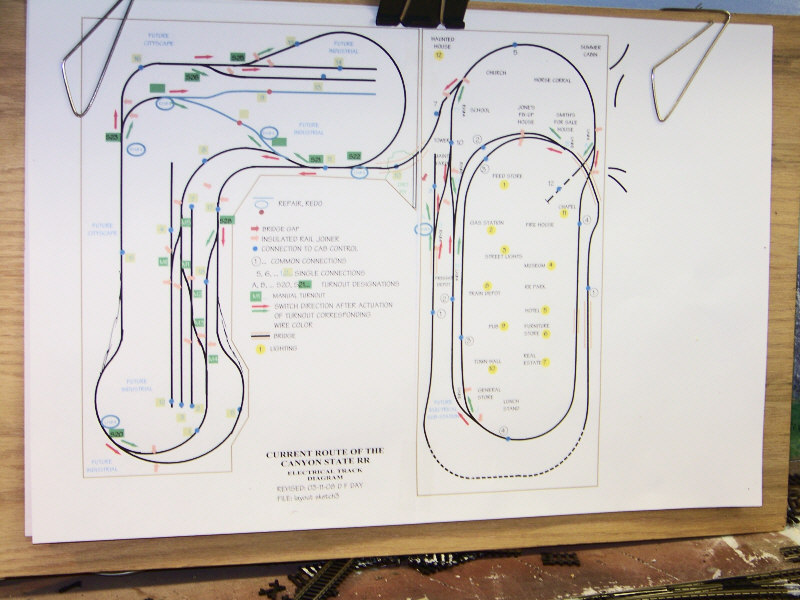

What surprised me more than anything is the date on my layout schematic, I drew that up over three years ago. :oops: They say, the older you get, the faster time goes by, and this is proof of that. :o It is the layout on the left side of the sheet that I need to work on.

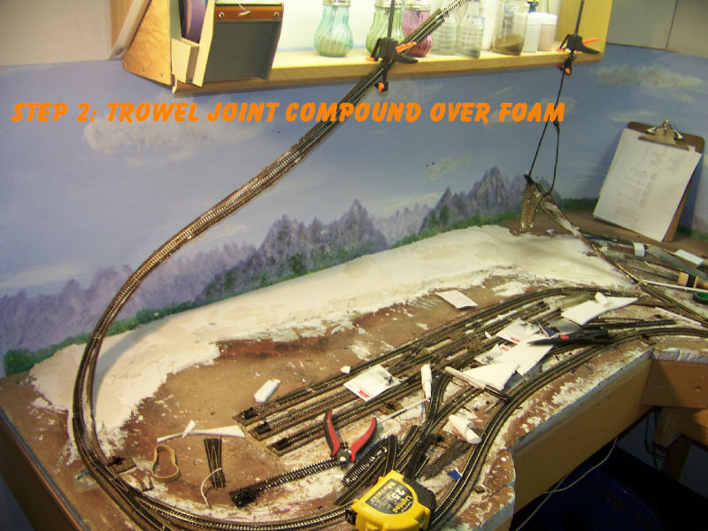

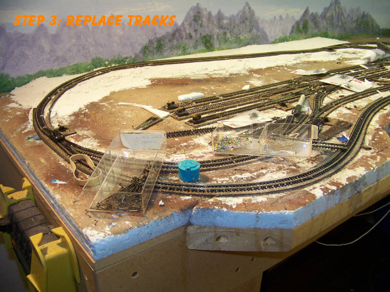

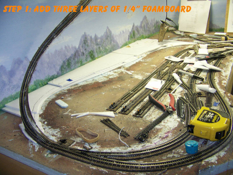

Got something completed that I didn't plan on. It looked like I had too much flat so I wanted to add a little riser without having to take and redo too much track. I decided to add about 4 1/2 foot of elevation to the back of the table. I was able to pull up the track and bed almost intact and added about 3/4" of foamboard. This gives me a rise of about 10' scale which should be easy to add scenery to. Remember, I'm working in N scale, that's why it's not higher. This also gives me grades of about 2.5%. The track went back together nicely without adding anything. I don't know what I can put up there yet, maybe the back end of a row of houses.
Anyway, here's a few shots I took, not very exciting, but they do show progress. Icon_lol Icon_lol
