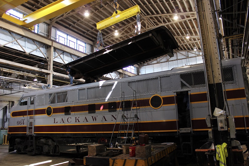

Today we removed the Fan/Radiator hatch off the roof of 664. There are some water leaks to repair, and the top deck needs to come off one side of the 567 prime mover to repair a leaky oil gasket.

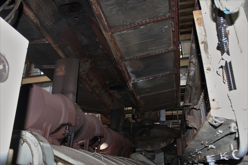

A few shots from the inside as the hatch was coming off.
And it's Off, This one gave us a lot less trouble than the SW-1. The last time this was off was 1986 when all the guts from a CF-7 were used to bring this unit back to life at the Reading shops.

The hatch will be placed on some wood blocking on the floor next to 664 for repairs. Those are the radiators under the roof section. The box in the back houses the controls for the fans. The front section holds the intakes where the air filters go, They then direct air into the blowers underneath them.
Not a view that most people get to see, so here it is A convertible F-3. The oil leak is coming from the section in the upper right part of the engine right under the cover with the handles on it. There are four of these on a 16 cylinder block like this.
