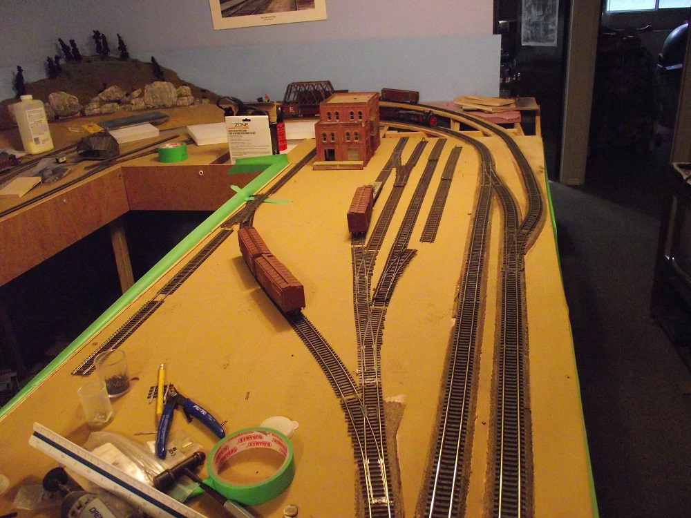

Thanks I Finished relaying the mainline and passing siding tracks.
I just have to rewire the feeders and I'm back in business. I also installed the wye to the yard and waterfront.
I sanded the cork down to transition  to the plywood using 60 grit sandpaper wrapped around a piece of wood.
After working all that I thought I would start to plan for the trackage in this area.
I managed to fit a 3-4 track yard with a run around, plus a waterfront siding on the other side of the large warehouse. I'm not sure if I'll use the warehouse as it it but the footprint will be the same.  I'd rather the loading dock be pointing in a different location to make it easier for truckers to back in.

I'm thinking of a different configuration for the yard/industrial area:
I moved the run-around track to the track that will go to the industrial/warehouse area so it would free up the two yard tracks and put the run around where it would serve the most good.
I hope that this will work better, I just need to figure out some track geometry. Hopefully I'll be able to have two 40' cars on the straight track with and engine able to run around on the other.
I also started to re-configure the warehouse structure. It's all made from DPM modular parts. I was able to take it apart along the glue seams with minimal damage so I can move the truck loading dock 90 degrees to where it will make more sense on the layout.
I should be able to easily reassemble the structure without much difficulty. This turned out to be a bit of a blessing in disguise as some of my joints were getting brittle and I can take this opportunity to reinforce the structure before it goes back on the layout.

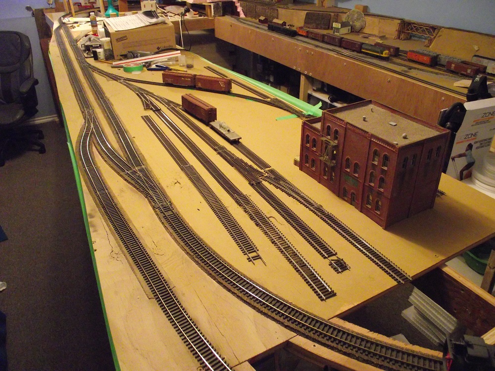

I started tracklaying. The yard and industrial sidings are code 83 and I'm using Atlas turnouts. I'm not using switch machines and staying manual for the turnouts. I won't have room for the Caboose Industries turnout throws that I have used in the past so I fabricated some turnout 'springs'
It provides enough 'push' to keep the painted in place when the turnout is thrown, much like the peco turnouts. Once painted, I'm hoping they will be a bit more invisible.
With the turnouts fixed, I tacked them into place, along with the 's' curved flextrack in the picture. In the background you can see the two turnouts for the run-around track in the yard.
The 's' curve might seem a bit tight, but I'm only running and engine and probably only two car through it at low speeds so it should be okay.
