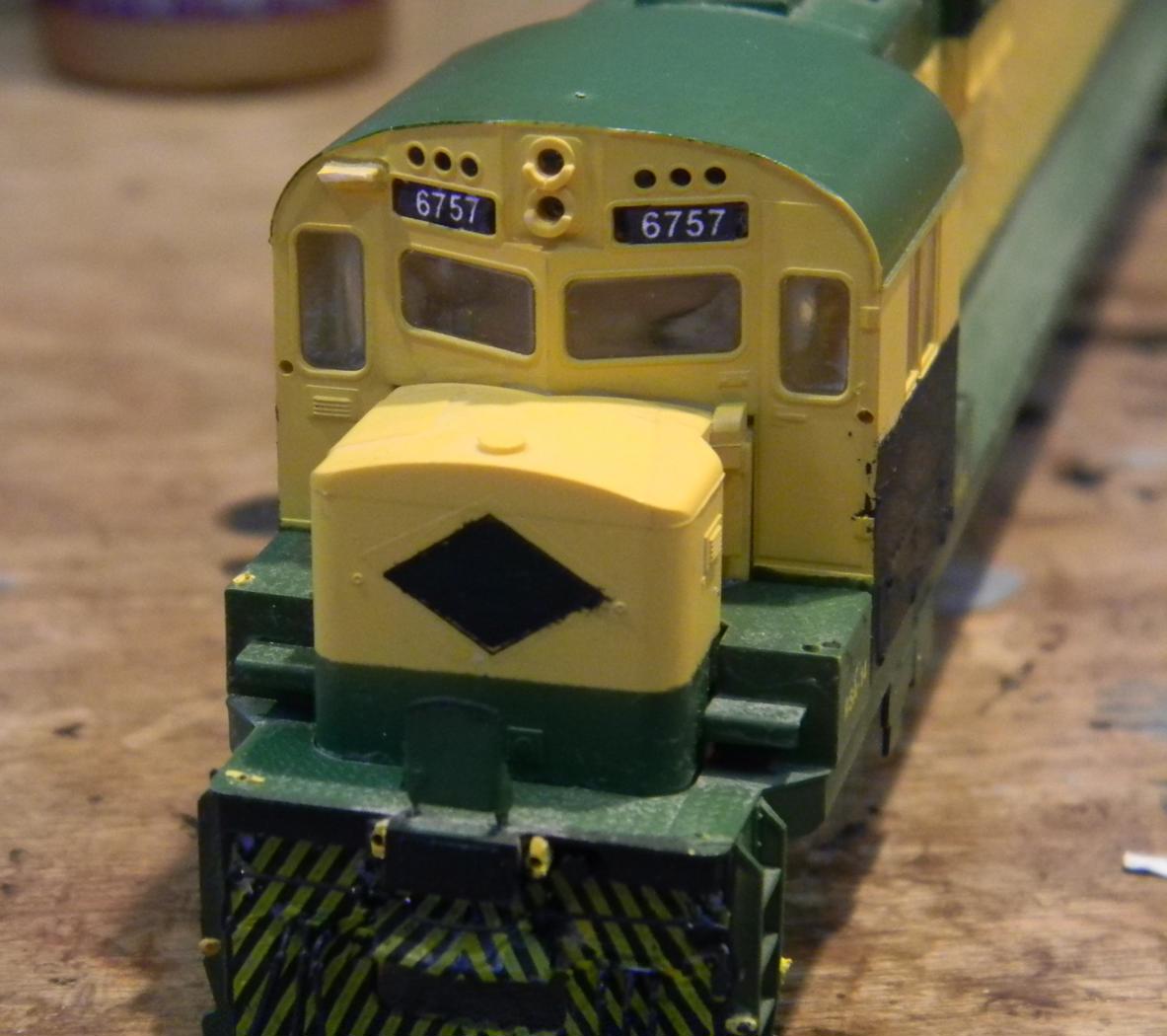

Until all of this material arrives for the locomotive, I thought I'd work on the patch out paint and road numbers.  I thought about adding (and then patching out) a "Bee Line" logo on the long hood, and then did a little research.  Turns out the Reading bought their C630's in two batches.  The first 7 locos were painted without the "Bee Line" logo, and (most importantly) were not shipped with Hi Ad trucks.  The second 5 had the Bee Line logo and the Hi Ad trucks.  My Stewart Hobbies C630 does not have Hi Ad trucks, just the standard C-C truck arrangement, so it's more appropriate to model mine as the earlier batch - which is probably why Stewart didn't represent this one with the Bee Line Logo.  I'm betting that Bowser probably has Hi Ad trucks as an option these days on their website, but I didn't think to look for them last night.
So, simple patchouts of the diamonds (front, rear and cab sides) and the large road number on the back of the long hoods as well as replacement of the numbers on the number boards are all that's going to be required.  It turns out (and Charlie probably already figured this out) that Conrail 6757 was once Reading 5304, and since (thanks to Charlie) I have photos from both sides of the locomotive in beautiful grime, it's fate - the road number for this locomotive is going to be 6757.

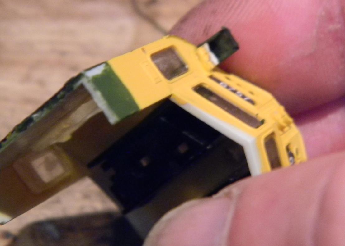

To get ready to paint the black patches, I first got out my blue painter's tape and masked off the areas of the locomotive I'll patch (I'll brush on the black paint and won't even attempt to achieve neat or complete coverage).  As a matter of fact, if I can get just a hint of the Reading logos leaking through, I think that'll be a plus.  Many of the CR patchouts looked like minimal efforts by the painting crews - probably sent out with a roller and some black paint on miserable days in the yards.

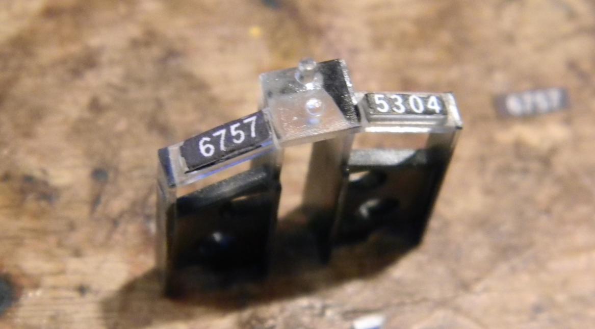

As the black patch-out paint was drying, I decided to attack the number boards.  I recently had great success generating these using my inkjet printer on top of CD-label stickers.  However, that was for white boards.  These are black with white letters.  However, I figured if I printed white letters on a black background using Microsof Powerpoint, printed them out, cut them to the same size as the boards and then glued them over the existing boards, that would look a heck of a lot nicer than me trying to do something like rub individual numbers from a dry transfer.  Although I've done that in the past, the numbers never have the right spacing and linear look.
To fit the Alco number boards, I used Arial 6-pt as my font, cut them to size and glued them on with Aleene's tacky glue.
Hypothetically, the Stewart number boards can get pushed out of the headlight holes, but that's only IF the previous owner hasn't put a little superglue on the assemblies.  My front headlight assembly came out just fine, but in the rear I ended up breaking off the number boards from the clear headlight assembly.  They didn't shatter or chip, so I was able to reinstall them with some patience and a small screwdriver.  Popped the front board back in the model, and here we are:

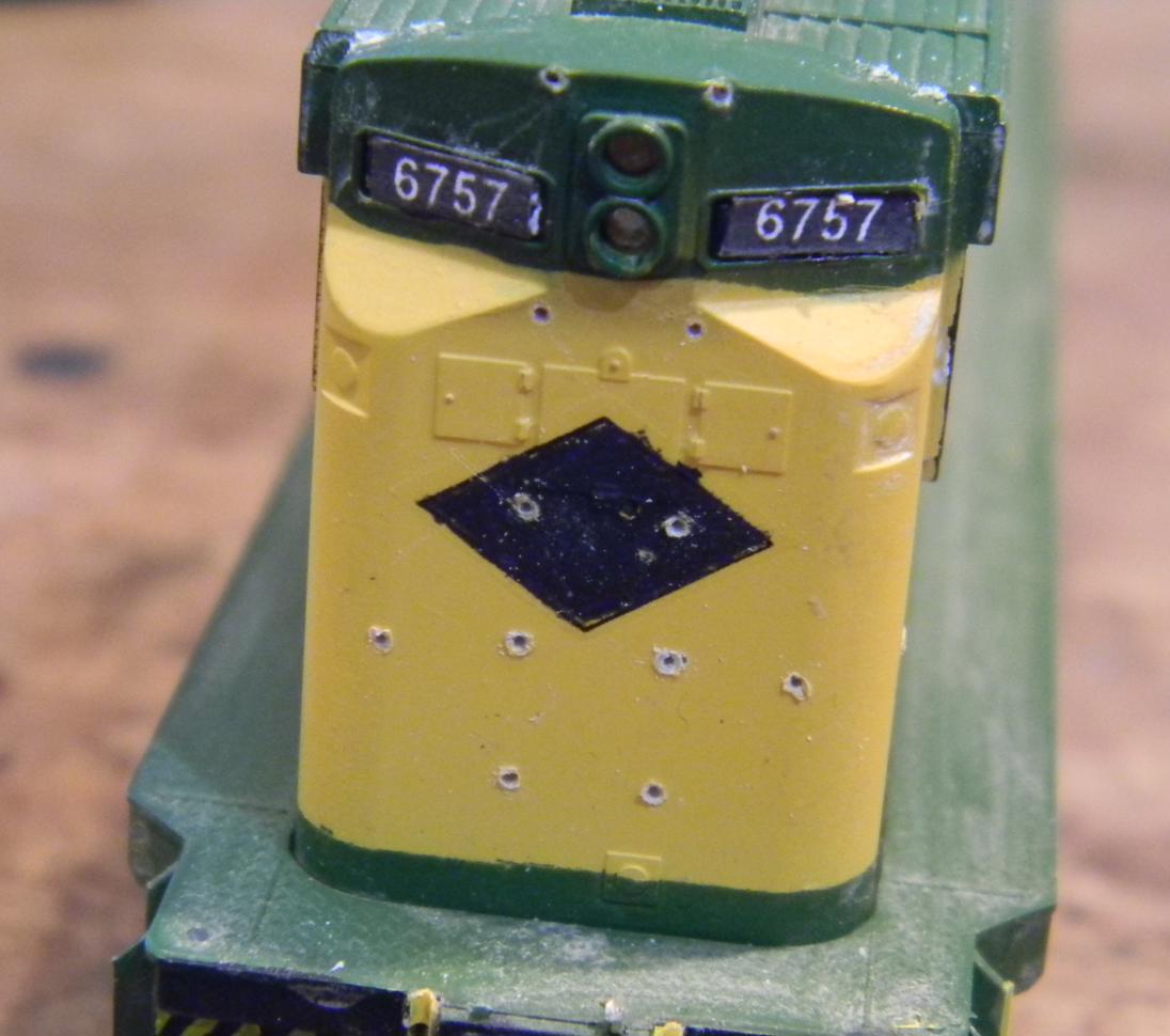

The tight shots on the paintouts show a bit of overpaint over the diamonds and at the edges of the cab, and I'd be distressed about that on other projects and would attempt to clean up those lines, but on this project?  Perfect!  I'm looking for shoddy paint work for a change!
And there you go....

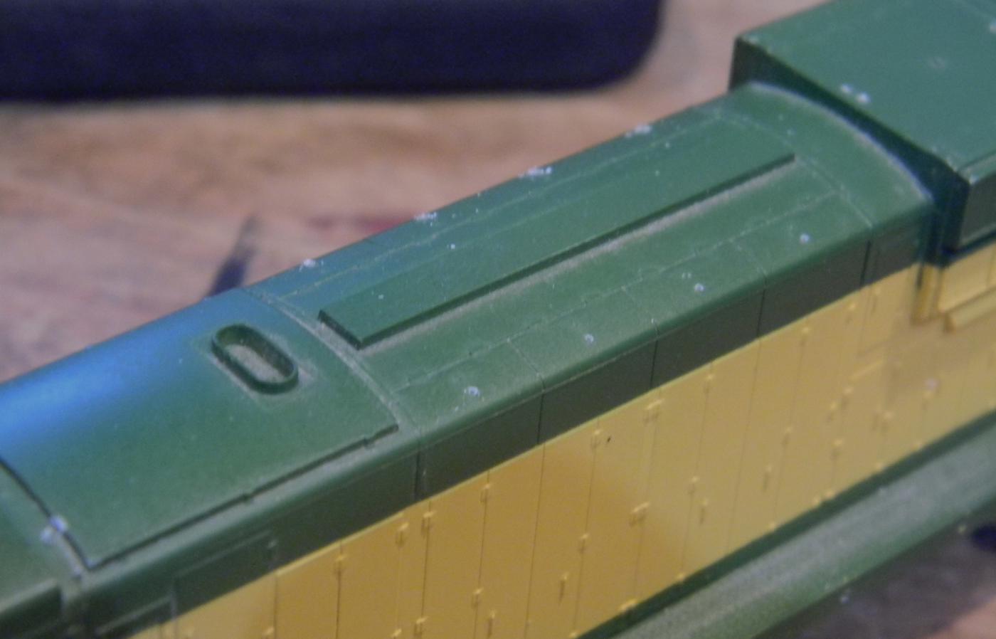

Flattened the 0.010" wire (just like I did with the larger checkout piece I did last week), and made up two rain gutters and then hit them with a base coat of green with a brush.  I'm not happy with the overall length and the base coat of paint, so I'm going to make two more and paint them up (spray paint this time for a base).  I tried scribing a placement notch in a extra sacrificial cab I had, but I hasn't happy with how it worked out - so the plan is to put just a smidge of super glue on the back side of it and tack it in place with a bit of tape until the glue sets up.

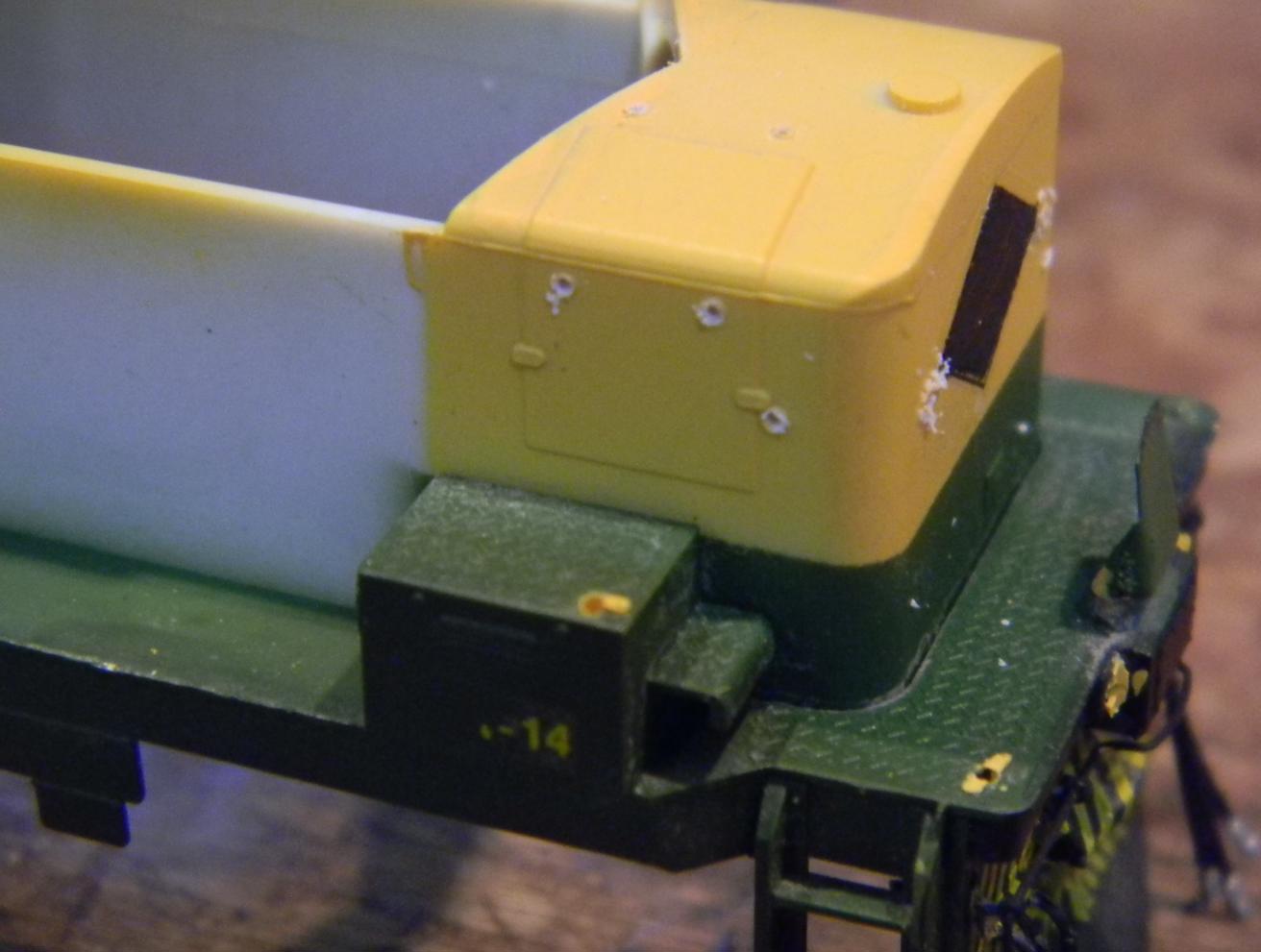

While everything's apart, now's a good time to drill holes for the grab irons. Fortunately, even the Stewart Hobbies version of the C630 has starter locations for all of the holes built ito the plastic body, so it won't take too long to drill. There are also corner grabs in the kit which I'll add as well as lifting eyes (drill holes needed) and windshield wipers. The MU hoses and coupler release bars were already on this one, so that stuff won't need any attention. Total buy for the detail kit was $19.95. I didn't think that was too bad considering all of the pieces you get.
I believe I'm going to check each detail install for fit and then prepaint them all before final install, with paint touchups after that. No pictures until I start some assembly.
46 No. 79 or No. 80 holes drilled tonight.  Even though the model had the starter holes ready on the body, I found it very useful to prepare each hole with a straight pin to give the pin vise a little spot to grip.  I have a couple different bit sets, and although I thought I got a nice one from Chronos in a wooden box from Ireland with about 10 different sizes of bits with about 10 bits per size, those bits bent almost on command.  Sometimes I was just getting started on a hole and the bit would bend 90 degrees.  Abandoned those and found a packet of Chinese bits that was much better to finish up.
