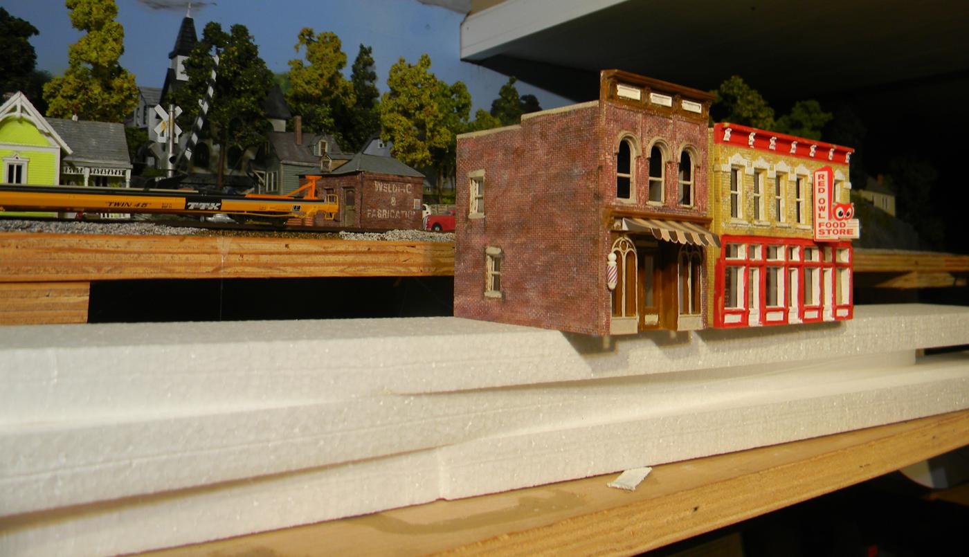

So, I can lay out the rough elevation of Main Street by positioning a couple of buildings with some styrofoam blocking underneath...  (note the tracks are running at about the same elevation as the top of the first story of each building).  These are a barber shop and a grocery store that I've had in mind for White Haven for a few years while they collected dust.
Anchoring Main Street will then give me an idea of the available space left for other scenery proceeding down toward the river.

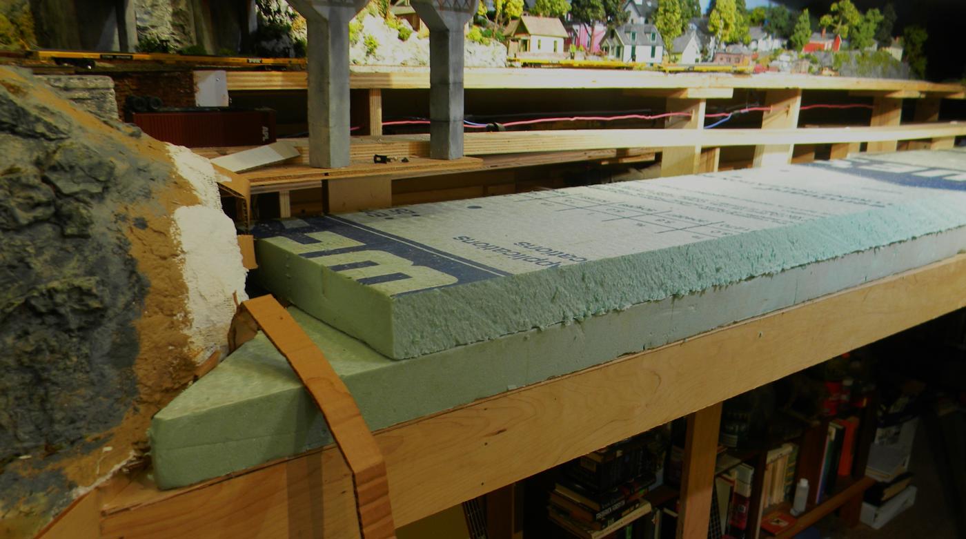

Based on the Main Street topography, I decided there wasn't much sense in building up off of my new structure with layers of 1/2 inch foam board - not much is going to be modeled in the first 4 inches off of the platform (maybe just some rocks, shrubbery and trees climbing up from the river bank), but I do need the base to be level to support the structures.  I'd bought a 4x8 sheet of 2" foam board and lopped a small amount off to build my bridge abutments a few years ago, but I had most of the sheet left.  I cut it into 13" strips and laid it in on top of some luan plywood.  Base is set.  I can always glue the foam board up and rough in the terrain with a hotwire foam cutter after I get a better idea of the areas I need for businesses and roads.  Everything will (eventually) get the plaster cloth and Sculptamold treatment after roughing in the terrain.
The remainder of the base for the structures will be strips of 1/2" foam board, but I don't want to glue anything in place until I rough the structures and lots in - it'll be a while for that.

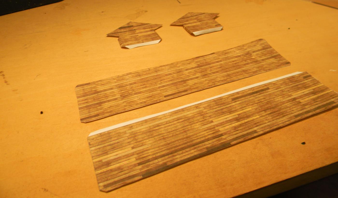

Before I get to the Main Street businesses, the idea of scratchbuilding the LV station has been running around in my mind, so I'm going to get that one done first.  I thought about doing it in plastic or balsa, or maybe even looking online for something close as a kit, but it's a really simple rectangular building with lap siding and a steel roof.  There was a Clever paper model that had some promise - it was a small Flag Stop station that I thought I could blow up in size.  Then I started to think about textures.  Clever sells 8x10 siding, roofing, and other detail textures.  Cost is between $2 and $2.50 and you can print as many sheets as you like.  I thought if I bought that and cut it to the sizes that I want for the four sides of the building, and then adding doors, windows and other detail parts from other kits that I've bought over the years, I could make something pretty close to the prototype.  That's the initial plan anyway.  Downloaded HO Scale Lucky and Knotts Siding.  After I printed it out, I thought it might be overscale - I think the siding exposure should be a bit smaller, but I'm going to go with it anyway.
Based on the pictures I have on hand, I can estimate the size of the building fairly well.  It looks like the endwalls are about 10-12 feet wide, and the long section of the building looks to be somewhere between 50 and 60 feet.  Got my drafting board, a pencil and my triangles out to draw out each wall.
Found some doors and windows I thought would look good out of other Clever buildings and added a small loading dock to the end of the building as in the prototype.  None of it's exactly to scale from the prototype, but it will work.  I do need to build some rafter trusses to support the extended roof lines on the long sides of the building, and I think I've found a stone or brick foundation that'll go under everything.  I do not have a photo of the back sides of the building, but I think there should be at least a couple of doors and a long loading dock.
