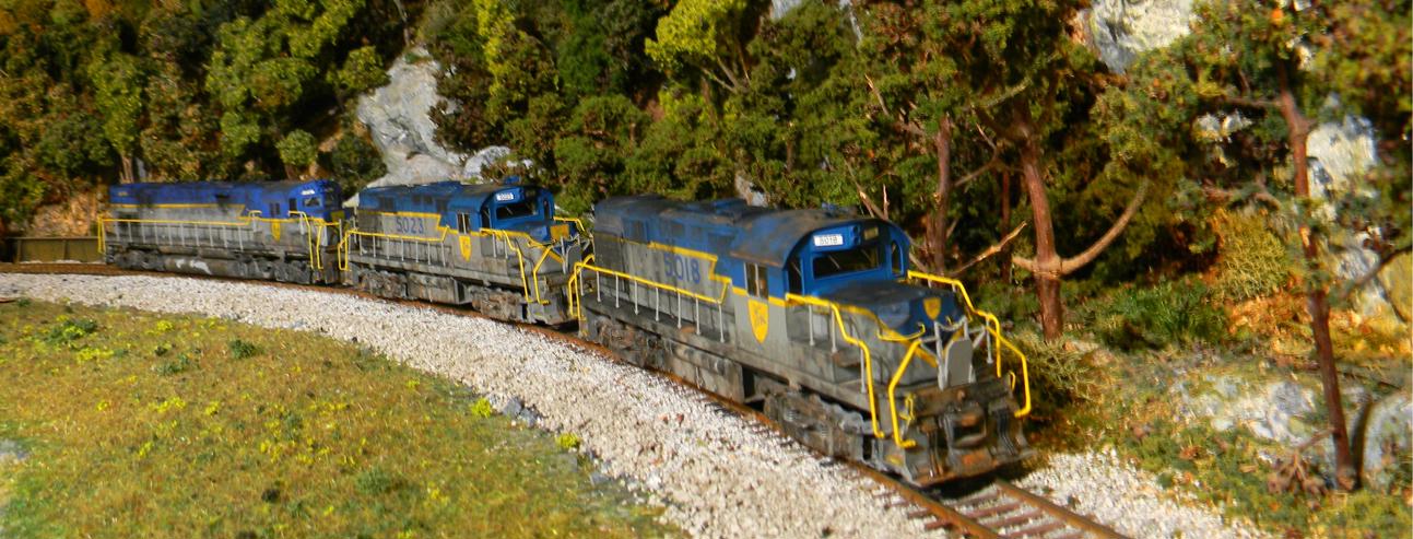

I finally finished installing the painted handrails on all three units, but they also need to be weathered.  I also had to retouch some gray paint on the fuel tank of the C628 (hence the bright patches on it). Here's a shot of all three before dulling and decrepitalizing... which shouldn't take me too long to do.  I still need to rust up and install the couplers as well, but we're certainly in the home stretch on this project (thank goodness....)
