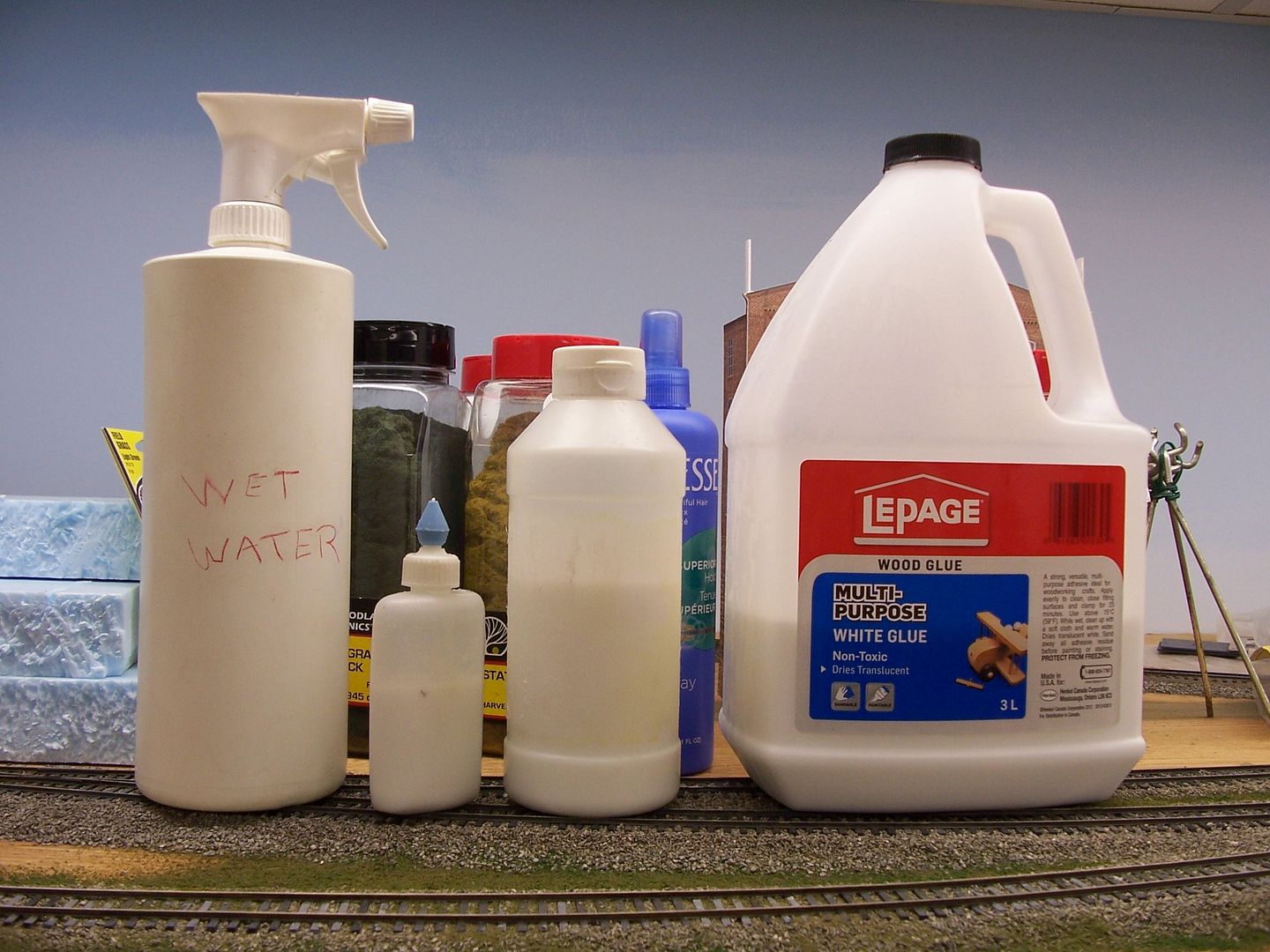

To affix the groomed ballast in place, add a few drops of dish detergent into a sprayer filled water (if your water is overly hard, use distilled water, which is available in most grocery stores in gallon jugs.  (A cheaper alternative is to use water collected in the bucket of your dehumidifier - (be sure to clean the bucket thoroughly before turning the dehumidifier back on).
Don't be too stingy with the water...I usually spray upward first, so as to not allow the spray to move the ballast.  Once it has been dampened, you can spray the ballast more directly.

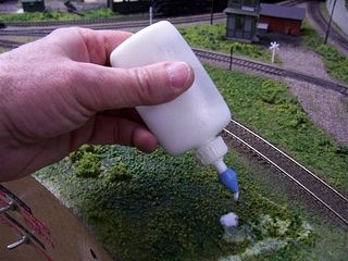

To affix the ballast in-place, I use ordinary LePages white glue, mixed about 50/50 with water....
Depending on how deep the ballast is spread, it may take quite some time for the glue to set (I had some alongside the track that was almost an inch deep, and it took almost a week to fully harden.)  For track on roadbed or directly atop the layout's surface, the ballast should be firmly in-place by the following day.  Once the glue has set and is completely dry, do make sure to clean the tops of the rails, as any glue on them will interfere with electrical contact.
