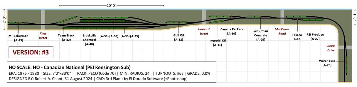

I've decided to add a second layout to my to-do list even though the first one is still very much in progress however,  I need a break from big power, conspicuity stripes and graffiti.
The Kensington Subdivision is set on Prince Edward island in eastern Canada in the 77-85 era when CN actually served Canada from coast to coast. Traffic traveled to and from the island by car ferry. The section I am modelling is from Traveler's Rest to Summerside. Power will be MLW RSC-14's (There were 38 on CN from 1977 - 1996 and used on light rail trackage. They have A1A trucks to distribute the weight of the loco over poor track. They started out as  standard Montreal Locomotive Works (MLW) B-B RS-18's) Caboose (vans) and transfer vans will be used.
I attached a working draft of the track plan. I'll update it as changes take place.
