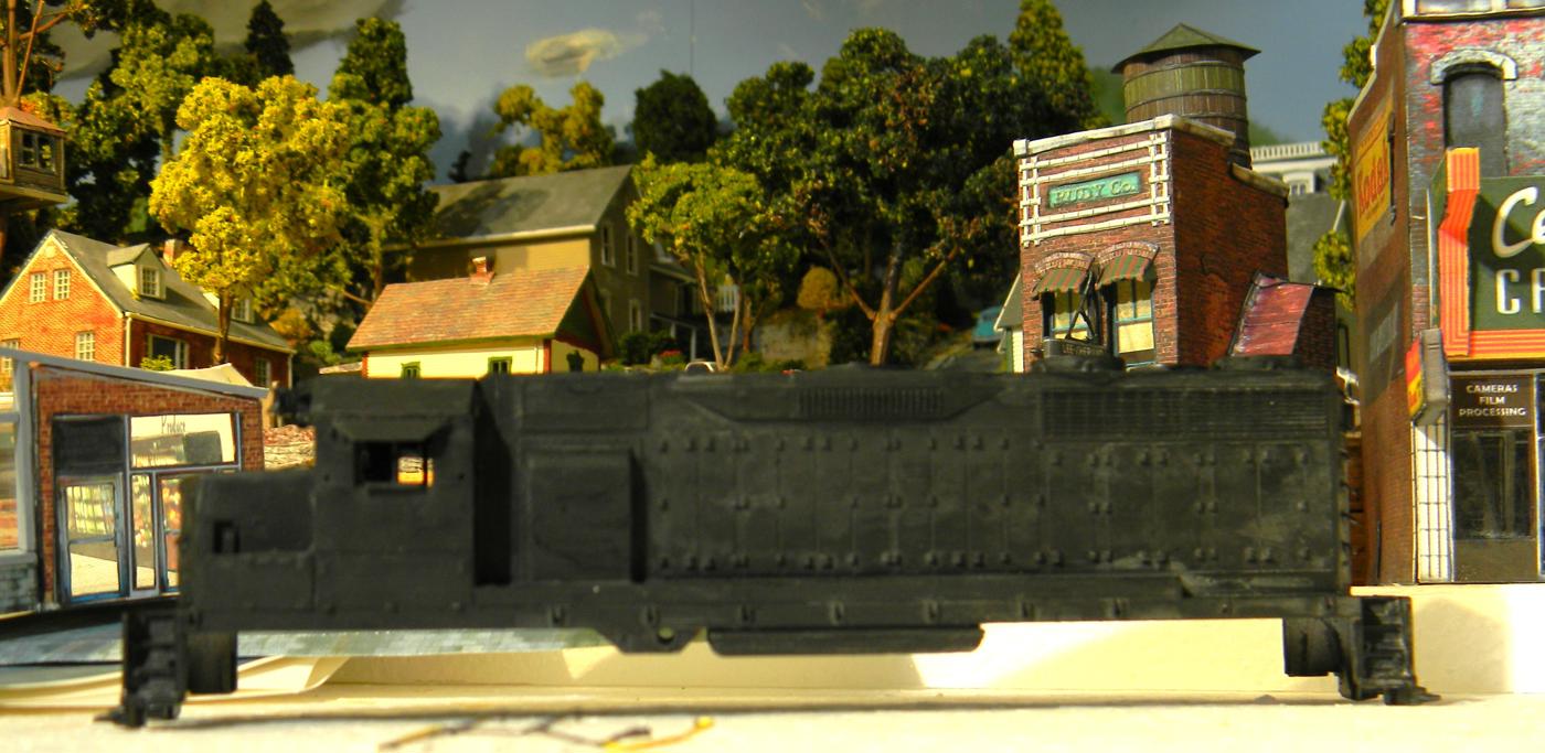

Got the airbrush out and gave the entire GP35 shell and railings a coat of Black - actually Polly Scale Brunswick Green. I like the faded black, kinda of an ebony gray - which is what you get with a locomotive outside for a couple of years. In this case, the original paint jobs were done in 1969, with 4001 getting the zebra scheme (and a new dip) in 1975. I'm still in the throes of which paint scheme to model - both will need this black base coat, but the red's a little different depending on which scheme - the zebra stripe gets a full red cab, the older "big CN" scheme gets red only to the front face of the cab. Since I still don't have the blessed bell, I won't be painting the red until that's installed. I'm also going to at least drill the holes for the grabirons (those are also still in the mail) before I put the red on.

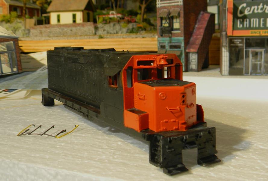

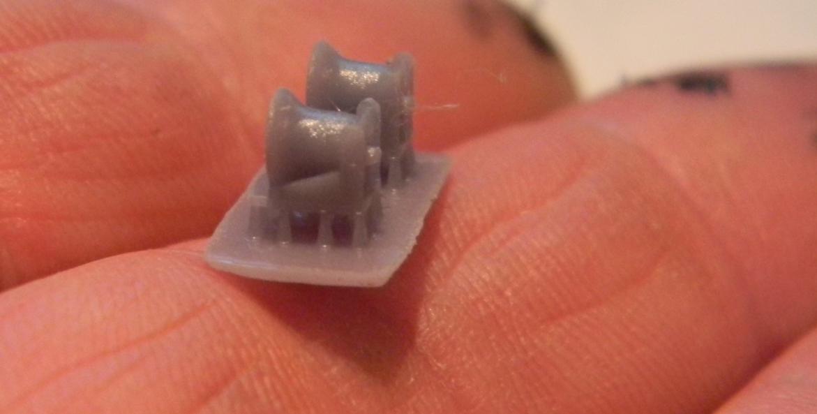

Got the bells this week (man are they tiny!), so tonight was the night to install one.
I'd previously cut off the lens shades on the cab mounted headlights, but that still left an oval area that didn't match the rectangular area to mount the bell bracket.
After contemplating the arrangement, I decided to get out the Dremel with a sanding barrel on the end and I removed the plastic down to the base of the cab.
A little CA, and the unpainted bell now resides in the middle of the cab roof!
While I was at it, it was also a good time to install the sunshades on each side of the cab. I'd bought some Cannon and Co. EMD Cab Sunshades. Word to the wise, these things are really thin and easy to snap in half! They do fit nicely in the slots that Athearn molded into the area above the wide though... Again, a dab of CA did the trick. All of these new details will get splashed with some primer soon.

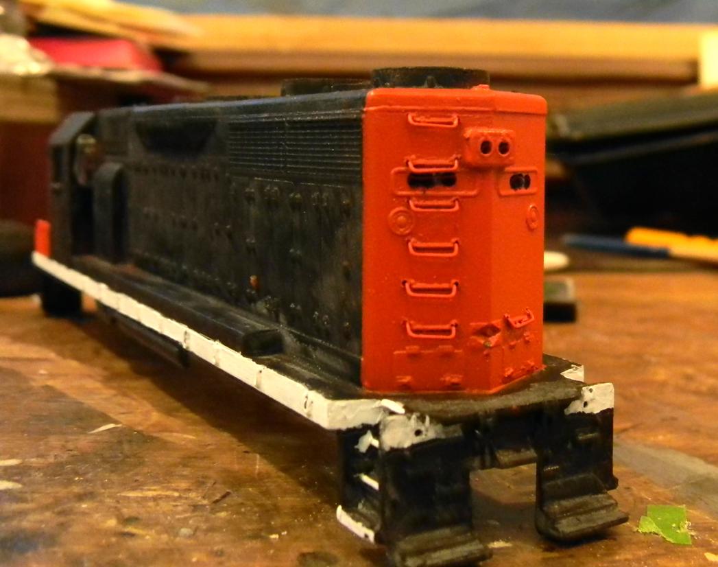

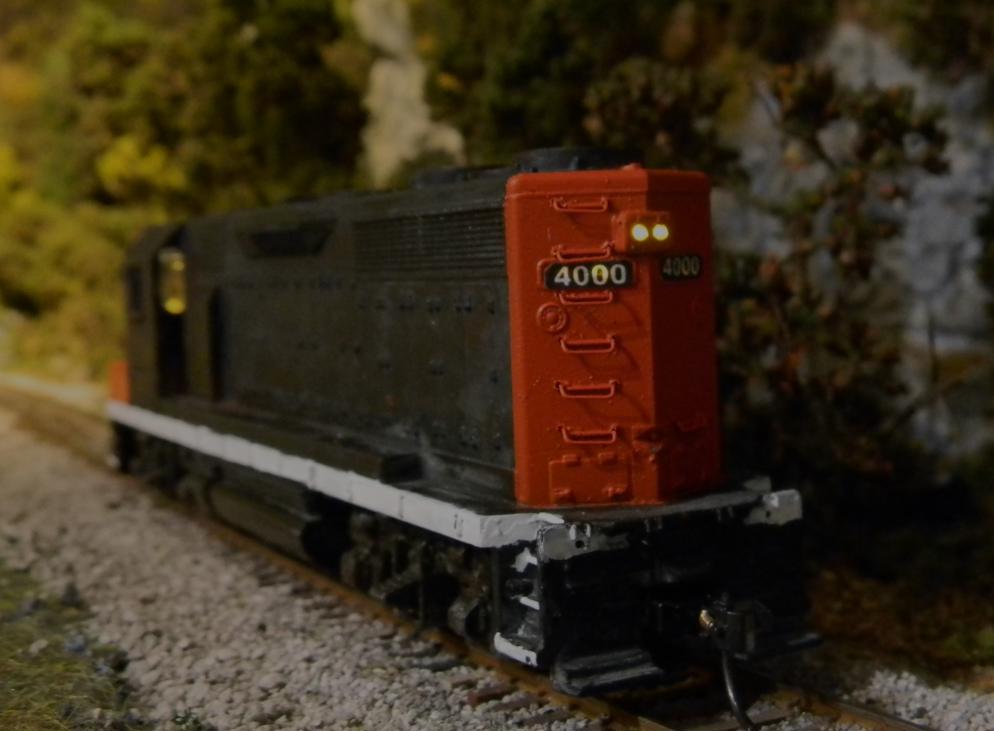

Added the splash of color on the front and rear ends after quite a bit of masking. Still a little detail painting to go including the sills and a couple odds and ends. I'll probably dull up the orange/red as well at some point. Got a little overspray inside the windows which reminds me that I wanted to at least paint the inside of the cab with some light gray maybe.

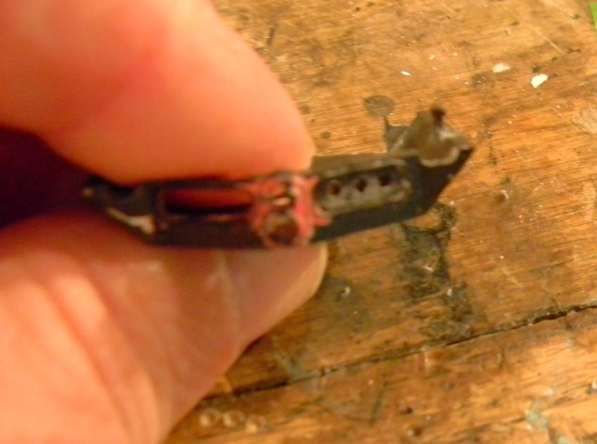

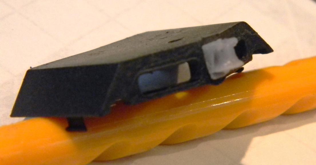

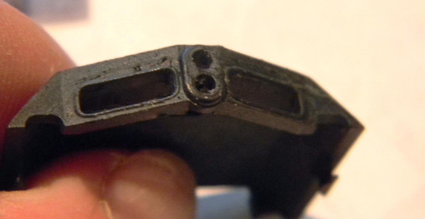

I decided to work on the number boards for the front and rear, so I went searching for the transparent window insert for the front cab.... I started last night and turned over my workbench and my desk to no avail. What should have been an easy task just got tougher. Plan B.
Since there's no cab headlight, I wasn't going to worry much about lighting up the number boards, figuring that there would be enough blowback from the nose light that it should wash into the cab and hit enough of the transparent number boards, but now that I can't find that piece, Plan B has to try to get at least some light onto the board.

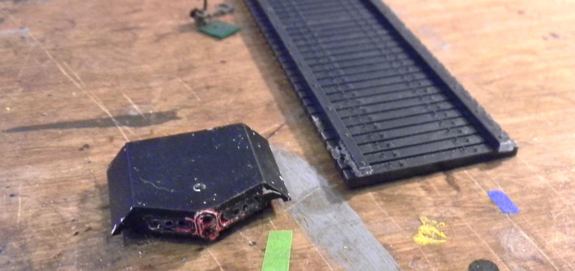

So, I have an extra cab roof (alas, without the number board insert) to serve as a test bed. Dug through the extra plastic parts and found some decking for a bridge. Just so happens that the ties on that bridge are just the right width to fit inside the number board on the cab
Cut to approximate length, sanded the ends until they would slip in, and then ran a few holes through the middle to allow some light in.

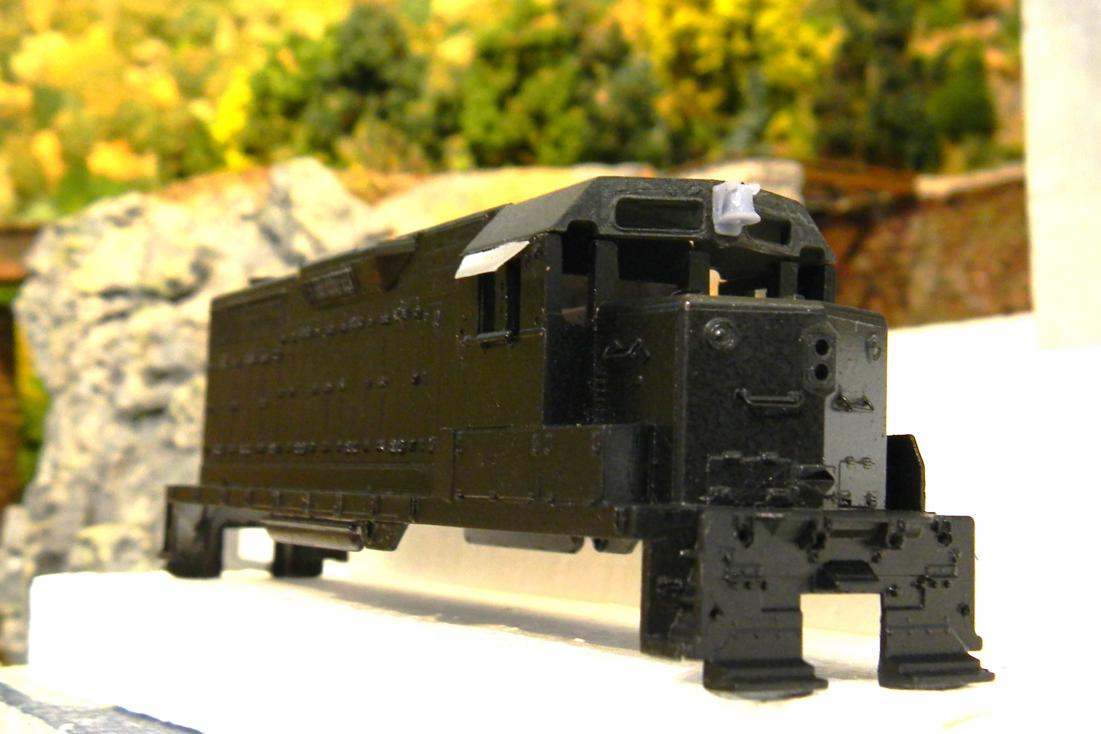

Printed the road number on some sticker paper and cut to fit the boards and installed on the real deal.

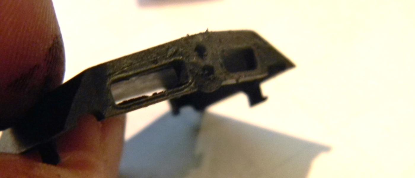

Also cut a light window in the center of the two rear number boards with three holes drilled in each,
and applied the same stickers there, and I'm really pretty happy with the way the number boards are lit (reduced the exposure quite a bit to get the number boards to show the light you see in real life). Ready for decals and that blasted plow (if CMR ever gets it into the mail).

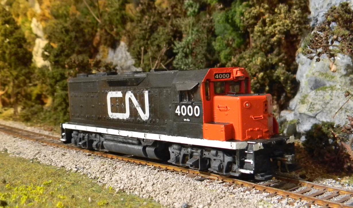

Well, while I was watching The Masters this afternoon, I did a little less than half of the decal additions and did some base painting of the trucks and fuel tank on that side. The K4 decals are on pretty thick film, so there are plenty of applications of Micro Sol to get the "CN" worm decals stretched over, around and down into the shell. Here's a shot of one side with the Micro Sol drying.
