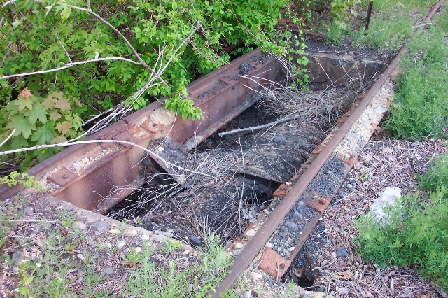

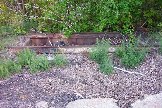

Sweet looking coal dealer.
All I ever see modeled though is the trestle type of coal delivery.
Here's a couple of pics from a local coal dealer that didn't have a trestle, but a siding with four pits in the ground.
There's even still coal in one of the pits.
NARA Member #87
Steve/Doc/88...Thanks for the info....I'm looking to install a pit storage like the one shown by 88...How would the coal be moved out of the pit? I would presume that a conveyor pretty much like the one in your link..No..?? Any additional info would be appreciated... Thumbsup
