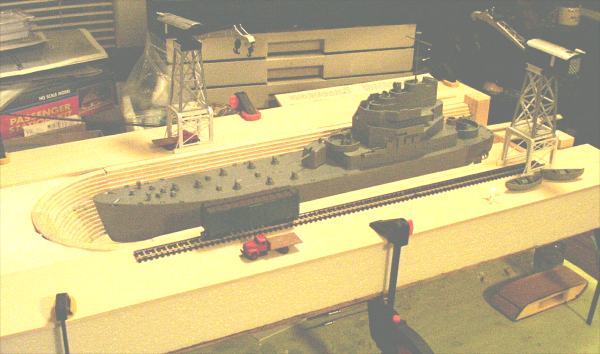

When I did the drydock for the Ntrak module, I used water based contact cement to glue basswood to the foam base, and then styrene sheet (concrete) to the basswood. It's been several years since, and I still haven't seen any separation, either from the foam base, or of the styrene sheet from the basswood.
this pic shows the basic drydock, with the ship it was designed for. The styrene sheet "concrete" hadn't been attached yet when this was taken.

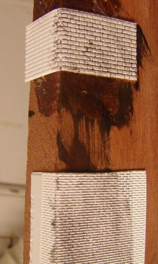

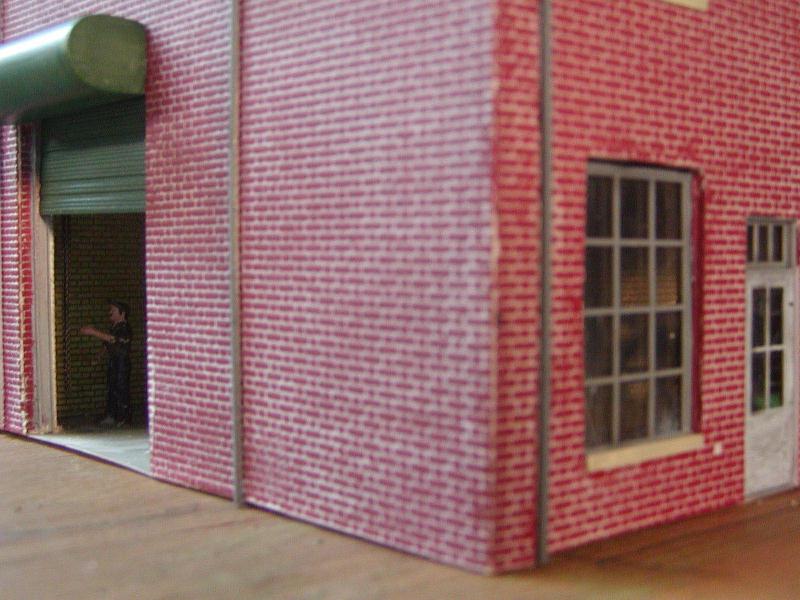

Hi Wayne, I'm back from my short trip. I do have some of the old Holgate and Reynolds material, which is vinyl. But I was planning on using the styrene brick sheet by Model Builders Supply Line, part of N Scale Architect. I believe when you were here you took a close look at the Quinn Ball Bearing plant. It uses the Holgate and Reynolds material. The powerhouse on the other hand uses the Model Builders styrene sheet. The pic below show a couple corners on the powerhouse. Note the sharp corner by the loading door split when formed, as you might expect. The corner of the building did not, but is a bit rounded, not a tight 90 degree corner. This seems to be the dilema of using styrene versus the vinyl. However, I experimented and it seems possible to get a tighter corner with styrene by heating the styrene with a hair dryer. Before I went away I cut a piece of the vinyl material and bent it to 90 degrees, and heated a bit of the styrene material with the hair dryer, and bent it to 90 degrees. I used Barge cement to attach both pieces to a piece of wood. Barge cement is basically a contact cement, I think. I bought and use it for glueing rail to both plastic and wood ties. I have never (over several years) had any gauge problems with track laid this way. So I thought I'd give it a try. Upon coming home four days later, both the vinyl and styrene brick are securely attached, and the styrene was not affected adversely. The heated styrene sems to have tken the 90 degree bend well. For reasons of ideal material consumption, I would love to use the vinyl material for the "basement" walls as shown earlier, and styrene for the main bldg, as I would not need to buy more of either. However, the size of the bricks depicted by the two products are very different, leading me to believe I should not do so. You can see the size difference in the pic below, I quicly brushed on some thinned black paint to make the brick sizes more evident. Do you agree the difference is too stark?

A good trick to remember for doing the corners, Gary.
From my recollections, the smaller bricks are the H&R ones. In my opinion, it would probably look better with the larger bricks for the foundation, although not necessarily.  While many "structural" bricks were oversize, the same could be said for ornamental types, too. Colouring can play a big part in making this look "right". Depending on how much of the foundation will show on the "public" side of the building, you could probably get away with using the H&R bricks for the foundation if they were at least a slightly different colour - around here, bricks used as part of a support structure are usually very plain-looking - all the same colour, usually a very bland shade of brick red. You might try adding a stone or concrete sill between the two types of brick, too - a simple strip of styrene, scribed if it's meant to represent stone, should do the trick.
Another way to de-emphasise the difference in brick sizes is to use a mortar colour that is fairly similar to the colour of the brick, especially for the foundation. I know that this sorta defeats the purpose of using brick as far as the detail and relief is concerned, but some weathering should still allow the detail to "pop" sufficiently.

Thanks for the replies guys. I should have noted which was which in the bove photo. Wayne is correct, the Holgate and Reynolds is indeed the smaller brick of the two. In the photo, it does look almost as if the larger (styrene) brick is a type of cut stone. I believe this is due to the huge difference in size when placed side by side. The powerhose wall in the photo above shows the larger styrene brick. Here is a photo of the ball baring plant wall, I think in both cases the bricks look like they are sized correctly, but the ball bearing plant using the H&R vinyl are actually too small.

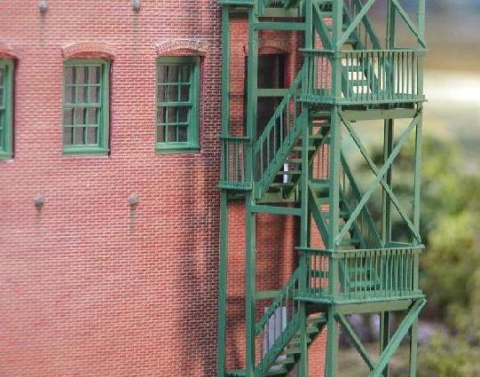

Another thing to keep in mind is that mortar can be tinted to almost any colour. All of the brick structures shown below were painted with Floquil reefer orange, then different shades of mortar were applied, and slightly different weathering methods used.
This particular shade of orange brick was quite common in my hometown of Hamilton, Ontario, although many structures appeared much darker on account of airborne pollutants. If you use the spackle method of applying mortar, you can pre-tint it with acrylic paints, or simply add a wash of the same after the "mortar" is in place.
