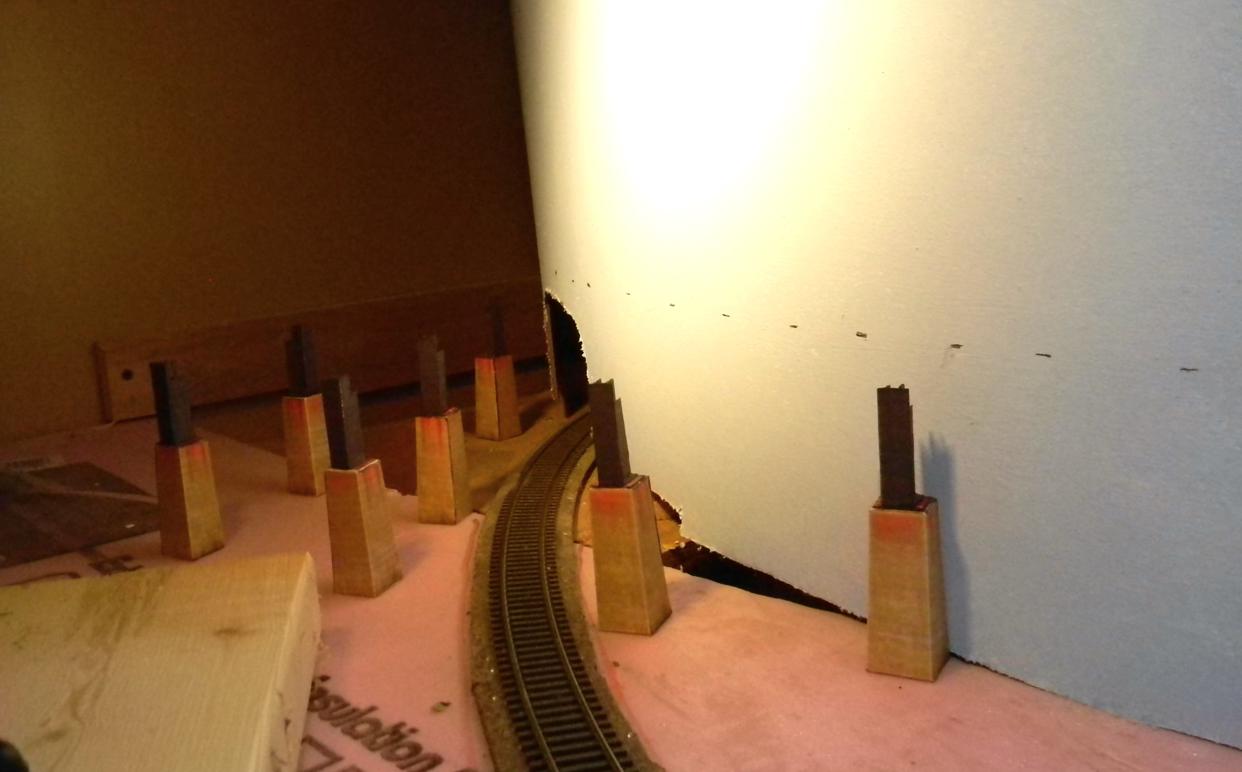

I did build some more piers and some girders and started laying out my vision for how I'm going to present the breaker.
The layout here is not level, so one of my first tasks was to develop a level reference line on the backdrop near where I'll install the 2nd floor, which will be a piece of foam board fitted to the curvature of the backdrop. Got my laser level out and marked the backdrop.
To get the piers right, I'll have to shim under each one (after adhering them (and their support girders) to the foam board). I'll also probably end up doing all of the scenery on the base level and around the piers before anchoring the foam board and the piers. I'll also need to paint out or scenic the backdrop on the base layer, which will further disguise the entry to the storage level.

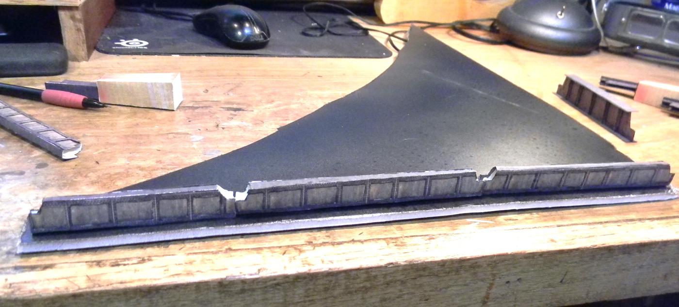

A little more progress to report. Spray painted the underside of my foam board I'm using for the first floor and attached (glued) three girder on the front edge that'll be supported by the concrete and steel columns. These girders were also in the crane kit - they are the trolley for the overhead crane and are longer and the web is shorter - don't have to worry about rolling stock headroom.
I then did a little test fit over the posts (which still haven't been shimmed or leveled - but I'll do so soon).

I don't know if it's obvious from the last photo but there was a slight bend (upward) on the left half of the foamboard that was a bit annoying and was enough to throw level off. Fixed that this afternoon by cutting a congruent piece of 1/4" plywood and gluing it to the top of the foamboard. On the underside (shown below) I've added some more girders - the breaker's a heavy hunk of steel. I'm getting closer to the point where I'll be permanently positioning the posts - scenery is still necessary on the full underside of the breaker and I need to put up some walls down there to obscure the entrance to the storage area. Got a trip to Texas later this week, so I'm guessing a progress picture probably won't make it to the site for a couple of weeks.

I've had a little time to work some issues on the coal breaker and play around with some ideas for the first floor. The first goal there is to disguise that great big hole in the curved backdrop that descends to my storage level. I painted a dull dark gray on the segment of the backdrop for the first floor - a big improvement over the light blue where that hole was in stark contrast. In a little while I'll be mounting printed breaker "internals", pictures I've pulled off the internet inside breakers as well as sections of sheet metal walls that'll project from the ground to the ceiling.
I also decided that I'd permanently place some coal hoppers under the breaker, but I didn't have a stub track off my mainline for that. I just decided to slap down a section of track that wouldn't tie into any portion of the main. I had a short section of track, but no more cork roadbed. Cut out at strip of foam board and painted it gray - same elevation as the roadbed, and it'll all be disguised by ballast soon. The space between tracks was a perfect location for Plant #2, which also breaks up the sight line between the edge of the layout and the hole in the backdrop.
The two layers of double-sided tape wasn't working too well to hold up the first floor. Replaced those with a single strip of PVC molding held on with a piece of double-sided tape. Also painted that gray.
I also began getting the right shims under each of the piers that'll support the girders under the floor. Once I get all of the shims permanently in place, it'll be time to lay the plaster cloth on this "ground" floor. This is one case when I'll be building the rest of the building over a finished basement.
