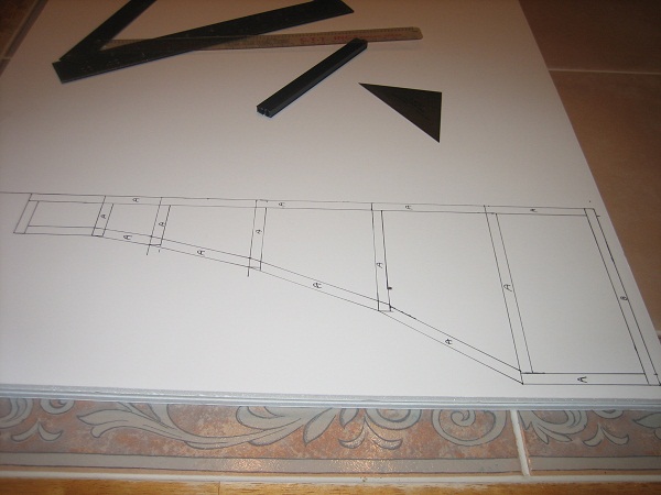

Now I felt that I should get going on the bridge it's self.I started by drawing the towers out in full size on some foam board. Really paying attention to keeping all the joints at right angles. I checked and checked again to make sure I was happy with it before I started building anything. The foam board will act as a template, so it has to be correct.

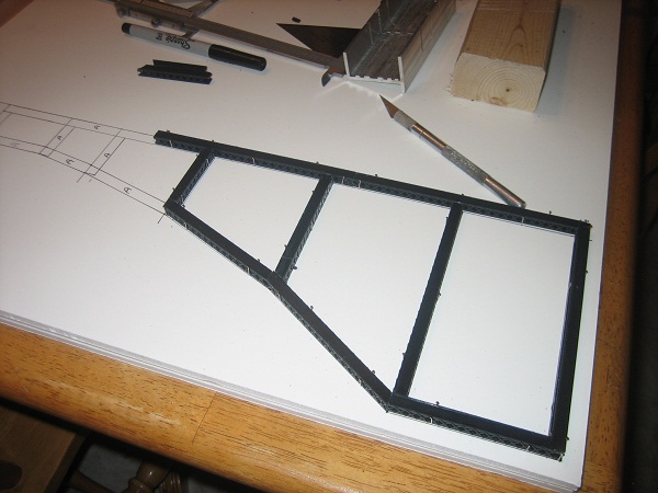

I Cut some Central Vally #1902-5 bridge girders as per my drawing and glued them in place. The next step was to hold them down using pins stuck into the foam board.

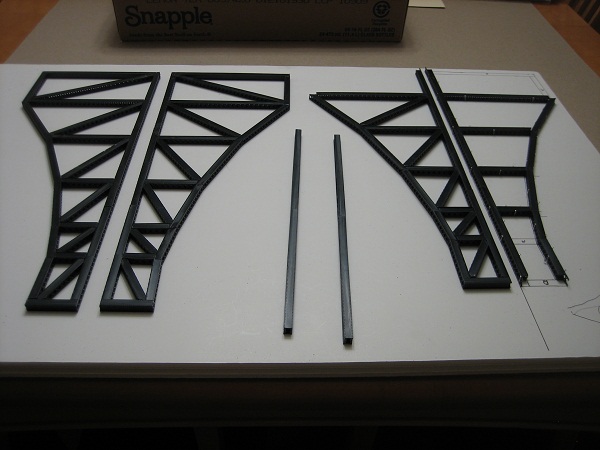

I will have to make 4 of them . They consist of Type A girders on the top and bottom with Type B-B as the remainder of the girders.

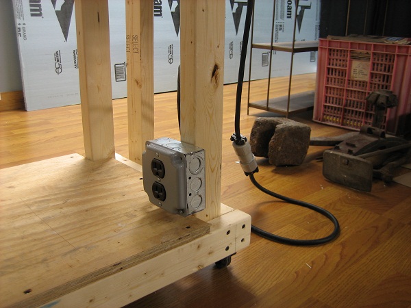

I gave the glue a chance to dry and installed a receptacle on the wheel out section. I'm not sure how I'm going to power the lifting section of the bridge yet. The 110 volt outlet will allow me a bunch of options. It's feed with a section of SO cord with a twist lock disconnect that will give me a safe way to remove the section with out turning off the power.I also made it long enough that I can move it around a little without unplugging it. The track power will be feed from a similar setup.

Oh... Electricity is not a hobby. Hire a licensed electrician!
Posts: 2,724
Threads: 160
I absolutely agree with that, too many times I have been called to fix the problem after the fire. That's why the circuit is on a 15 amp breaker with #12 wire. The rubber cord is a 12/3 SJOOW, more than enough for the needs of my finished basement. It is on cord connectors with strain relief, and the twist lock is a NEMA #L5-20P witch is an approved means of disconnect. I work for D'anna electric NJ licence #3131. I have been a member of IBEW local #164 since 8/99 and 827 from 2 years before that.

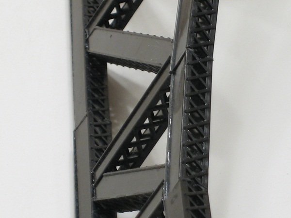

I really like the detail on the bridge girders. Once the towers are freestanding I will work on some splice plates where the girders meet.

I like the bridge girder detail also. This bridge is going to be tremendous.
