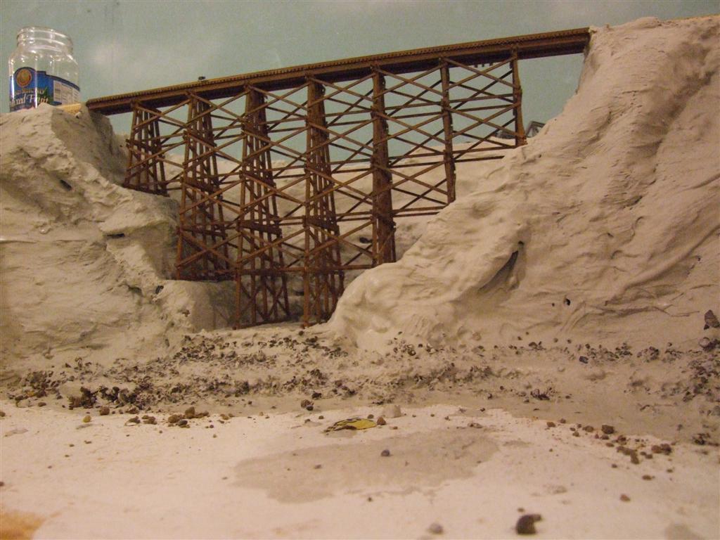

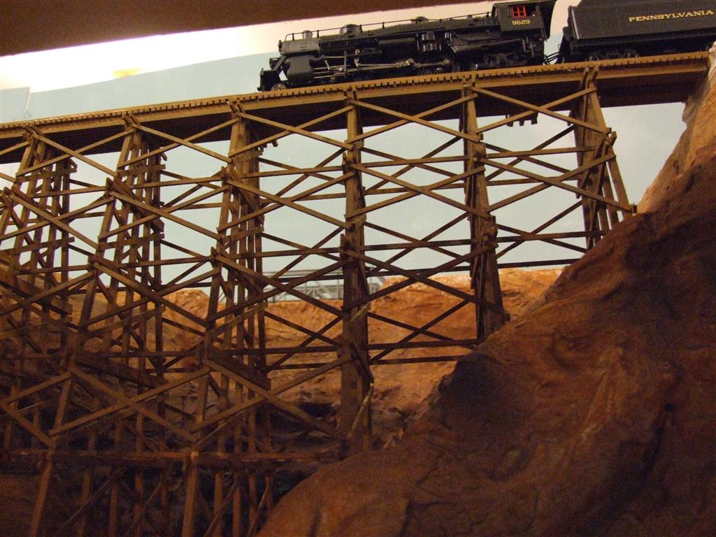

We returned from our trip to NC Monday, and after resting a bit I got to play with some mud. For some reason I have been putting this off, but I decided that I had to start sometime.

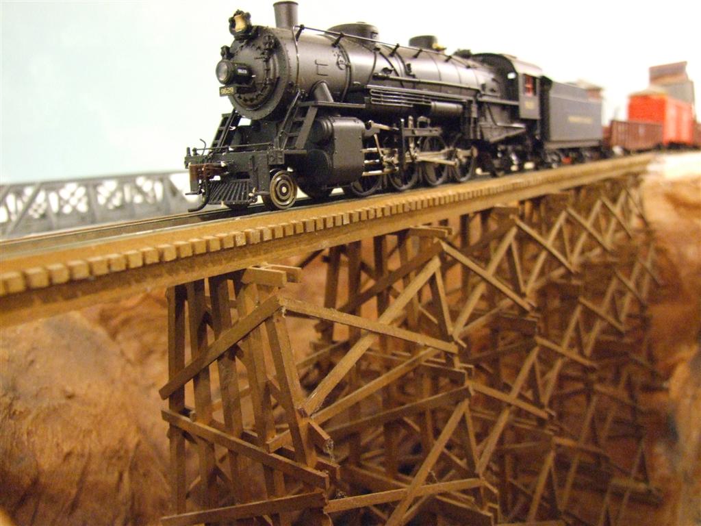

Here are a few pictures of the ravine and Morris Trestle.
I must say that the Dura-Bond that Wayne recommends is the best hard shell material I have ever used. I used the Dura-Bond 20 for this with acrylic paint from Walmart to color it.
Nice job on that trestle Charlie. That is shaping up to be an incredible scene. Thumbsup
I won't take credit for building the trestle, that was a gift from "railcop", a member here too.
Lookin' good, Charlie, and nice to see that bridge scene as the start of your scenic efforts. Thumbsup Thumbsup

Charlie, the trestle and the gorge is quite spectacular, and I'm looking forward to seeing it in all its scenicked glory. Thumbsup
Wayne, I was working late last evening. I had the "Nutmeg" acrylic paint from Walmart. It comes in a plastic squirt bottle, so I squirted it on a cheap 2 inch brush and smeared it on the Durabond. then I used a squirt bottle and misted the paint with water to spread it on thin. Let it dry just a moment and shot a little flat black where there should be some depth, and called it quits.

Charlie.....That is a great looking trestle..!! Thumbsup
I hope to have a scene like that on my layout, but first gotta start construction of the center peninsula, AND build the trestle.... Goldth

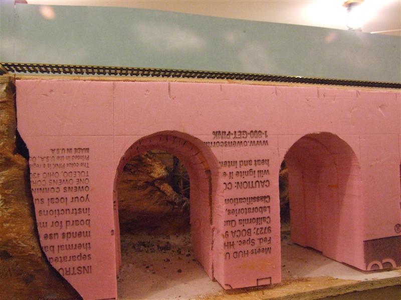

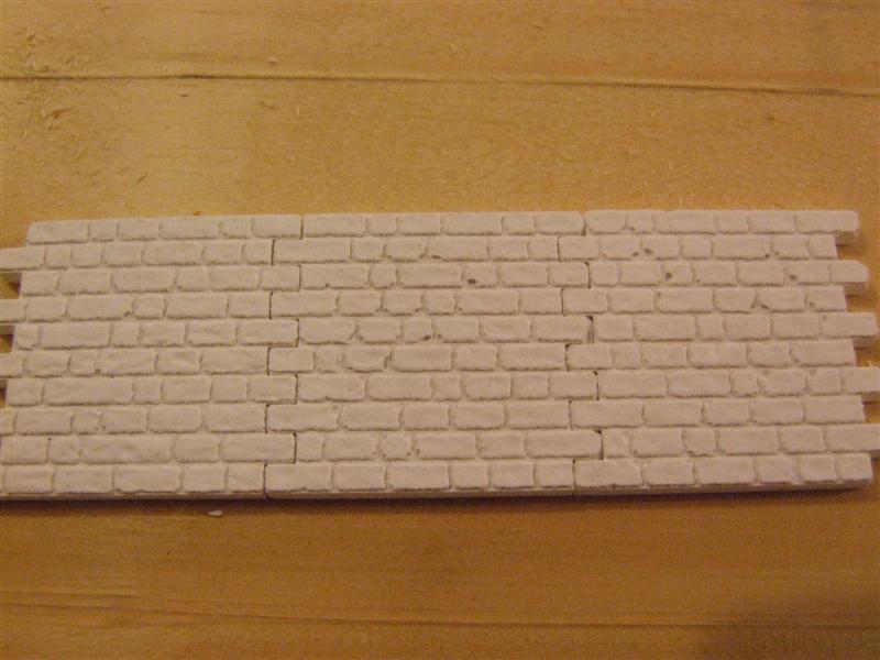

Well, I have commenced with the 4 track viaduct. I have glued 4 pieces of 2 inch foam together after cutting the arches on my band saw. I have to go to the hardware and get a surform file to true it up then I think I will put a light coat of Durabond over it then I will use the stone castings from my Linka building molds to face the entire structure.
I think I will do the rear and the underside of the arches before I permanently install it then I can do the face after it is in place. I think after the viaduct is done the rest of the scenery will just be time consuming but a piece of cake.

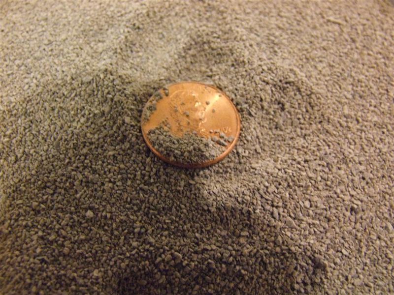

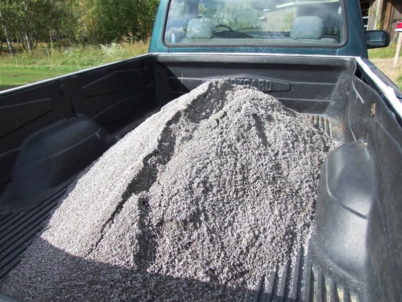

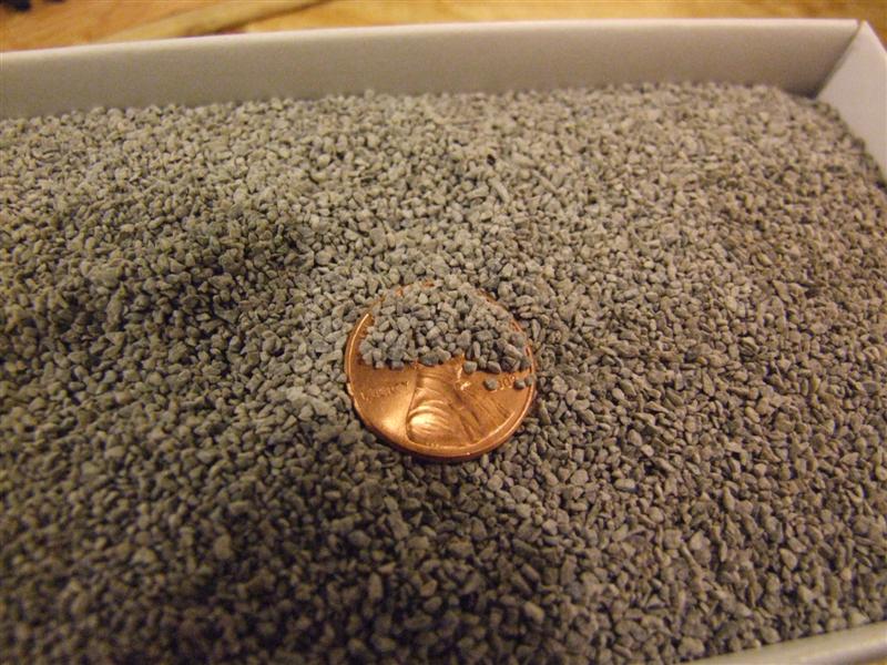

I went to the local limestone mine today and bought 1500 pounds of spec sand, which is limestone sand. I dried and screened about 100 pounds and I now have 18 quarts of ballast and a 5 gallon bucket of ho scale rip rap. Cheap Chucks cost for the ballast, $4.95 including tax, ( I could wind up with 285 quarts if I wanted to screen it all) and because it is only 5 miles from home the fuel wasn't bad either. Of course, my labor is free now I'm retired, but that's what the hobby is about isn't it. (Didn't someone start a thread about cheap materials?)

Well then my hats off to railcop. Either way it looks right at home where it is. Thumbsup
Boy, you really weren't kidding around when you picked up a truck load of ballast were you? Icon_lol
I am eager to see how the viaduct turns out. I like your construction technique.
That is so cool! Never heard of spec sand.... 1500 pounds??? You'll not even come close to using all that, right? But at 5 bucks, you might as well stock up! And the size compared to the penny looks perfect for HO scale ballast.
