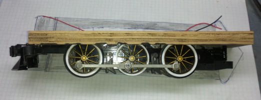

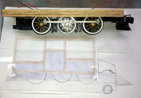

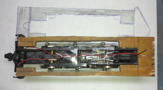

Now... I have to have something solid to attach all that wood to, when I build the sides and front & back. so, I need a "base", or in this case, a belt Smile... There is a small section that forms a lip on the back of the engine, so it's time for another drawing:
Note the shaded area is what we want to keep.....
#17
Just a few minutes with the jig saw and we have the wood, cut and placed on the frame of the engine. Since it's tight and also supported on the cow catcher and the lip in the rear, it's fine..... also, note that it's now 14" long not 12 as in the drawing.... Another re-design on the fly Thumbsup Thumbsup Thumbsup

Here are 2 shots of the side detail and the detail of the drawings......

Were you planning on planing that base down some? It looks a little on the thick side Mikey.
#20
Tyson Rayles Wrote:Were you planning on planing that base down some? It looks a little on the thick side Mikey.
Nope... The base will be totally hidden by the wood "Skirt". The section behind the drivers is where the motor is, so I can't do anything there anyway Sad Sad... The coupling "nub" in the rear (Left in picture) will most likely be altered (or hidden) too.

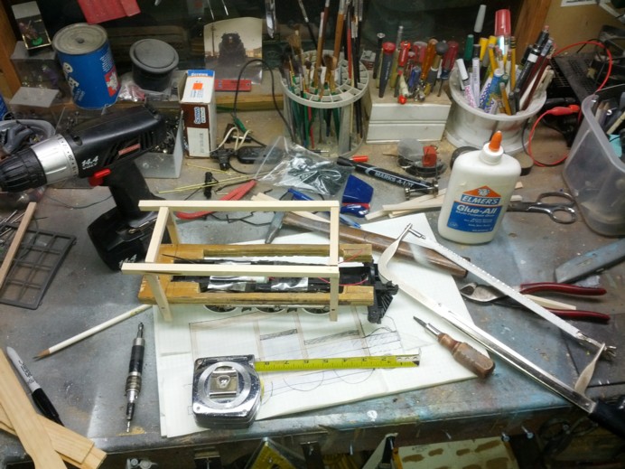

Sumpter250 Wrote:Ahh, That explains why my work area becomes so cluttered in such a short time after beginning any new project !!
This took about 10 minutes...... The "Clutter - not the framework Smile Smile See the posts below for that Smile

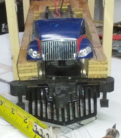

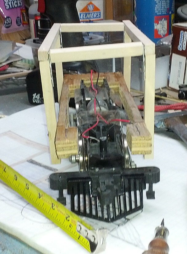

Well - time to attach the framing to make any adjustments that ummm.... will have to be made Big Grin
First - We need to measure twice and cut once... The height from the railhead to the top will be 5-1/2". The lowest clearance on the layout is 6".
I needed to build the framing to make sure this is going to look ok and not too short.
Turns out it looks OK for a 1:20.3 layout Smile The cross bar at the top is only a spacer for the sides to keep them vertical while the glue dries. The "cab" is just placed on there for measurments and sizing too.
#26

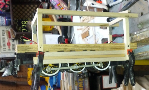

This picture is sideways, but it shows the engine in the vice, with the wood strips that will make up the skirts Smile Smile

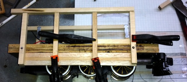

#29
Skirts are finished, and he verticle supports are in place on one said. The 2 clamps that are above the plywood are holding the first "plank" in place while the glue dries Smile Big Grin Smile Big Grin
