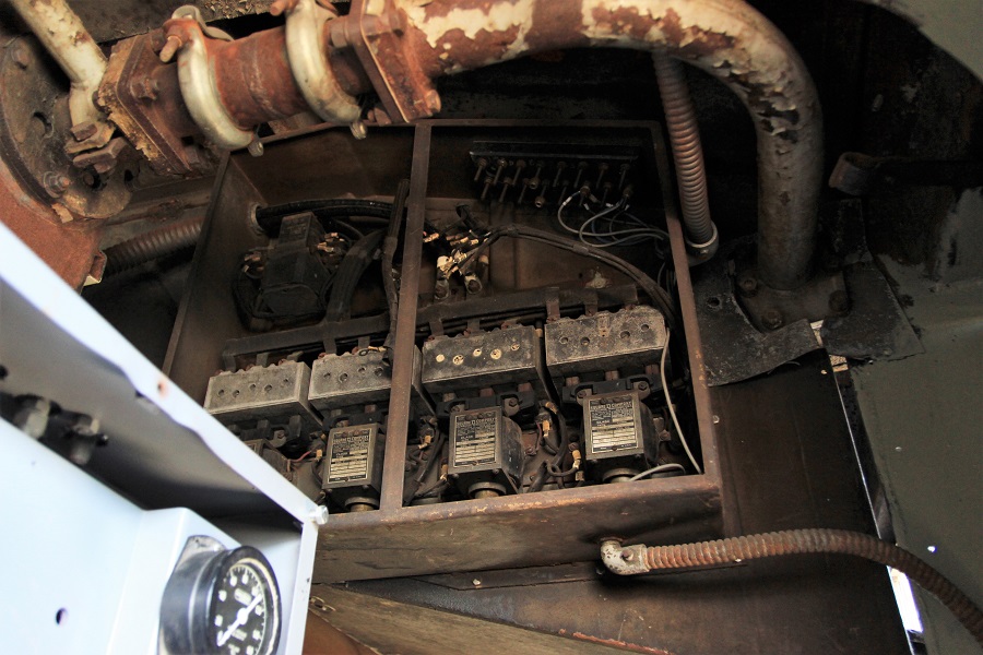

One of the thinks I took care of yesterday was to strip the fan control cabinet and get just enough of it wired so that when the prime mover is started I can test the cooling fans.

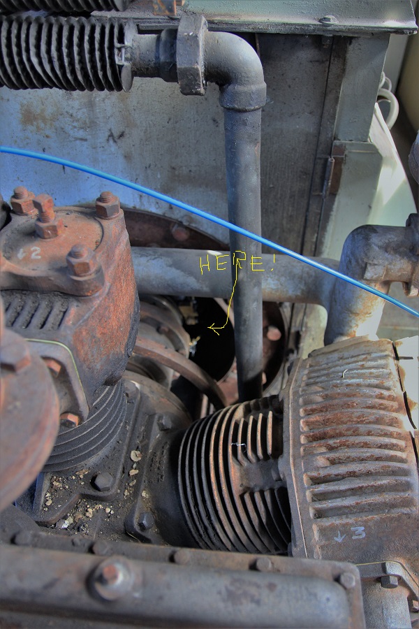

They run on AC power that comes off the main generator. This was also another project. Towards the front of the generator are a set of brushes/slip rings that provide the proper current, they were missing  , and needed to be reinstalled. Not an easy place to get to (thanks GM). This pic shows two of them in place.
Here zoomed out a bit.
And now the whole generator / compressor work area.
Just loads of fun to do that.
