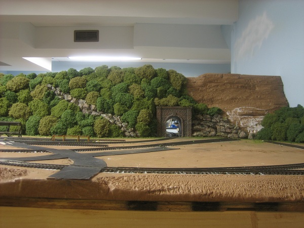

As part of the hillside in Easton. There is a tunnel portal for the Bangor and Easton electric Railway. It's prototype was a trolley line in north east PA that to the best of my knowledge, had no freight interchange and was out of business by the mid 50's. So I felt that the Anna lines should be It's parent railroad and give it the duty of forwarding freight between the CNJ in Easton and the SH&D at Bath Junction (the other side of the tunnel).
I wanted to add the companies initials to the keystone of the portal witch is a poured plaster cast from Wood Land scenics. This proved to be quite difficult to pull off.
I first tried dry transfers applied to the casting to use as a stencil, but the act of rubbing them on scratched and chipped the keystone. After repairing it with plaster and sanding it smooth I just drew it out by hand. [Image: 20110703125628.jpg]
I scribed over the pencil lines with a sharp #11 blade and painted the portal with washes of craft paints; Burnt Sienna, raw Umber, and all those other Bob Ross collars. Scribing those letters was no easy task. the plaster tended to chip and crack Nope. After a few tries I felt that this would have to do. Although not as need as I would have liked, he portal is in the background and will be partially blocked by buildings. so this detail will not be in the forefront [Image: 20110703142515.jpg]
For now I just placed the finished portal in it's rough location for the pic so you get a feel for the scene.[Image: 20110703135239.jpg]
That looks great e-paw Big Grin Big Grin
Really fine the way your careful colorizing brought out the texture and "mass" of the stone work. Perhaps next time, for the keystone, a styrene face/overlay would be easier to "chisel" in the legend, as the texture is less important than the lettering, and your dry transfers would work better, as a guide ? Just a thought - impressed (as usual) with what you're doing 1 Bob C. Cheers

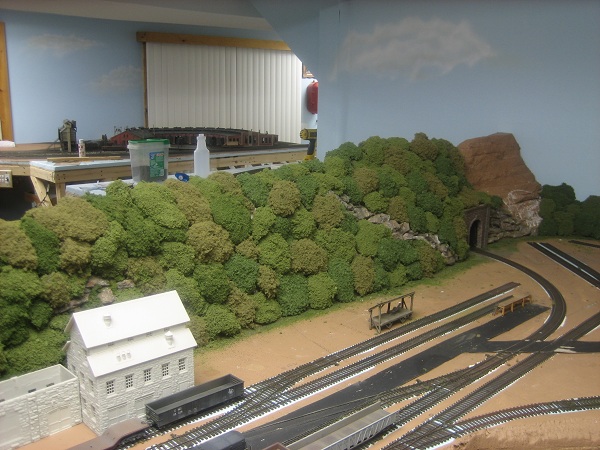

Trees, Trees, & more Trees..The arborist are working hard to complete the hillside in Easton. The project manager says that He expects the planting to be finished tomorrow.
Nice!!!! They're growing some great scenery for your layout! Big Grin Big Grin Big Grin

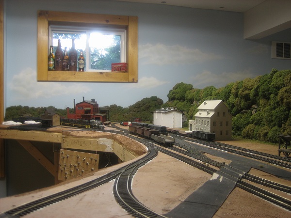

Looking good on the trees...I hope the project manager told you that the trees would be done before he added to the window dressings in the first photo Cheers Cheers Cheers
Keep us posted on your progress!!!
Be Wise Beware Be Safe
"Mountain Goat" Greg
https://www.facebook.com/mountaingoatgreg/
Thanks Goat... If you look closely, you'll notice that the window dressing consists of Czech beer and Russian wine bottles. Cheers
