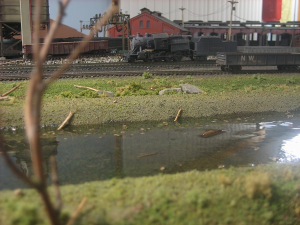

Just a quick pic of some other scenery that I have been up to.
I added a section of the abandoned Delaware canal just east of the roundhouse in Riegelsville. The location that I chose to plant my round house is actually the location where the engine terminal for the Quakertown & Easton Railway once stood.

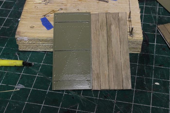

The doors are styrene with rivets and bracing to look like steal on the outside, the interior surface is heavy wood planking.

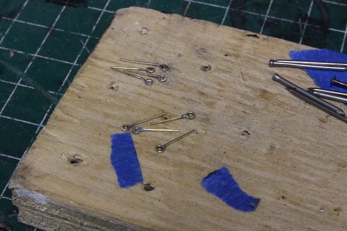

Now for some hinges and hardware.     I started on the hinges by bending and soldering brass wire to make a hook These will be attached to the interior surface of the doors and a pin attached to the building to hang the doors from. I'll add latches and grabs latter, once that is finished I can weather the structure.

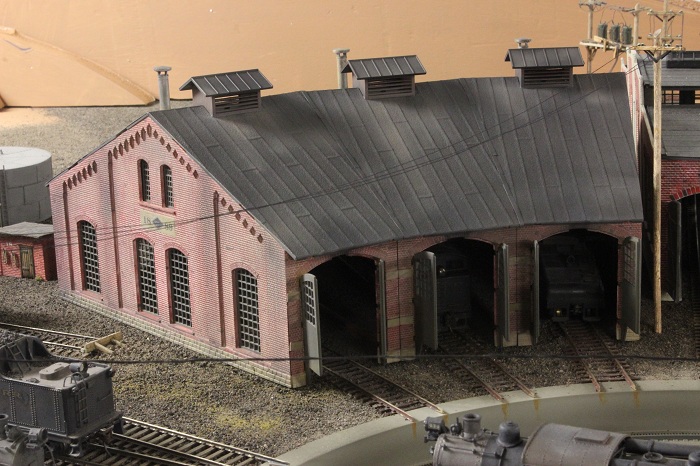

The rear doors are all mounted and the window glass is in..     I showed them here with one open and the other closed. This shot was taken from the future site of the back shops building.
The weathering is also complete, I wanted to weather it heaver then the rest of the structures in the terminal, as it is an older building. With a date of 1889 makes it about fifty plus years old in the mid forty's time period that I model (roughly 1943 to 1953).
So here are a few pics of it in place.
Looks good, Steve. Thumbsup I like the muted colours you've chosen, too - it looks old but nowhere near derelict.
That's exactly what I was looking for Doc. Big Grin

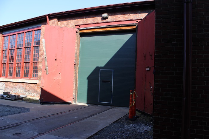

While I was over at Steamtown today working on the DL&W f-3's, I took a pic of the prototype That was my inspiration for the rear doors of my Switcher barn.     The roll up door and the concrete walkway are not original to the roundhouse, but the track that leads out of it and into the shop building is. At one time there were several spots where the two buildings were connected, Now there are only two.
Man, that looks awesome Steve, great work!
