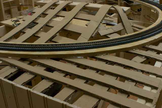

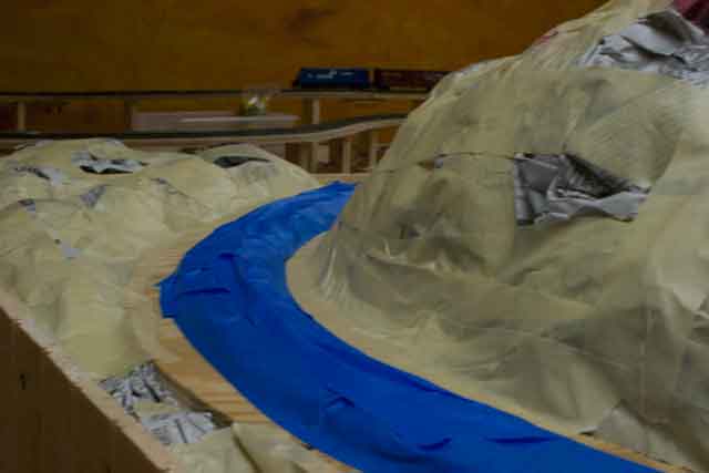

Been awhile since I've posted some progress... actually for awhile there, I was unfortunately making very little progress... but over the past two weeks or so I have gotten back to the basement and started working on one of the corners of the layout and thought I would share.

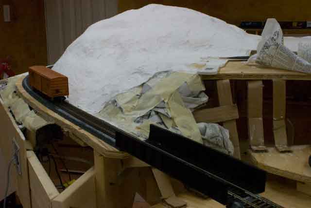

Cardboard and framing underneath
Newspaper and masking tape
Plaster cloth and Sculptamold

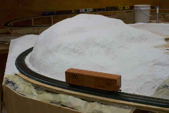

More plaster

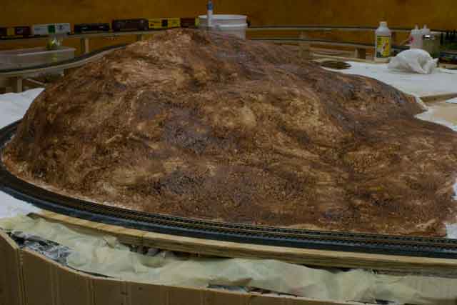

"Dirt"

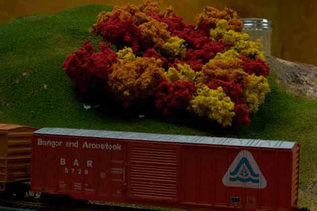

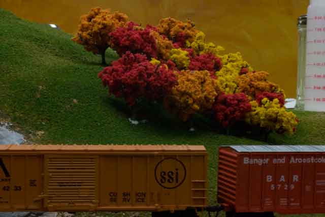

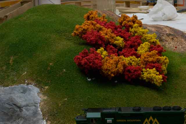

The start of the hillside of fall foliage

Trees

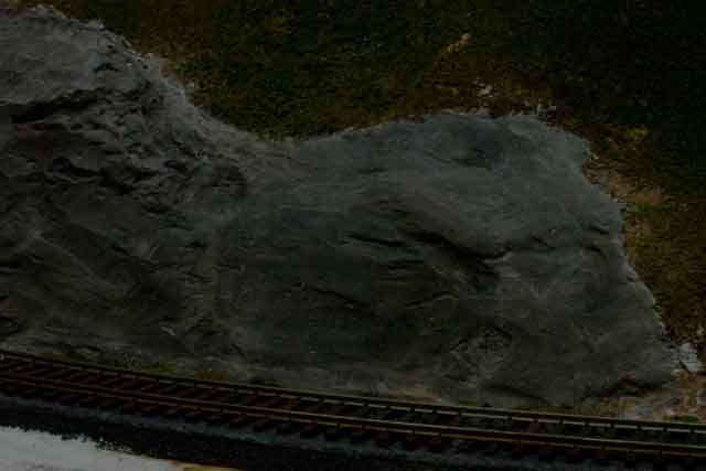

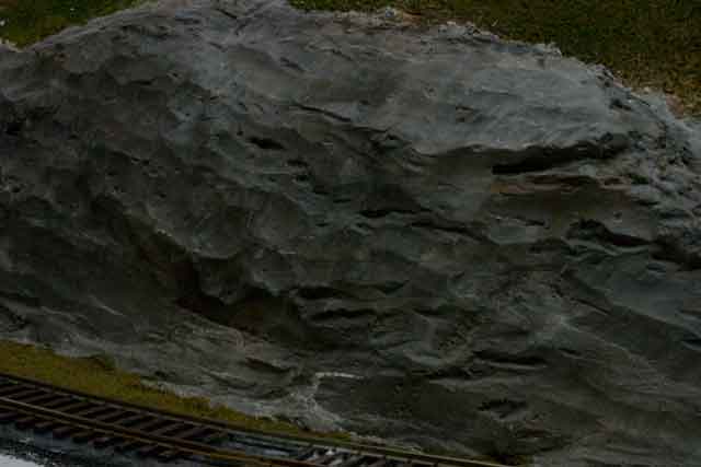

Hand carved rock
More hand carved rock

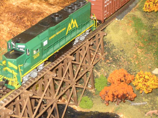

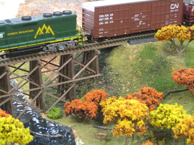

The rock along the side of the hill was an experiment with hyrdocal... I didn't want to place multiple small rocks but rather wanted one long continuous rock as if the rail right of way was created by blowing out the hill. I took hydrocal and used a spatula and "frosted" the hillside like a cake. I let it dry and then ran some different sized metal scrapers over the dried material and then colored it... I like the results and plan to use the technique on the gorge where the plate bridge is... actually I also plan on removing the plate girder bridge and replacing it with a trestle.
The hill will be full of fall colored trees... I just need to make them all

Looking good Rob!
A hilside of those Fall colored trees will look spectacular!

I've just quickly looked at your pics and skimmed through the first part of your thread. I'm jealous, that's an awesome looking layout! I wish I had woodworking skills like that to design such an impressive layout. Please keep us posted as and when you add scenery.

That hillside looks incredible! Your rockface is very well done! Your trees look great together! Keep up the excellent work!

Rob-- Thanks for the compliments on the woodworking, but I have to admit, I think my woodworking skills are terrible! The one thing I did with this build is I took my sweet old time putting the benchwork together... as much as I wanted to get track down and trains running, I made the commitment to building a stable foundation that I felt would pay dividends in the long run (not to mention my wife told me I am not allowed to break this train down and start over)... I used some of the principals of the classic L-girder and other open grid styles melded into my own creation and I am happy with the way it came out... that all said, I don't think I'll be quitting my day job to become a carpenter
I have added about 20 more trees to the hill... about 200 to go!

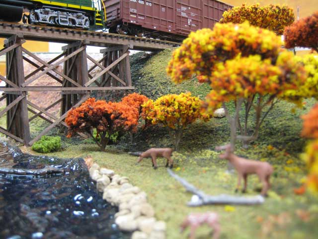

The tressle came out great.
