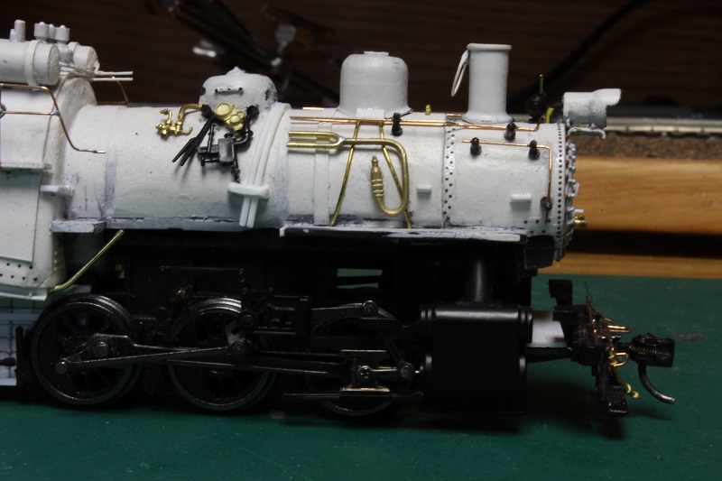

Well Doc you will get your wish soon. Here she is as she stands now. The last of the details have been added, just waiting for the glue to set completely so she can be washed in prep for painting.
In this pic the cab interior has been added. If you're after a prototypical camel back interior, pics of them are hard to come by, I did leave a bunch of things out because they interfered with removing the cab for painting, placement of the engineer ,or just plainly could not be seen. Also in this pic are a few steps that I added to the side of the boiler, handrails, a lagging clamp, and an extra step under the running board.
In this front view I added a grab at the lower part of the smoke box front with a step off to the left. the steps under the walkways are also visible.
As for the brakeman's side, the handrails and the firehose compartment have been added.
I blew up this pic to try to show how I mounted the walkway steps. The arrow points to a pin of brass wire that passes through the step and walkway and held in place with CA. This gives a much stronger bond than just gluing the step in place.

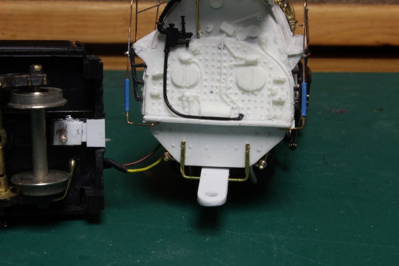

I did not like the heft of the wire of the electrical connection to the tender. It also interfered with the free movement of the tender in turns. I used the same clip and just soldered new wire in it's place. I was trying to get the look of air lines running between the engine and tender, and I feel it looks much better.
In the next two pics I show how I fabricated a new draw bar. Styrene was cut and laminated together, drilled and cut to length to form the actual draw bar. It was mounted by a 2-56 screw to the engine frame with washers and a brass sleeve over the threads. I bent a hanger from brass to help support it. I did manage to emboss a few rivets into it, but they had to be the smallest ones my riveter could do and are barely visible. On the tender side, a brass pin was inserted into the frame and pads glued into places to keep the drawbar from catching onto anything as it moves through curves.

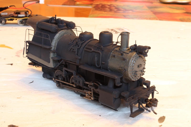

This little 0-6-0 is now dressed in black. Just a quick handheld shot after three coals of black.

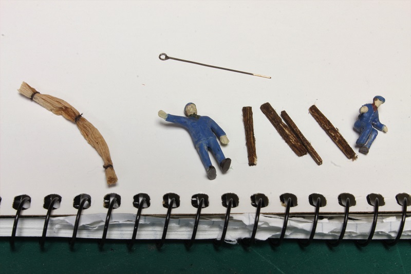

Well work and mother nature are doing the best they can to keep me from finishing this model. I just need one day above freezing, and without rain so that I can do the weathering with an air brush.  :evil:  . As I type this we are in the mists of a blizzard with around 12 to 18 inches of snow on the ground, and plenty more to come. But, I was able to work on some of the details that will be added after the weathering.
we have the train crew, some wooden coal boards, canvas tarp, and coal hook.
