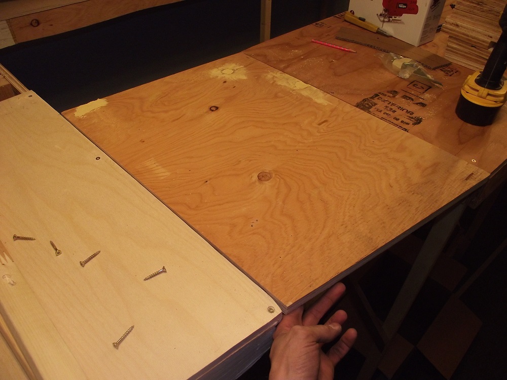

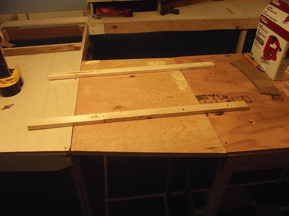

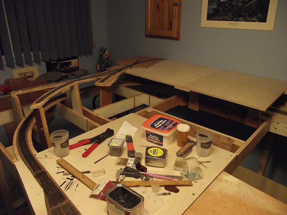

Thanks. I fitted the last piece of the mainline puzzle in this afternoon:

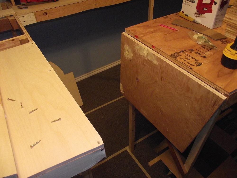

The Drop gate. I cut it to fit the gap on Saturday out of the last of the 3/4" plywood. I figured that 3/4" would be stiffer than 1/2" and wouldn't need more reinforcement. To fit it in I first screwed it across the gap with some spare 1X2's to hold it in place while I installed the piano hinge below.
Now that it's installed I have to add a latching mechanism to keep it up and properly aligned. As it is I will probably have to shim the track that will be running across to make a near perfect alignment.

A bit more progress this week. I added a deadbolt to the drop gate which holds it in place at the correct alignment. That was actually easier than I thought it was going to be. As usual, I was over thinking it. It works well but I may add a second deadbolt for extra security.

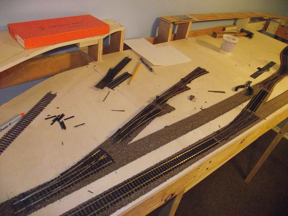

This afternoon I started to layout the turnouts for the mainline:
these are the two turnouts for the larger city's passing siding, and the branchline to the stamp mill.
And these are the turnouts for the smaller town's passing siding and the sawmill's sidings. I decided not to run the mainline as a straight line through this area. Instead I wanted it to mainly follow the layout edge and then 's' curve to meet the roadbed. I think this will add a bit of visual interest while running and gives me more space on one side of the mainline instead of cutting through the middle.

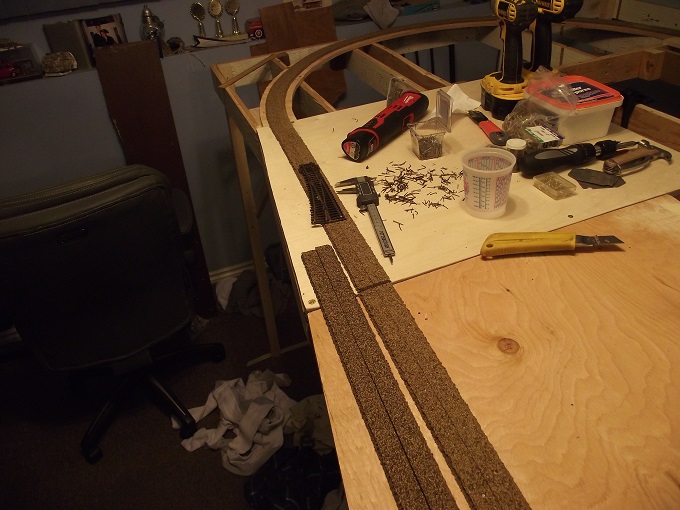

With the mainline figured out I needed to start to laydown the cork roadbed. I ordered some from the local hobby hop last week but when his shipment came in this Friday his supplier was sold out. He told me that it was going to take up to a month to get any new stock it.
Then a friend called and told me someone in the local classifieds listed a bunch of track and roadbed. Long story-short, I got a whole box (25 lengths) for half of what I would have paid at the store. I had already figured out that I would need between 18-19 lengths but it doesn't hurt to have extra.
The plan is to cork the mainline and sidings and lay the sidings and branchline directly on the plywood for contrast.

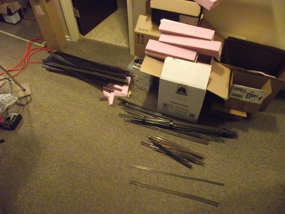

While I was at it, I decided to take stock of my flextrack. On the right is a pile of Atlas code 100 and the pile on the left is Peco Code 100. Turns out I have quite a bit more than I thought. I probably have enough to build 3 layouts of this size. Since I'm using all peco turnouts, I'm going to go with their flextrack as well. I'm also thinking of handlaying some of the sidings later.
This is how far I got with roadbed laying before it got too late and I didn't want to bother the neighbors too much. I'll continue to tack it down as the week progresses.

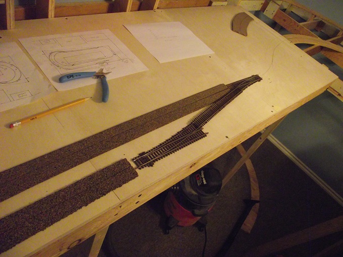

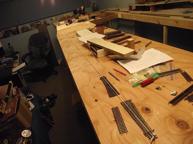

I did some seat of the pants engineering and came up with some ideas for my passing sidings:
This is the smaller town siding end with the turnout for the sawmill spur. I separated the two turnouts with a length of straight track by at least the length of an 85' passenger car. Keep in mind that I'm using peco medium turnouts on the main and passing sidings (approximately #5's) I think this should fix any problem that an 's' curve using turnouts could cause.
Now I've turned my attention to the passing siding on the other side of the layout:
The main line through here is a straight line so I used a string to mark the center line for roadbed laying. I had initially thought that I could put my station on the outside of the main and run the passing siding on the inside. Turns out there wasn't enough room for the station but there was room for the passing track so I'm going to swap the two around:
this will give me something similar to the other side.
This will also give my the exit from the passing siding to the stamp mill/logging branchline.

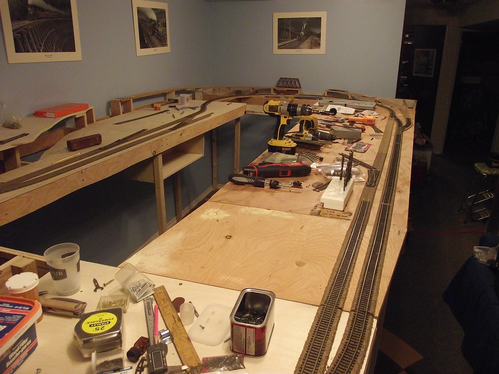

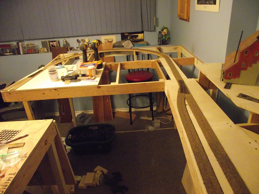

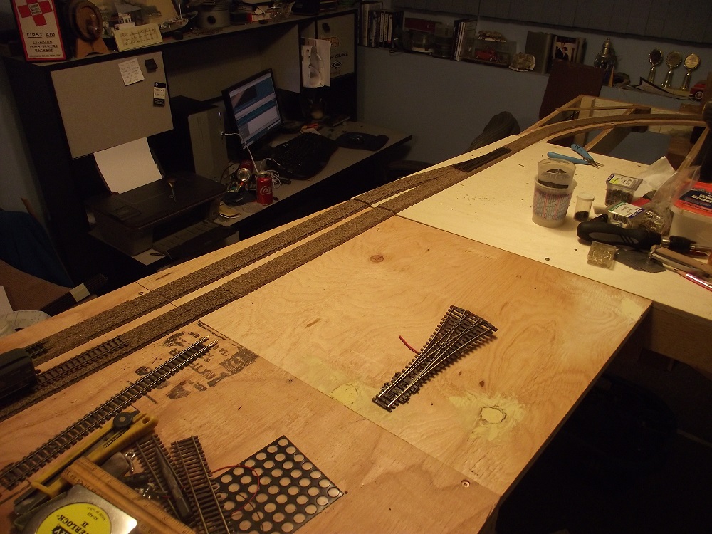

I have a couple days off so I put the first one to good use today:
I laid all the cork roadbed for the mainline and passing sidings.  I first laid the mainline then fitted the sidings in. It's been a long time since I did this so I went online to figure out the spacing between the tracks.  A few sites said that I could get away with 2" between track centers but I decided 2 1/2" would look a bit better and give a bit more breathing room. I checked it with some spare pieces of track and a couple cars.
The end of the city's siding with the stamp mill spur. before track laying I'll have to bevel/slope the roadbed to the plywood. I also placed a few turnouts loosely on the mainline to gauge where to add the yards and city sidings. Still working that out but the cork gives me a good visual reference for what I can do.
I also have a much better idea of what the sawmill end looks like. I also will be sloping the cork down to the plywood for the sawmill spur. I also noticed that the cork has some rough and uneven edges. I'm going to run my mini sander over them to smooth it out.
looking toward the future logging line. I need to get the track laid on this end before I can re-attach my HOn3 branch above it. Then I can also extend the upper line past the stamp mill and to the logging camp.
I'm going to add a second deadbolt to the drop gate. I need to lift one side up about 1/16" to get the perfect alignment for track.
I'm thinking of adding an enginehouse on the opposite side of the gate, but not using the turntable. a friend gave me a peco three-way turnout that I'd use instead.

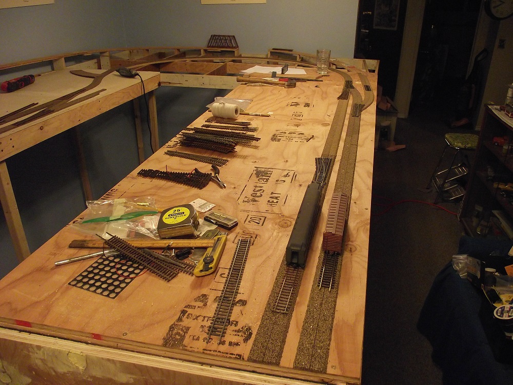

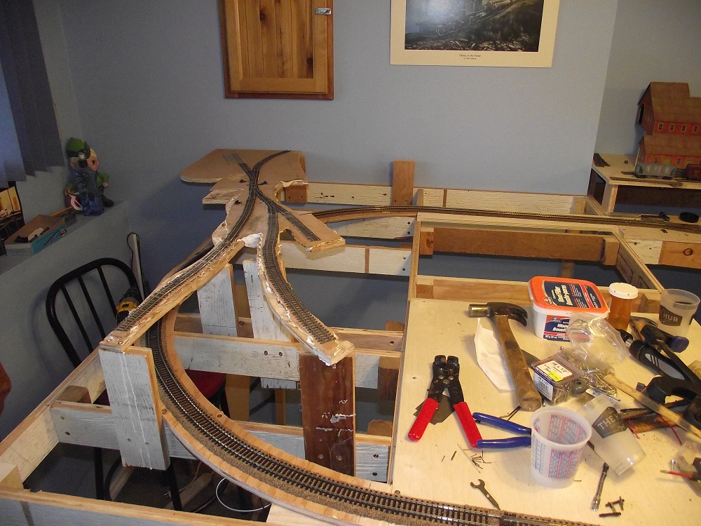

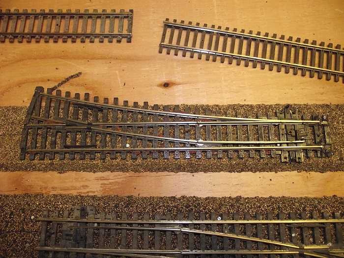

Well I didn't run the sander down the roadbed except to level out a few places on the top. Instead I started to lay track:
I started with the 24" radius end. I'm using all peco flex track that takes a bit of work to get it around corners but it will curve nicely if you are patient with it.  Unlike Atlas track there isn't one track that slides easily so I did solder the joints in the curve.
Before
I'm using recycled Peco turnouts both salvaged off my previous layout and given to me from another modeler who  switched his entire layout to code 83. I had to refurbish the turnouts a bit due to insulating cuts made into them when my friend's layout was converted to DCC. I had to do something similar when I converted my former layout as well.
After. I had to cut the ties back a bit and add new track nail holes in them all.  They are still pretty much intact, just a bit shorter.
And now that the one curve is in, and checked with both a rail car and an NMRA gauge. I was able to re-install the HOn3 section above it. Now All I need to add is the joining piece between the stamp mill and the narrow gauge.

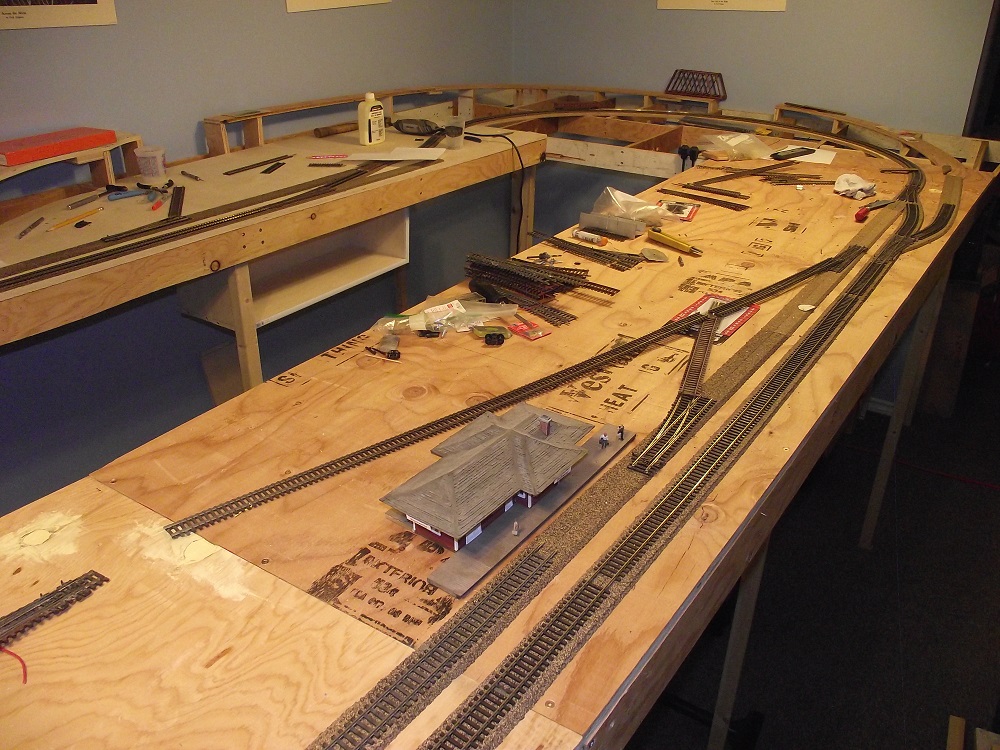

I made some decent progress over the past week.
I laid quite a bit of track, starting with the drop gate.
I had to add a second deadbolt lock to the one side to get just a bit better alignment. After that I ran a couple cars across with no problems.

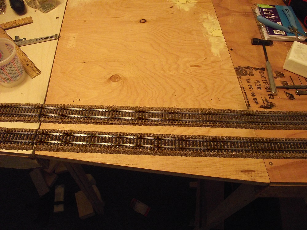

After that I laid the track down the passing siding, through the 30" radius curve on the other end and through the other turnouts. I've continued to solder the track together around the curves to make sure the rails stay together while curving the flextrack. I haven't laid the other straight mainline track yet as I'm not sure where I'm going to put the turnouts to go into the yard/ industrial sidings/ enginehouse quite yet.
