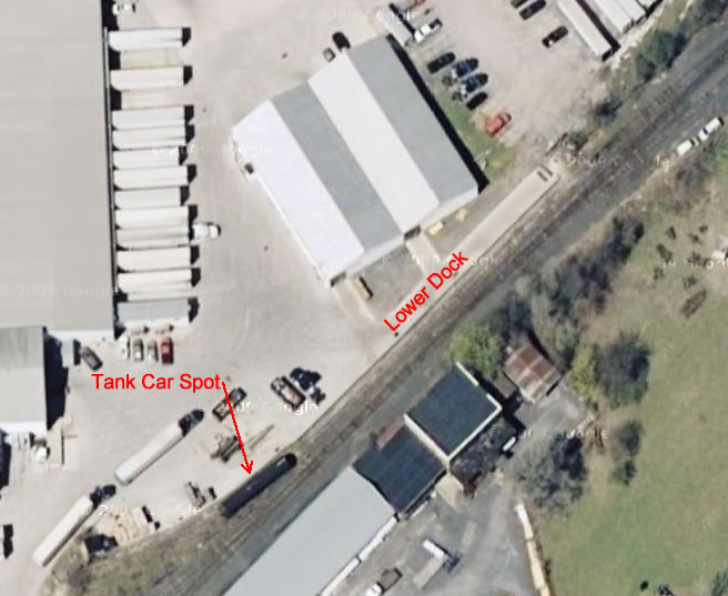

FCIN had a great idea about the tank car unloading spot. Maybe you may not want to add a second track, but to add a spot on the spur with tank car unloading pipe and some tanks would be something that I would consider.

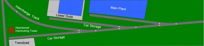

Justin;
Per Mike's (and my) suggestion; would a revision of the main section of your layout something like this work?     I'm sure I don't have the dimensions correct for your bench work, but I think this would more closely resemble the actual facility and give you more operational potential. This is what the actual "lower dock" looks like and shows where the tank car would spot:     The former main line which has the transload and car storage is not quite as long as per your plan, but you'd also have room to store a car or two on the lower dock track.
I know that everything is compressed and you may not be able to spot as many cars on each of the Inland tracks as you might like, but we always have to do a lot of compression to make things fit our limited modeling space. Since this is the major industry on your plan, which would have to be switched daily, having the two tracks just would provide a lot more switching potential in my opinion than the single track. Of course having to line up your cars on a single track also requires a fair amount of switching, but this arrangement does look just a little more like the prototype.
Just something to think about and I'm sure you can work out the details to fit your bench work much better then my example. Once you get your track (and foam?) you can try out different configurations for this part of your layout and see what works best for you.

Ed, It's a great idea, I just prefer to keep track plans simple. I would just leave it at one track for two reasons. Railroads would usually prefer to add one turnout and to just add a wrinkle into the switching game.
Like I said, if you put a highway overpass on the left end and some tanks to the right of the plant, that should do. I love the interlocking tower. That would go beautifully under the overpass for some great photo ops.

I too like simpler track arrangements and actually prefer a situation where you have a single siding with multiple car spots where cars must be placed in specific locations on that track. Even two different industries on the same track is quite prototypical and adds another wrinkle to the operations. I worked many such situations on the prototype back in the "Good Old Days". Can make for some very interesting switching and rather time consuming at that. I have three such industries on my ISL right now and it takes a surprising amount of time to switch each one of them. Pull this one, spot that one, re-spot another one, etc.
Since Justin's plan appears to be a mirror image of Jack Hill's layout and basing the industry on the plant at Biglerville, PA, to me, it would be just a bit more prototypical to try and get a similar track arrangement to the prototype. The choice is of course entirely his, not to mention fewer turnouts equal less expense. I do think he should at least change the turnout for the container plant to a right hand and make that track as long as he possibly can, just so there are ample car spot locations. Could even have a left hand turnout at the end of the curve in order to make the track longer and still have plenty of room to work the facility.
I like the idea of having the highway overpass on the end of the layout too. Helps to disguise that end of the layout and is something that I'm incorporating in to my own ISL. Makes a nice separation between the main layout and the staging track area.
The abandoned interlocking tower could be the railroad offices if Justin wants to operate the layout as a separate company too and it would look good semi-hidden under the overpass. I'd also include a dummy signal still standing guard over the now removed crossing.

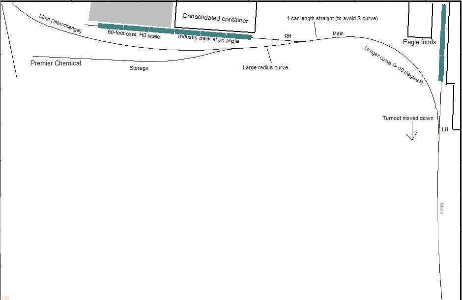

Thanks for all of the input guys!
Mike, I tried making the Container spur with a right-hand turnout and it didn't look to good, it had the same capacity of the left-hand version, but it created an s-curve that was pretty unsightly. I do agree with you about having a single spur, it works alot better than the 2-spur version for me.
Justin Miller

Justinmiller171 Wrote:Thanks for all of the input guys!
