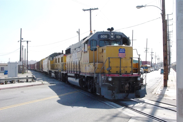

A lot of RR's would have a flagman direct/stop traffic while the train was working there.
Posts: 5,263
Threads: 195
Joined: Apr 2009
Tyson Rayles Wrote:A lot of RR's would have a flagman direct/stop traffic while the train was working there.
May be this setup is simple and prototypical. I did find the W. St. Ana Street Anaheim, CA with a similar solution to get the track on and off the road. Covering three tracks on the vertical road all together with two gates is simple and logical to me.

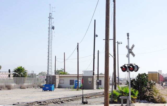

That is the signaling of the intersection with three crossing tracks I choose. One more will be set where the track exits the road center into the industries.
