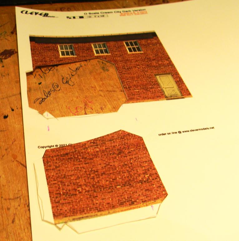

and then decided to attack the cardstock portions of the front face first - the brick sections nearest the front corners including doors as the first priority. I found a 2-story section of brick from the Cream City kit to use as the brick for those sections of the building and used solid doors from that same kit. Since the shopper doors are transparent, I'll use the ones I just built from the Central Camera kit. I also need to remember that my front face will be a mirror image of the prototype - the shopper doors will be on the right corner, the solid doors on the other side. I'll be working on these brick sections and adding the doors which will take some time.

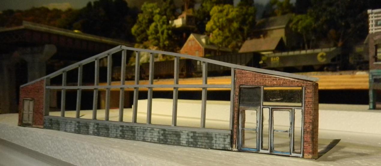

I recalculated and arrived at a total width of 76 feet wide and 12 degrees of pitch on the roof - smaller the better if I'm going to shoehorn it into the space available. Built the cinder block wall that ties the brick corner sections and joined the pieces. This is going to be a large building... Got a headache and need a break from the magnifiers. I will probably get a chance to put the plastic frame together that will serve as a support for the transparent sheet that'll go from peak to foundation tomorrow.

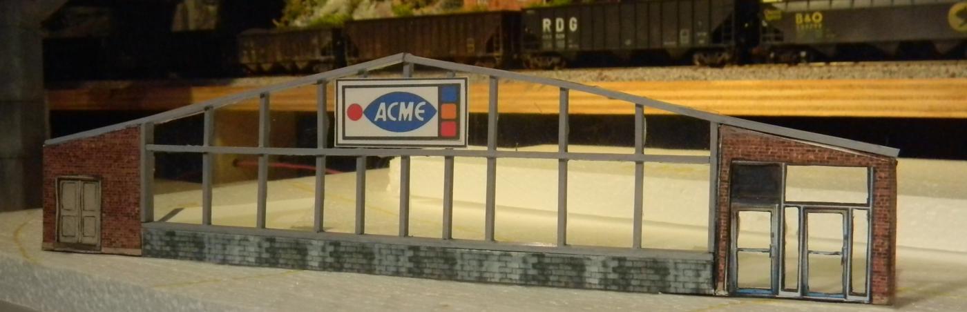

Added the larger frame elements to the front facade. The smaller vertical strips are next followed by some paint touchups and gluing in the glass sheet as well as the signage.

First coat of paint got slapped on the window framing after installation of the last piece. I'll hit it again with an additional coat tomorrow before adding the window glass and signage.

Progress on multiple fronts. Signage and window glass have been installed on the front face of the ACME. There's a covered porch that will have to be built over the automatic doors on the right side at some point, but I'm moving on to side and back faces of the building, which are all going to be cinder block with some doorways.

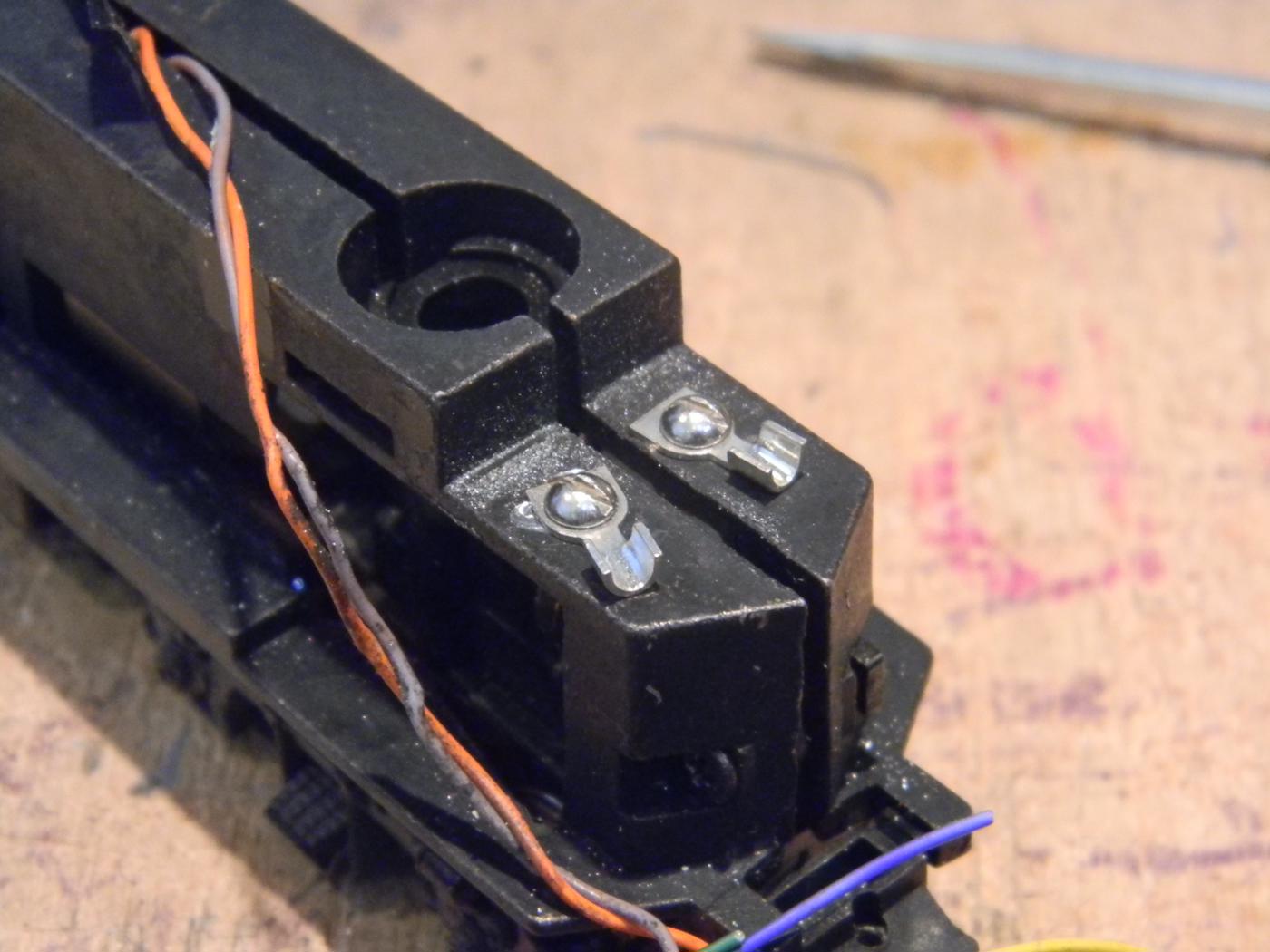

I also tore down the Penn Central GP30 for the purpose of installing LED lighting. After pondering the options, I elected to completely rid myself of the existing electric board that rode on the halves of the chassis to pick up track voltage and dispensed power to the incandescent lights.
Replaced power pickup by drilling a hole in each side of the chassis and installing two machine screws and nuts with an electric pickup on top (got this idea from Charlie many moons ago and put it into practice).
Got humpty dumpty back together and I hope to reweather it later today.

Todd, when I have done those split frame Bachmann's I like to isolate the frame too. I cut the clips that transmit the power from the track and soldier wires direct to the trucks and run them up through the center gap directly to the decoder. I isolate the decoder on a thin sheet of styrene. That way I don't have to be concerned about shorts to the frame.

Thanks for yet another great tip, Charlie (on the Bachmann frame isolation). I may do just that on the other GP30.

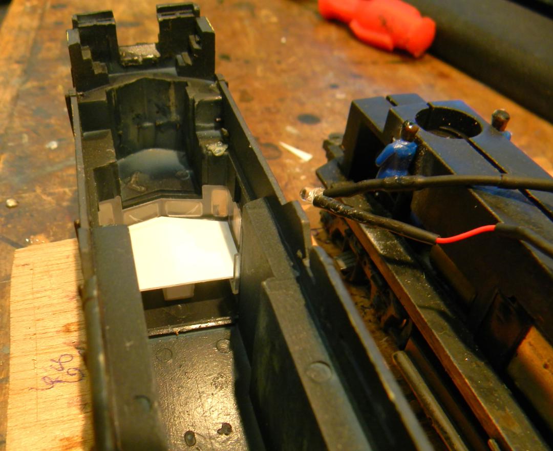

LED replacement went well last night and I thought I'd share yet another method for securing LEDs in the desired spot inside a shell...
Nothing worse than a light that wanders, or one that you can't get the position optimal even after multiple shell removals and repositionings. I also don't like too much light in the front cab due to spillover from the headlight. I've previously shared building a ceiling between the cab and the headlight space, and I did that again with each GP30. Stuffing the headlight up there was too inexact, so I found that gluing in a short piece of Plastruct 1/4" hollow tubing (either to the false ceiling on the shell) really worked well with my 3mm diameter LEDs (both for the front and rear headlights) - you just need to put a little bit of force to slide the LEDs and connected wires into the tubing. Still left plenty of space between the metal chassis and the top of the shell.
