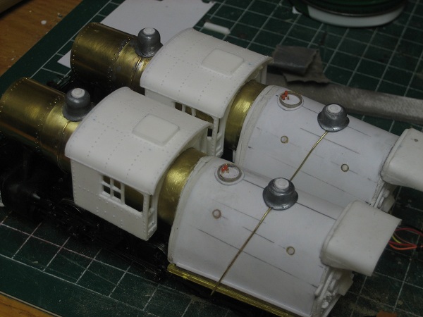

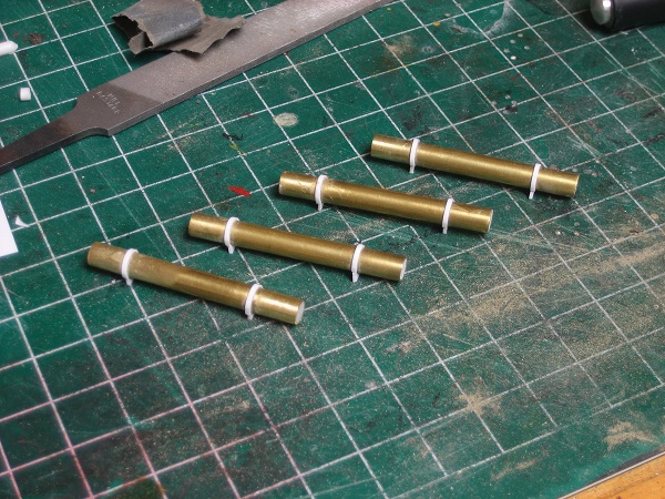

I'm a little late on my posts so this is what I did last week.

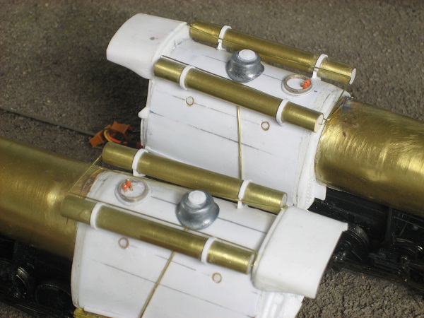

The air tanks and piping have been installed.

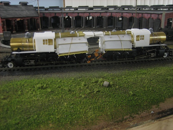

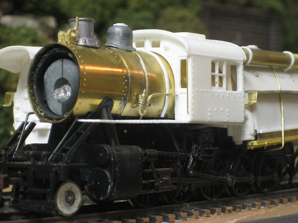

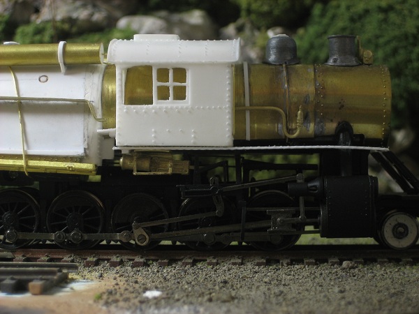

Just a quick update... I finished up the walkways on the two 2-10-0.
I am having trouble finding a set of stacks for the pair,, not sure what to use yet. And yes I am aware that the grabs in the fireman's shelter are not the same. the castings have warped a little when they cured when they are not parked end to end, ( as if there is a reason to put them that way) it is not that noticeable.

Beautiful!! The cabs really turned out well! Do you still have a lot of work to do on them?

When I rebuilt my Athearn Mikados, I felt that the stacks were a little bit on the puny side, so I removed them. To create new ones, I used some 9/32" brass tubing, adding a soldered-on flange around the top made from .015"x.042" brass strip stock. I drilled through the top of the smokebox to get a more solid mounting, and there was enough of the original cast-on mounting flange left to look acceptable. If you need a mounting flange, cut a suitably-sized disc from sheet styrene or brass - .010" or .015" thick should do if using styrene, and something a little thinner if using brass. Emboss some rivet/bolt head detail on it, and cement or solder it, as appropriate, in place. The easiest way to mount the stack is to simply drill a hole, then solder or cement it in place.

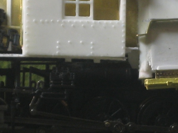

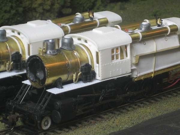

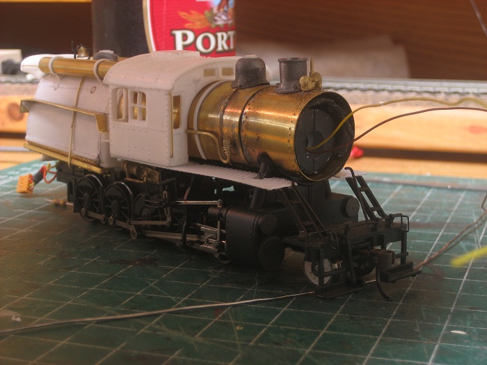

At this point I have installed a few more of the boiler details. For the stack I used a part from Bethlehem car works ( part # 2162). It's a 24 inch high stack with a base that has all the bolt details cast into it. It took a little fitting to get them to set just right. The rest of the parts are from Cal-Scale The generator is part 3 ge-213, the boiler checks are cv-265,and the power reverse is #pr-216.
I had to build a small bracket in order for power reverse to be mounted in the right location. It hangs from the under side of the walkway under the enginers cab. The stack is held in place with CA, the same is for the bracket on the power reverse. Everything else is soldered into place.

Thanks for the remarks gentle men. I reused a few of the old detail parts from the boiler on my camels. The two donor engines ,although the same manufacture and even road name, have a few differences. One was DCC , (I removed the decoder) the other DC. One had cast metal walk ways, the other plastic. The way that the domes mounted to the boilers and even the whistles were different. there are a few other things here and there that are also dissimilar enough to make me really think about witch details to reuse.

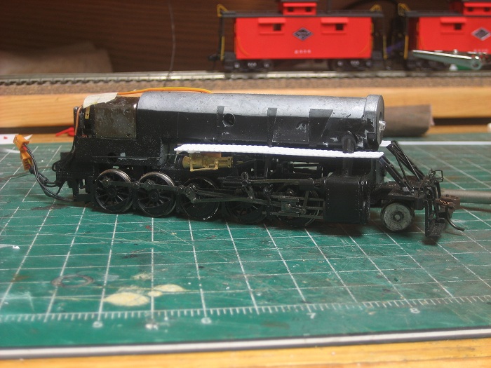

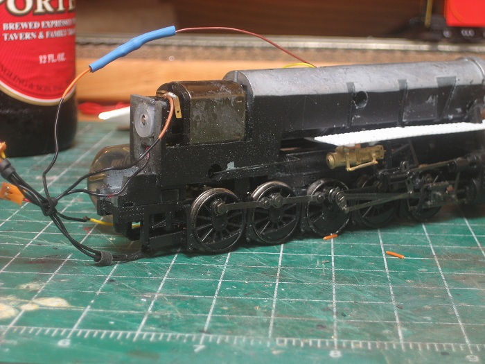

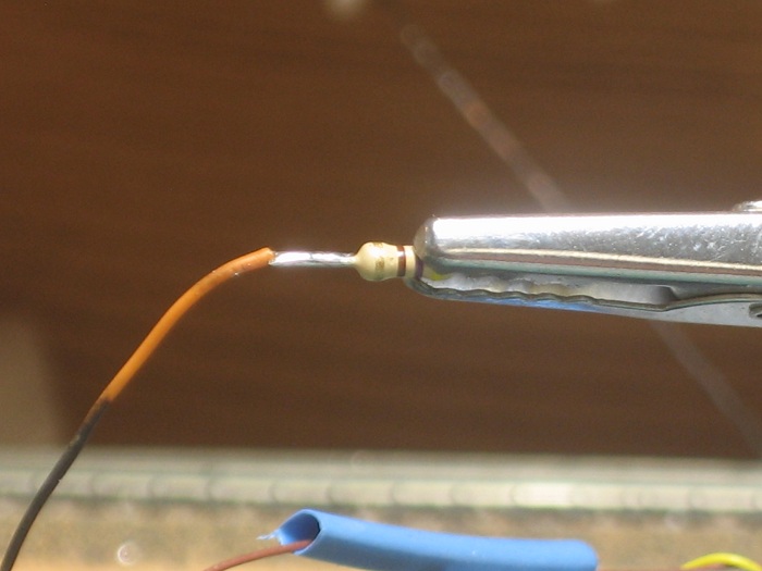

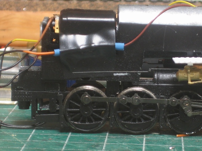

Today I started working on the front end of the boiler, witch includes the boiler front and prepping the electrical connection for the headlight.
With the boiler removed you can see that the headlight leads come up from the Minni plug and pass through the boiler weight at the top. I will use the same routing for my wire, but I will have to add a resister in the line for the LED's that I will be using. The only spot with room enough for it is in the firebox. I cut the stock head light wires and removed the factory head light. Then I soldered on the resistor that the LED manufacturer recommended to it. Next was to solder new wire to the resistor and cover it with some heat shrink tubing.

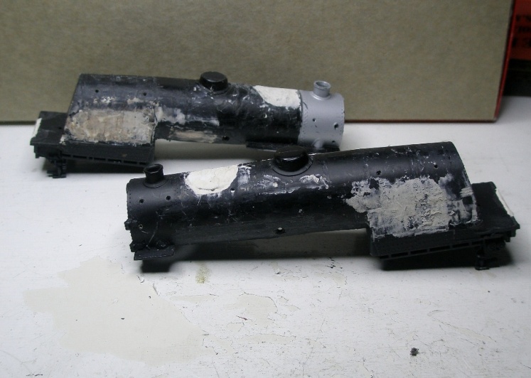

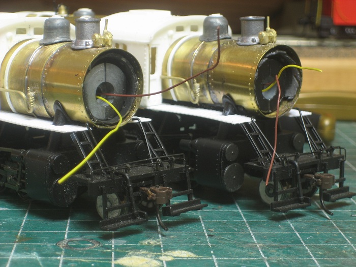

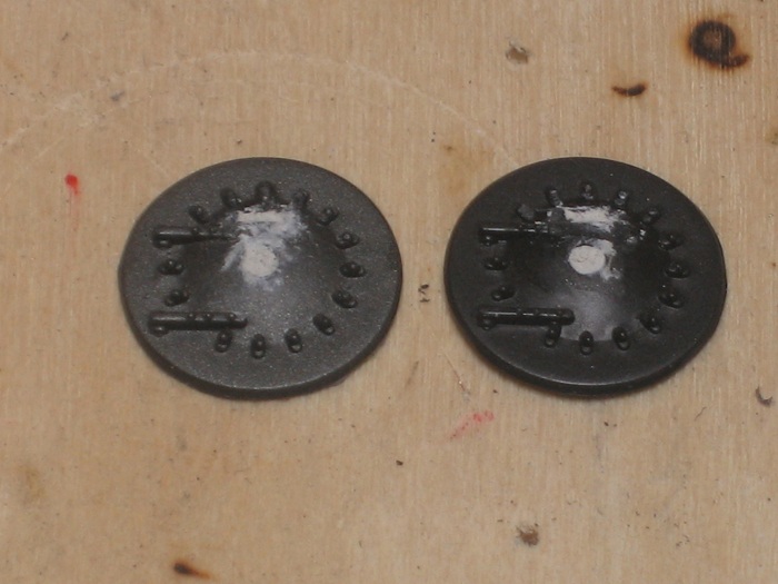

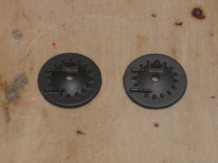

Now that that one is finished I did the same to the other one.

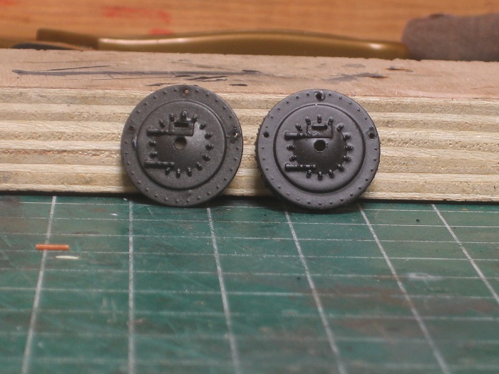

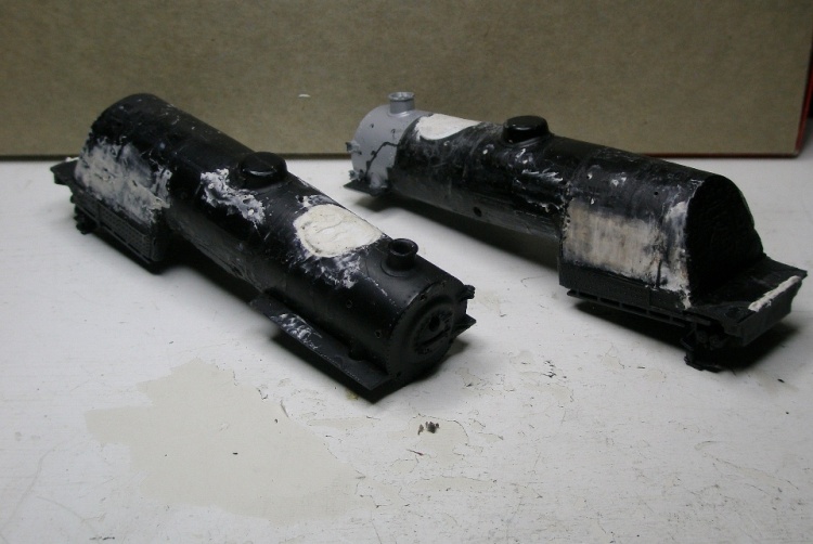

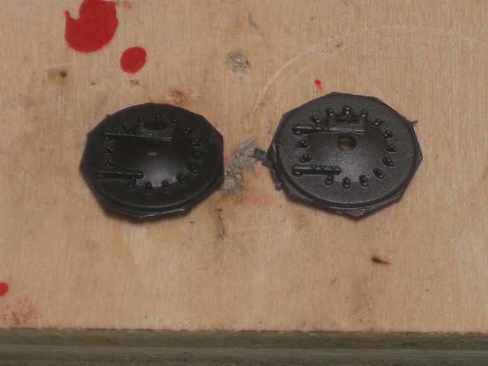

My new boilers are larger than the old ones so I will need to make new fronts for them. I decided to reuse the smoke box doors from the old boiler fronts and make a larger diameter front from brass.. I started by rough cutting the doors from the plastic casting with a small set of rail nippers. I then cleaned off the rest of the plastic with a file until it was down to the smoke box door. I also thinned the back of the casting down to a thinner profile. With the rough work done I remover the old headlight mount and filled the holes with body putty. When it's dry I'll sand it down and start on the rest of the smoke box fronts.
