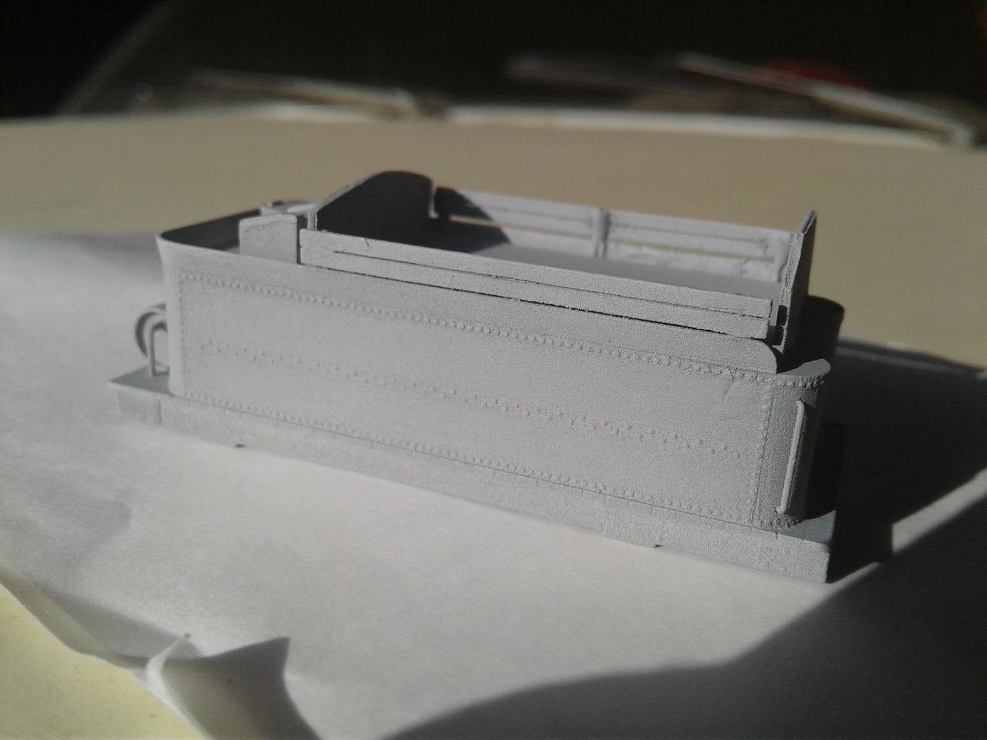

Well, I missed Tuesday, but here is an HOn3 D&RGW class 56 tender I designed and printed on shapeways....

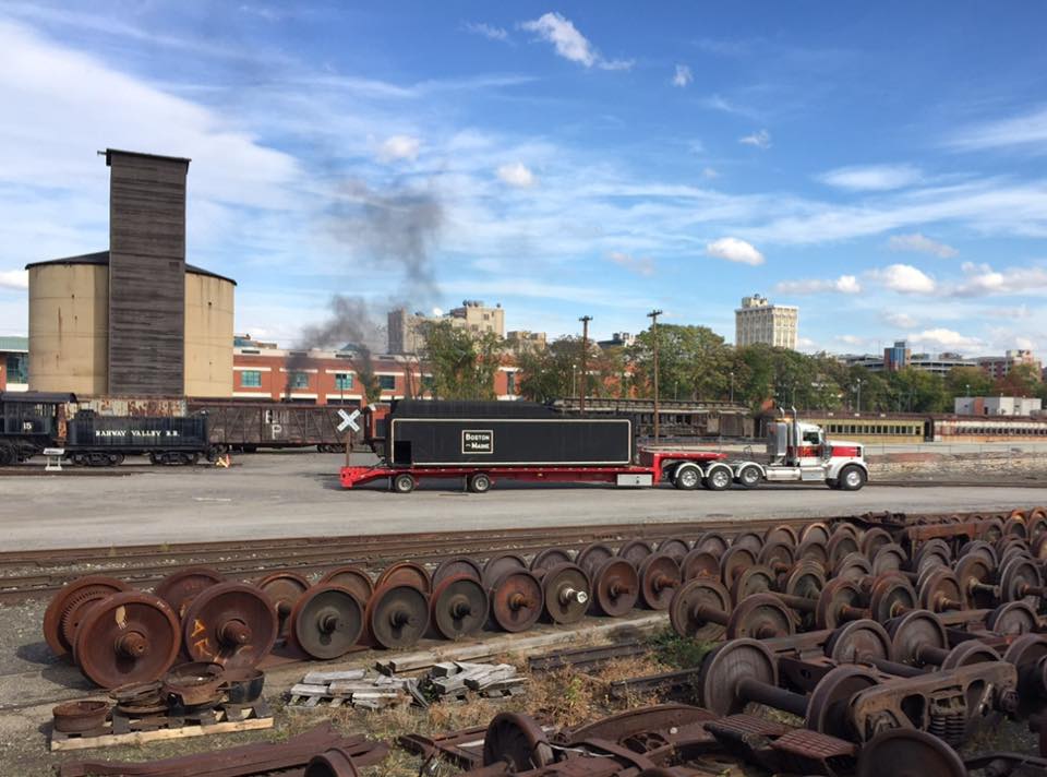

It's Tender Tuesday again.

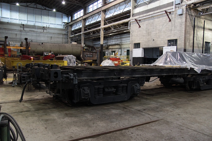

And this week I have more news on the Boston and Main tender going under restoration at Steamtown in Scranton PA.
The tender tank is on it's way to get measured and reproduced as new. In this Rich Jahn cell phone pic It's on it's way off the parks property to a fabricator ( I don't know where ). You can check the Steamtown Facebook page for a few more pics.
As of now the tender frame is still parked in the same location as before. In the pic you can see the wooden planks placed on the steal frame to help support the cistern. Also the front of the frame, where the stoker is mounted, has been encapsulated as some asbestoses was discovered after the tank was removed. After that has been cleaned and the "Historic Structure", as Steamtown calls them, is deemed safe I will get some detail shots.

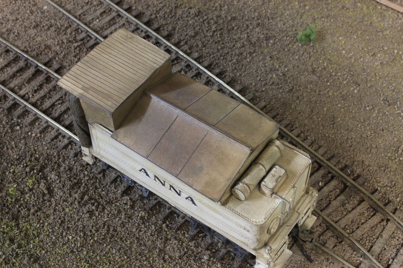

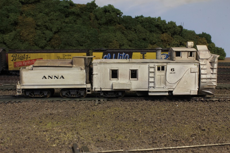

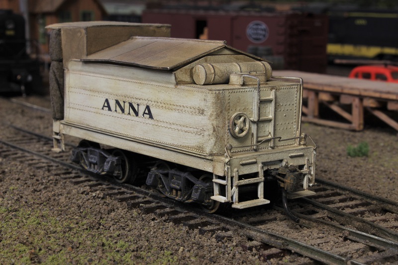

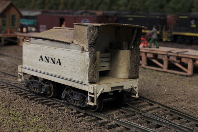

For this week, I have a few shots of A tender that I had built back when I was in high school. :?
It's a Roundhouse rotary snowplow, I was feeling seasonal. Wink
The "canvas" curtains shown in this pic are from a taco bell napkin.
I believe the grab iron near the ladder is a staple. Nope
I built a cover over the coal bunker to keep the flying snow out. But, I didn't take into consideration how the HO holsters would get it off to get the coal in. :o

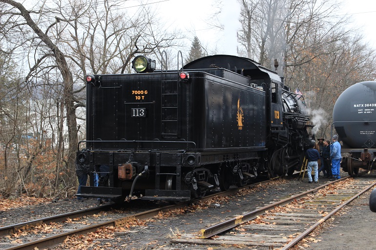

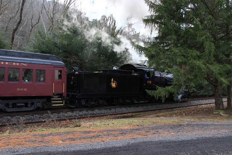

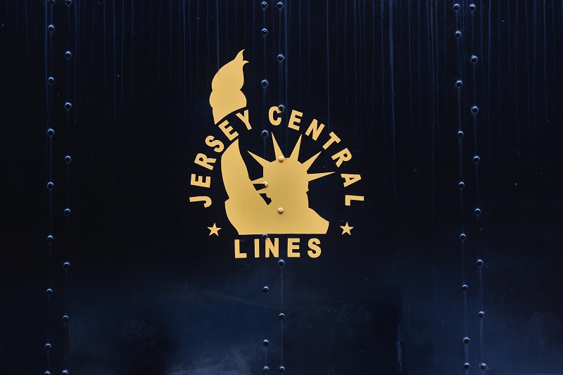

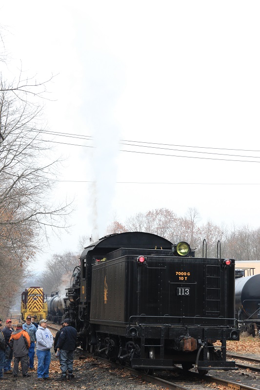

A nicely rendered Miss Liberty herald that belongs to CNJ 113. This tender, and the 200,000 pound loco It's attached to, represents 1/2 of the surviving steam power of the CNJ and 113 is the only operating engine of the two.
A few years back a dedicated group of railfans returned this B-7s 0-6-0 back life, basically under a tent. Just do a search on project 133 if you want to know more, they can tell the story better that I ever could. But for this thread, I will focus on the tender.
Alco put this tender together back in June of 23 and it is identical to the tenders towed behind the smaller USRA B-6 0-6-0's. It's unknown if this is the original tender that was shipped with this engine from Schenectady, as the CNJ had tender swapping down to a fine art. All CNJ tenders had a removable number plate with raised aluminum numbers that were a standard size. It was held in a bracket on the rear of each tender by gravity so that tenders could be quickly reassigned to other engines during servicing. Nowhere on the tender is the engines number painted. I believe that the number plate has been permanently attached to prevent theft, as it is still the original one. This tender held 7,000 gallons of water and 10 tons of anthracite, Just as stenciled on the rear of the cistern. Wooden coal boards were added to it just before it was sold to the Philadelphia Coal and Iron co. back in 1953 to bring It's capacity up a few tons, they have since been removed to preserve It's as build appearance.

does the tender have a number of its own?
#75
No sir. And the builder number that is normally cast into the frame is no longer readable.
