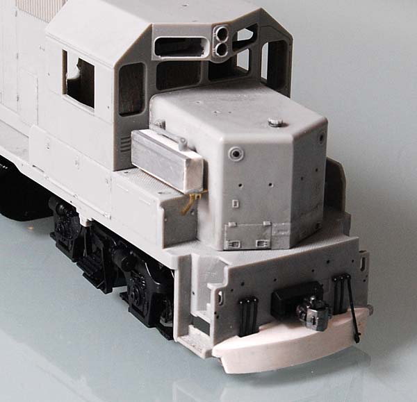

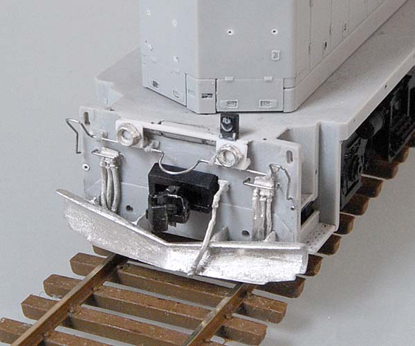

The detail parts for my engine have not arrived yet, so I could only make little progress with what I had at hand. I built the speed control box on the right side of the short hood and I made the snow plow from styrene.

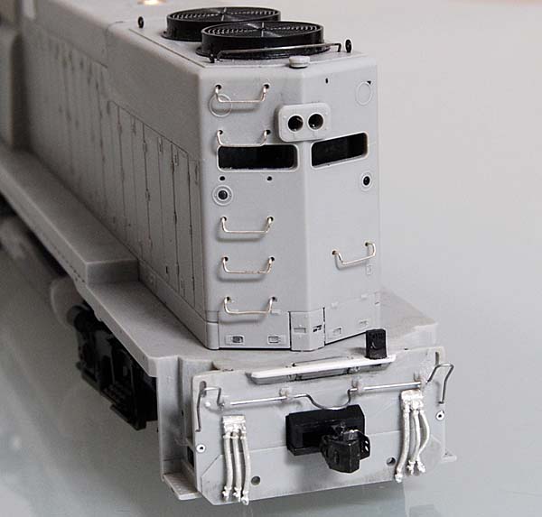

I still had some detail parts left over from previous projects, so I worked on the rear end too. I did not inted to replace the MU hoses when I started, but now I think the Details West hoses look better than the plastic ones that came with the engine. The coupler cut lever is made from .013" piano wire and the brackets are Detail Associates parts. I won’t tell you how long it took to bend the wire and to glue the brackets to the pilot Nope ... it is too embarrasing :oops: Misngth Goldth

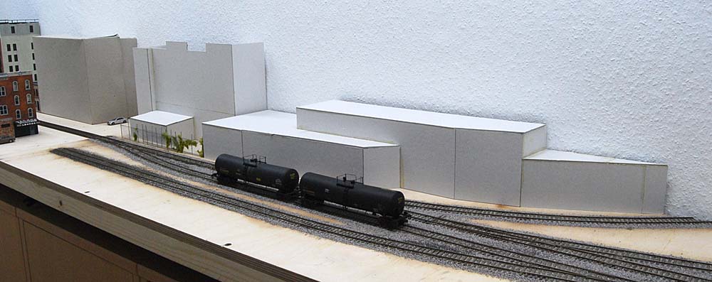

Quite a bit happened here since my last post. I know, I should have posted earlier, but I have a good excuse. I have been too busy modeling Misngth . So here is in brief what I did the last few days.
After putting those mockups (that you can see in the pics above) along the runaround on the right side of the layout, I began to realize that the runaround did not look right. It looked much too short and the big structures enhanced that impression. So I decided to shorten Plymouth Street on the left to add almost 2 ft to the runaround.
[Image: ply24.JPG]
It is looking much better now and Plymouth Street is still looking good.

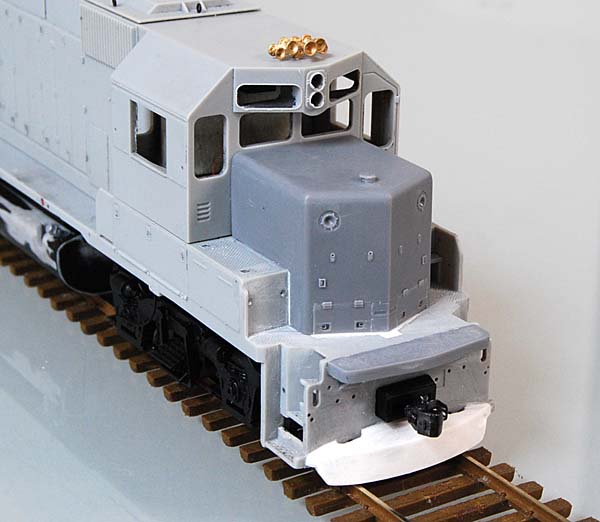

Some parts for my engine arrived yesterday, so I made some progress here, too. I started with adding the missing details to the rear pilot. I really like that weedcutter.
[Image: 268-5.jpg]

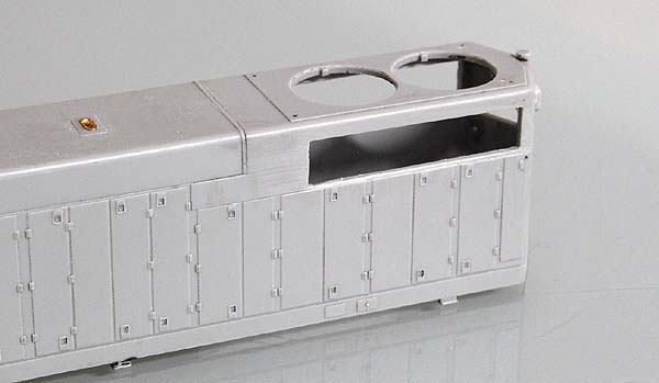

With the new parts, the Cannon Co. 81" nose had arrived. Assembling and making it fit was exactly as bad as I had feared. The Cannon hood is a bit higher than the P2K nose and the cutouts for the battery boxes are longer. Nothing that could not be cured, but it took ages! To add the new anticlimber however, was a piece of cake.

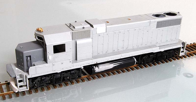

The last step to turn the P2K geep into a mid-production version was to add the wire mesh radiator grilles (Cannon).
[Image: 268-6.jpg]
It is starting to look right now.

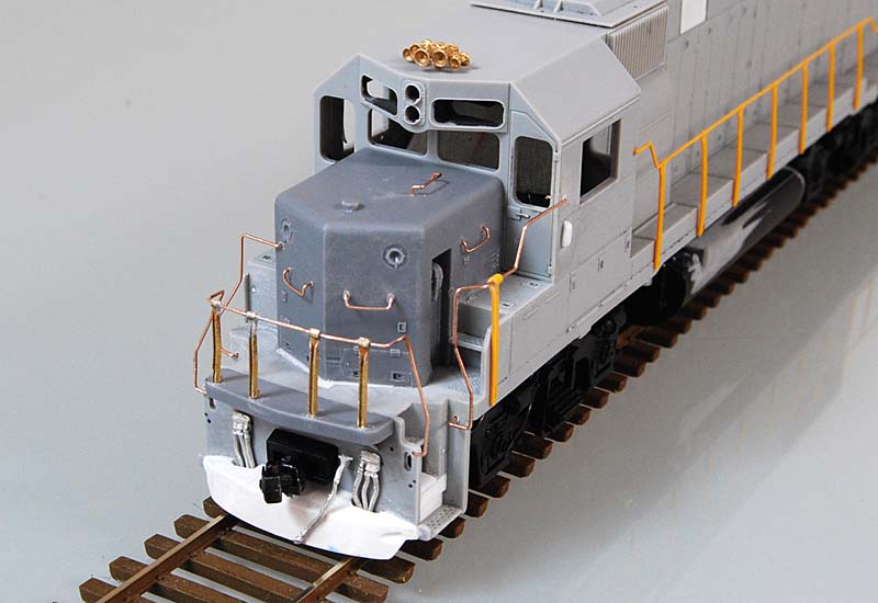

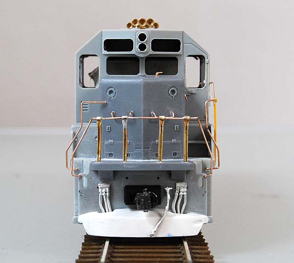

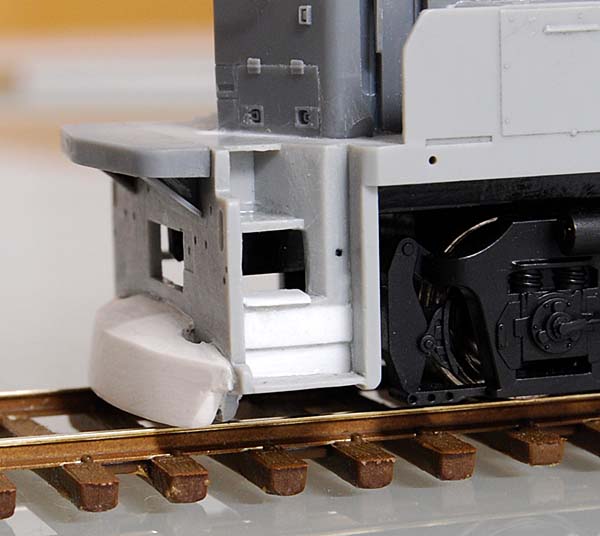

I made a few important steps to make my engine look like the prototype. The step wells and the handrails at the front are quite unique on this engine (as I learned from a very friendly and helpful guy who is engineer on the LIRR and worked with these engines before they got leased to the NY&A). Modifying the step wells was easy, but the handrails gave me the creeps. Defintely not the thing I will remember as the most enjoyable when I will think of this project.
