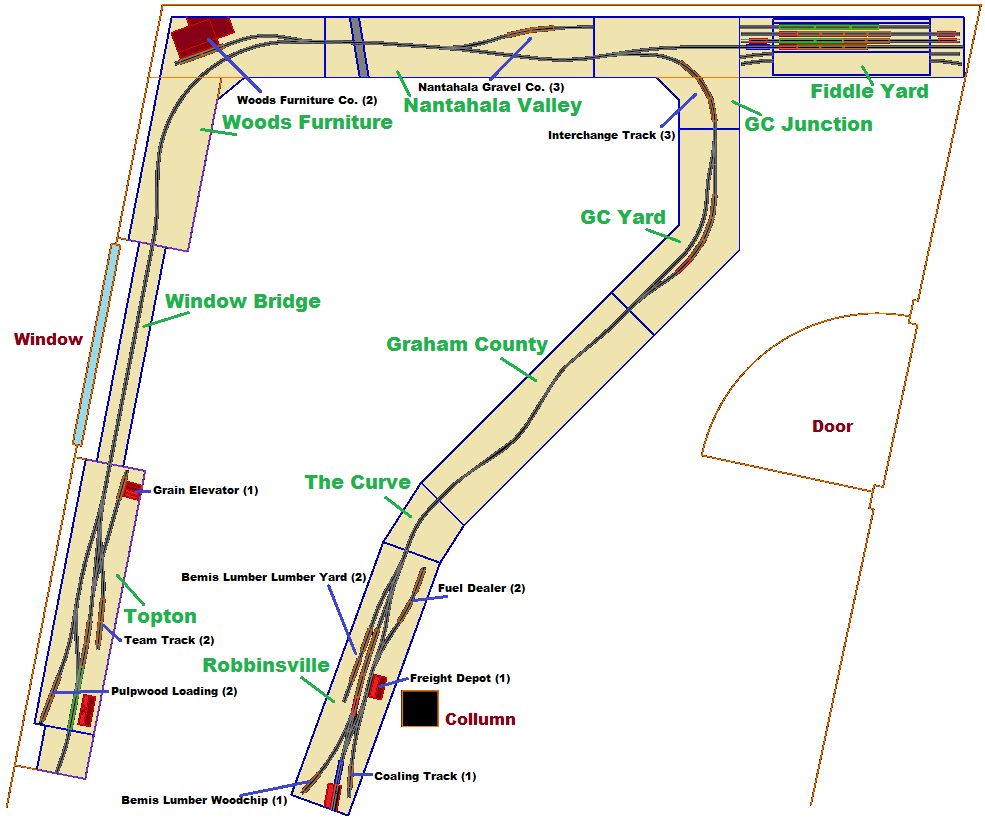

(nein es ist kein Sekt sondern Wein... Leider waren die Weingläser alle in der Spülmaschine weswegen ein Sektglas herhalten mußte) Some people will remember the layout plan in the first post. Meanwhile, many changes happened to my layout. So I'Ve a new one for you. Not as colorfull and nice as the first one, but it will give you a feeling for the layout over all. The upper and left leg of the layout are done or actually under construction. The right leg leading into the room will be added later and represents the Graham County Rairload. I'm not 100% sure with the layout plan at this division, maybe I'll do some changes over here while building the modules. You'll find the names of the modules in green and also all freight spures with car capacity in black. Bye, Gerd

Gerd, very good looking extensions!
I think, a few of tracks could need modifications so that you will have more lenght for a few more cars on tracks. Do you see there a chance?
Cheers, Bernd
Please visit also my website www.us-modelsof1900.de. You can read some more about my model projects and interests in my chronicle of facebook.
04-11-2012, 03:47 PM
Hi Bernhard,
The track length are set particularly for my layout. The Graham County RR will run only 3-car-trains and the Southern trains are limited to 5 cars. I don't have more room for longer trains or tracks. I know that this is very short for US american railroads, but it works perfect for my layout and concept. It all began with Topton and most oft the Southern modules are already done, so changes would call for a complete rebuild. And even in N-scale, 3.6x3.6 meters isn't big. At least, I don't need endless trains. I like it to run short local trains and switching cars. And the layout will give me enough action to play. There's a total of more than 50 cars per week to handle and 7 train jobs per day. That's okay for me. One job can keep you busy for 20 to 25 minutes. If I like to run longer trains, I'll go to FREMO-meets :-) Cheers, Gerd
