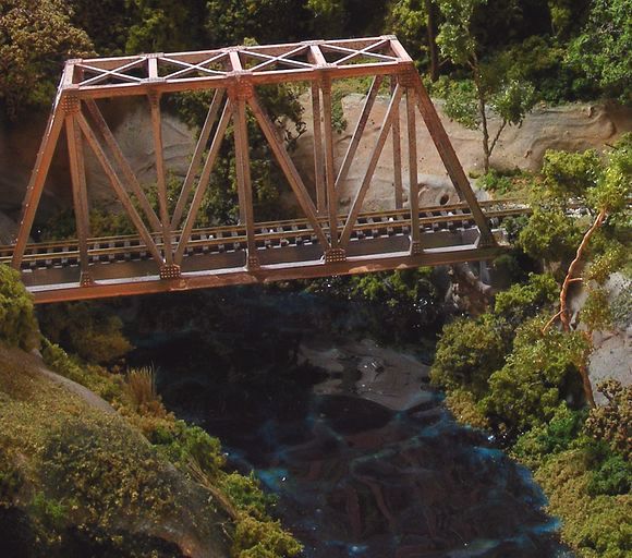

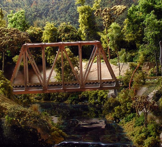

Well here is the umpthteen version of the river color/water:
I like the colour better, although the blue is still a bit too prominent for my tastes. I think that if the surface were totally smooth and level, that colour would be perfect - a deep and slow-moving river.
You've certainly nailed the wet-look and the colour, but the surface suggests a deep, roiling and fast-moving flow, which should have at least some "white-water"...that may be difficult to add in a convincing manner.
Wayne the pics make the water look more turbulent than it actually is. If you run your finger along the surface you would feel very little undulation.
