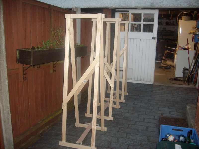

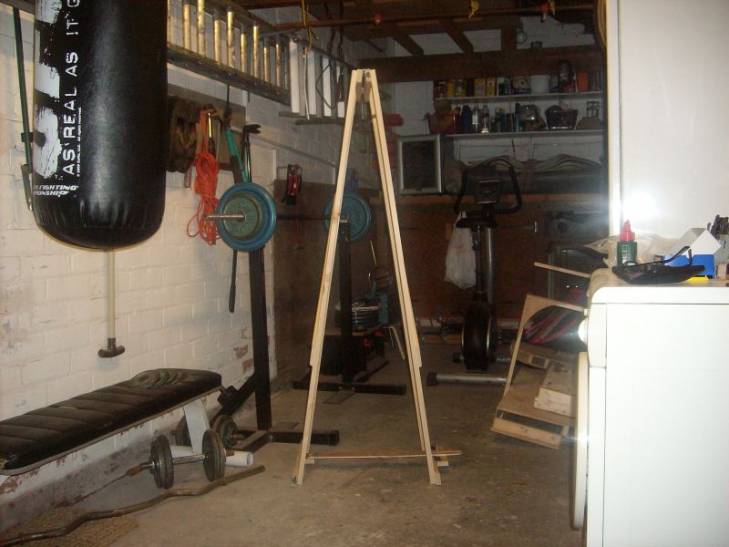

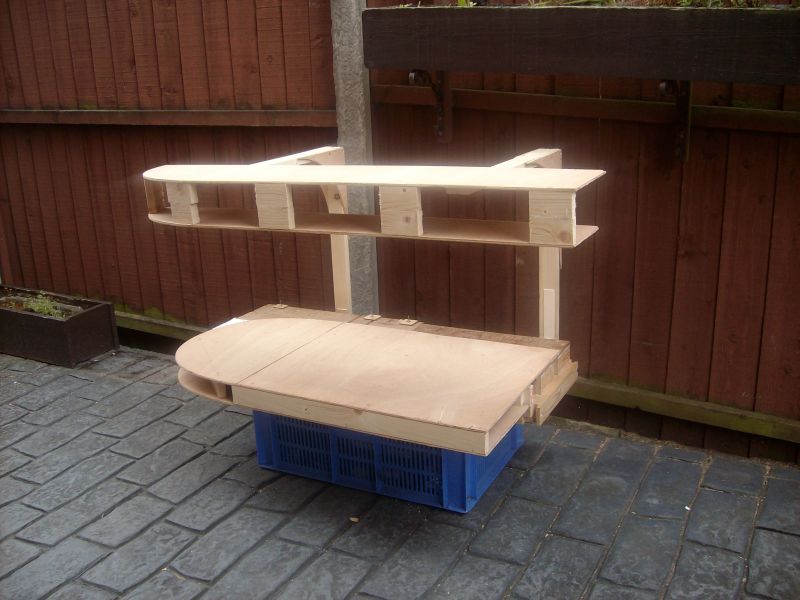

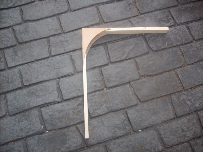

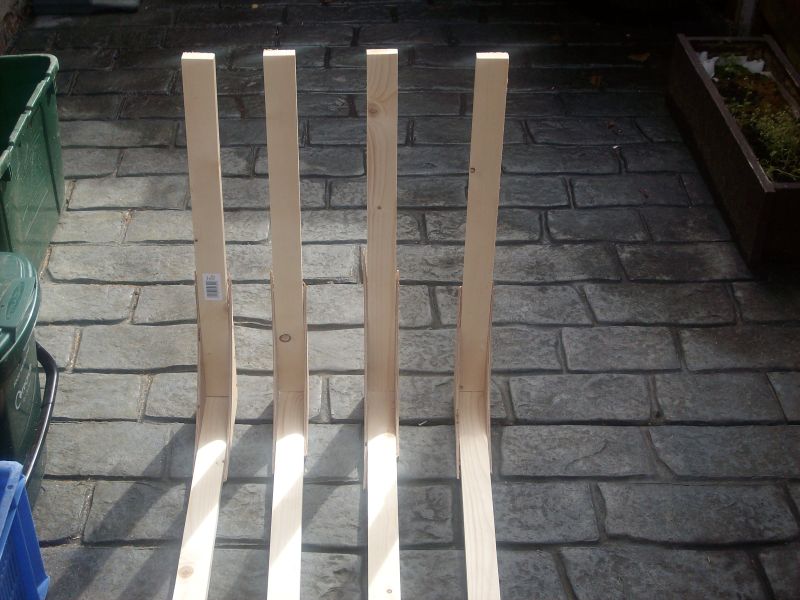

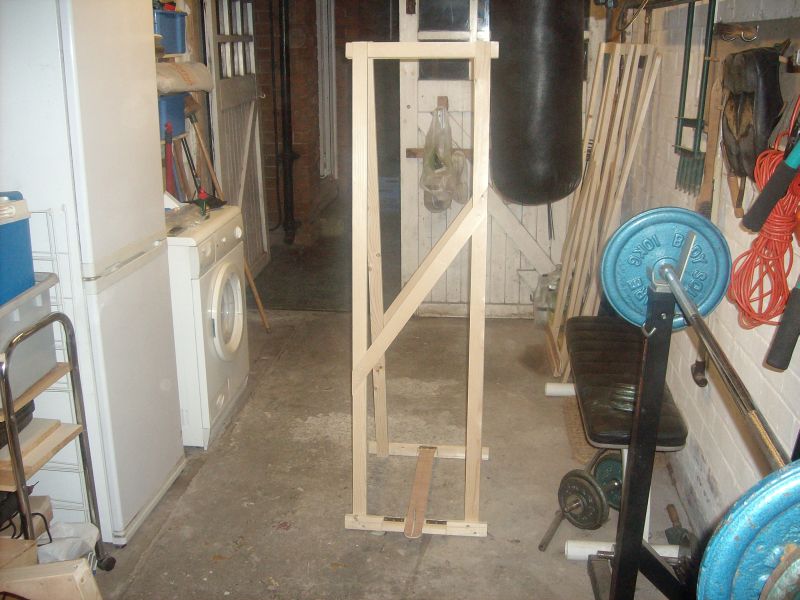

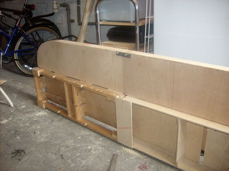

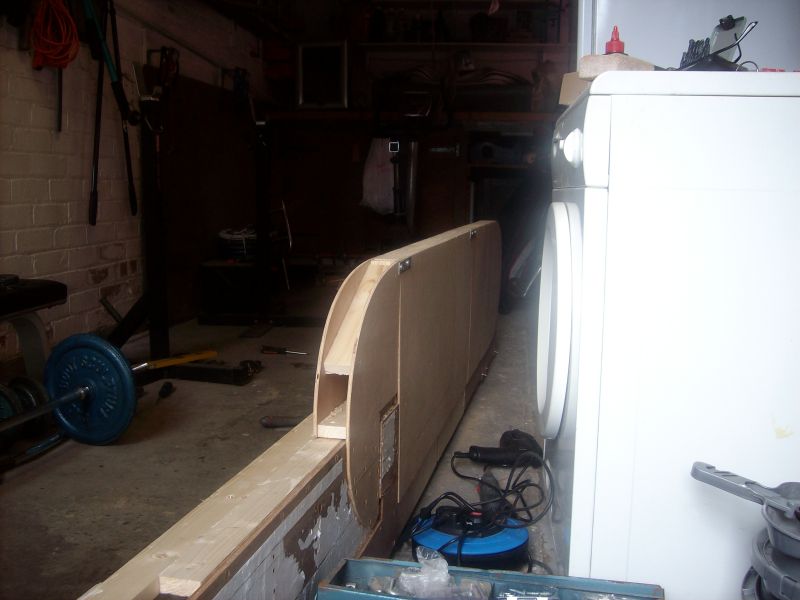

I'm following/adapting his design for 'Ulysses' baseboards for which he proscribes a display height of five feet. Believe it or not, they're a tad under 5' so that the trains will be at just over five feet which is just below my viewing height - I'm 6' 2".
Still, if I'd been vertically challenged, I'd be off to Devon first light to find him !!!!
Funnily enough, he doesn't appear particularly tall so how he can claim that he built the trestles to arm pit level is beyond me Nope
Apart from that, I'm quite pleased with them; they're only constructed from 2" x 1" but still are surprisingly robust.

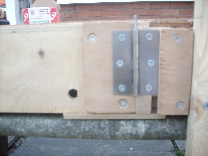

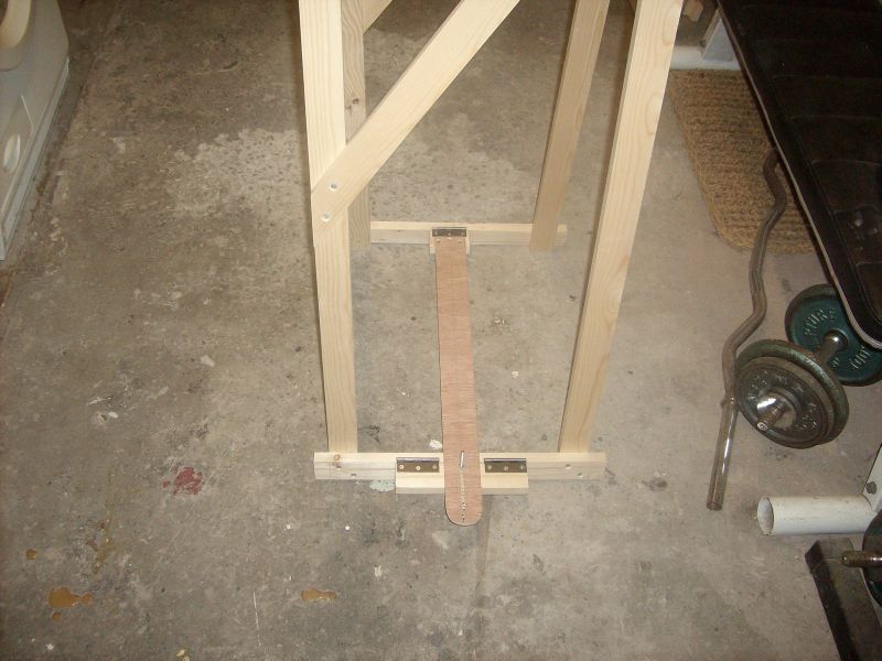

To answer the second part of your question, I'm not sure yet. Although I'm basing it on Ulysses, I'm actually just making it up as I go along so there are and will be a host of adaptions. So far, am thinking of just letting gravity take the strain, with the 4 baseboards plonked on top. The strap at the bottom allows vertical adjustment to maintain the level, and the top hinges have been placed far enough apart and raised to stop movement forwards or backwards widthways. The first and third trestles will be placed beneath the traverser (board #1) and sector plate (board #4) with the second (middle) trestle being placed beneath the joint of baseboards #2 and #3. The boards themselves are connected via hinges with replacement pins in both horizontal and vertical planes a la Barry Norman and purpose built nuts/bolts between boards #3 and #4 which are supplemented vertically with a further hinge connection - the boards, therefore, are quite rigid and thus self supporting. That'll be fine for my home use; both my offspring are grown up so there shouldn't be any problems with little 'uns using them for mountain climbing practice Icon_lol Still, won't be sure until test fitting has begun.

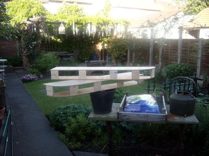

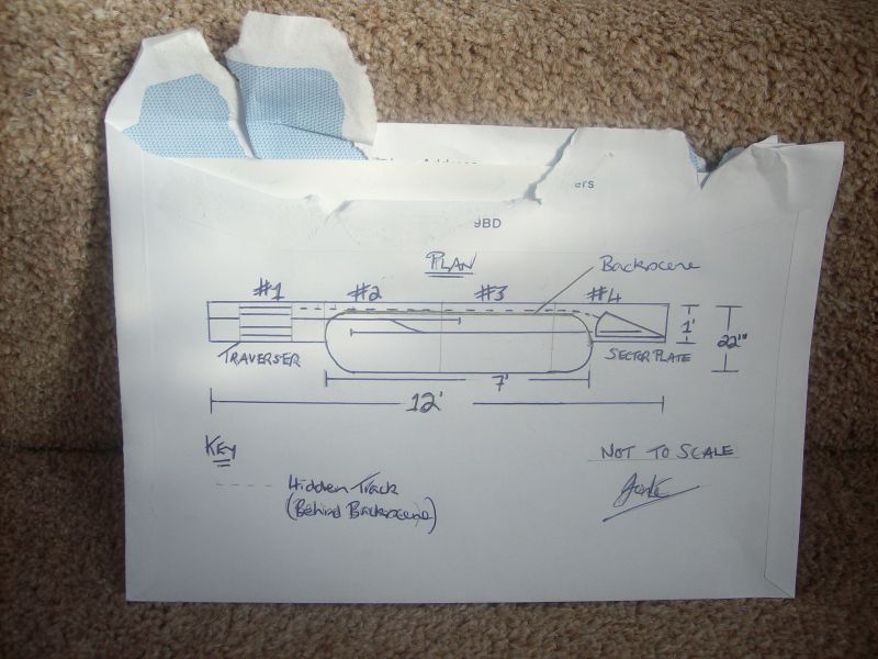

Jonte, where will that unit fit in? Could you post a simple overview drawing? I got lost :?
faraway Wrote:Jonte, where will that unit fit in? Could you post a simple overview drawing? I got lost :?
Sure, Reinhard.

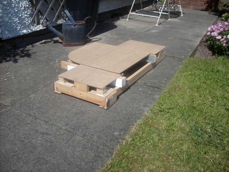

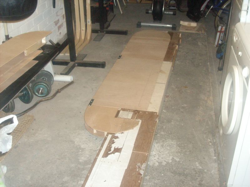

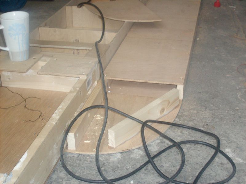

In the meantime, that unit is a traverser that I knocked up from an old kitchen sliding drawer. This is what I refer to as board #1.
Board #2 is the one adjacent to the traverser and where the scenic section will begin.
The next in line, board# 3, is also scenicked.
Finally, board #4 is where the scenic section will end, and the train will enter a sector plate. It'll be divided up as 2:1 (sector plate : scenic).
The sector plate will send the train back to the traverser (board #1) via a single track hidden behind the backscene (when I work out how to build it, that is, prefereably without any gaps!).
Yeah, I see what you mean.....confusing isn't it.
Let me find an old envelope!!
Jonte
Hi Reinhard,
Sorry for the delay.
Hope this makes things a little clearer.
Best wishes,
Jonte
jonte Wrote:....Hope this makes things a little clearer....
Thank you very much. You do not plan the obvious. That will be very interesting.
