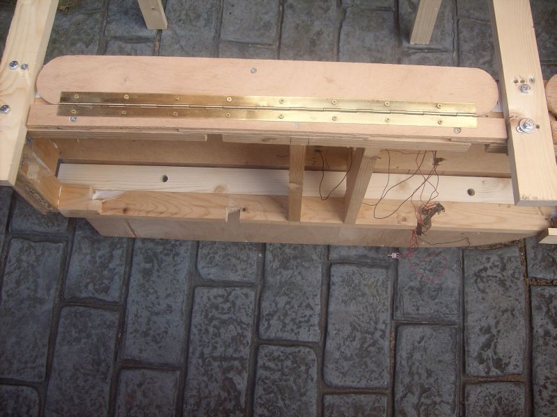

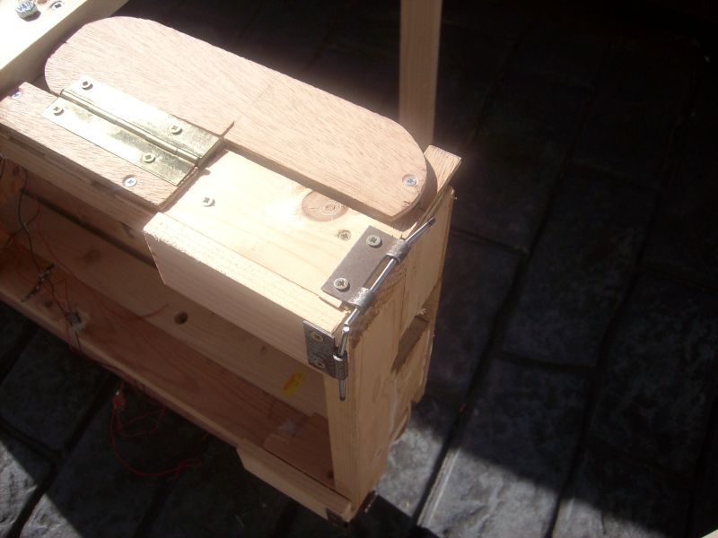

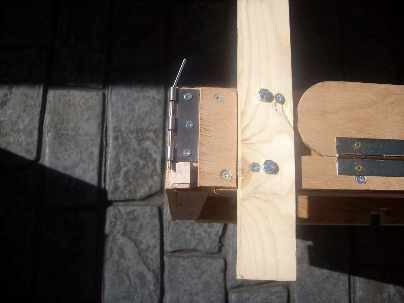

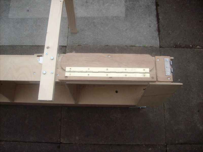

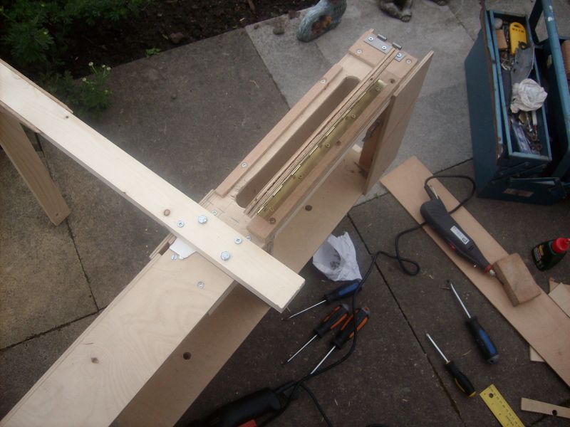

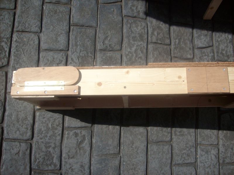

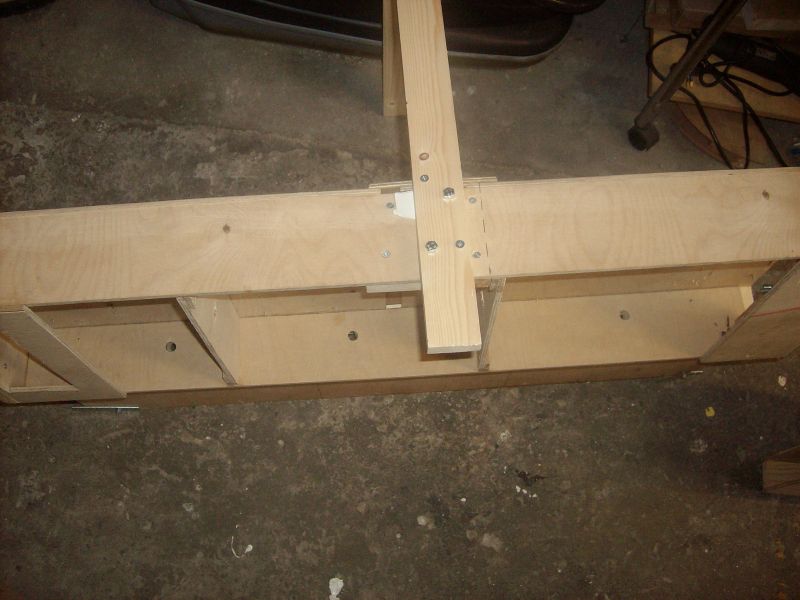

A service hatch produced from scraps.
Jonte

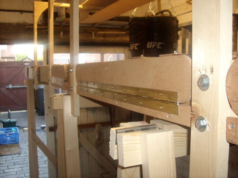

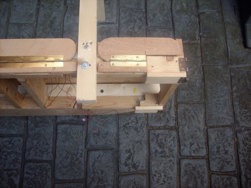

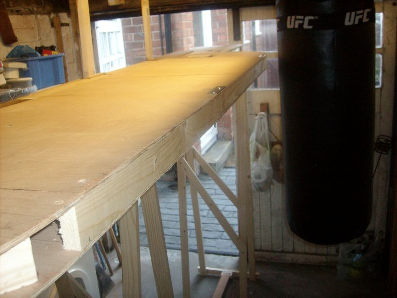

This the last of three boards requiring service hatches fitting.
Removeable hinge pins replace the originals, allowing each board to be secured to its neighbour - centre boards have hinges supplemented with bolts between the frames of each adjoining board.
Jonte

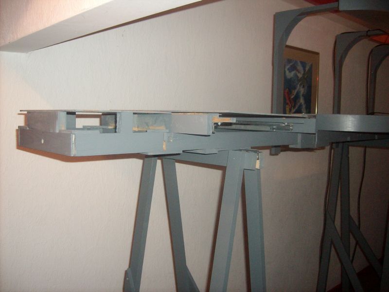

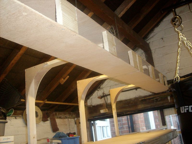

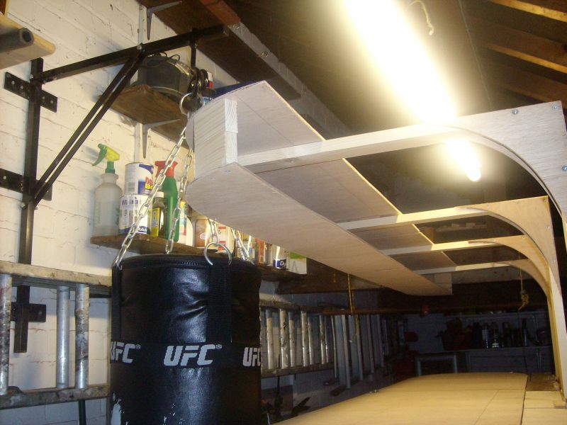

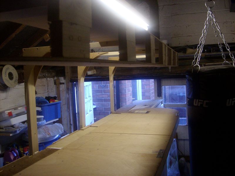

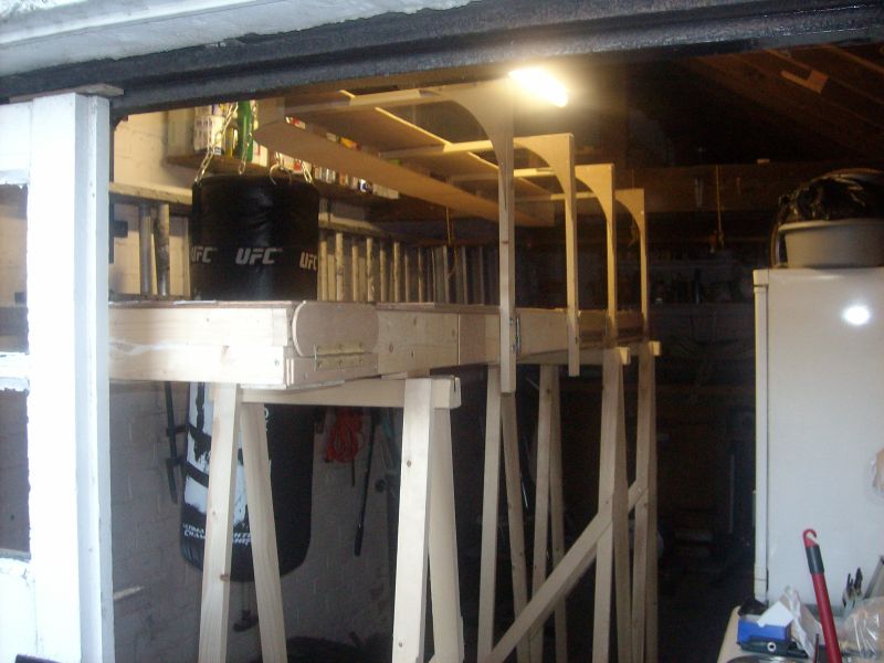

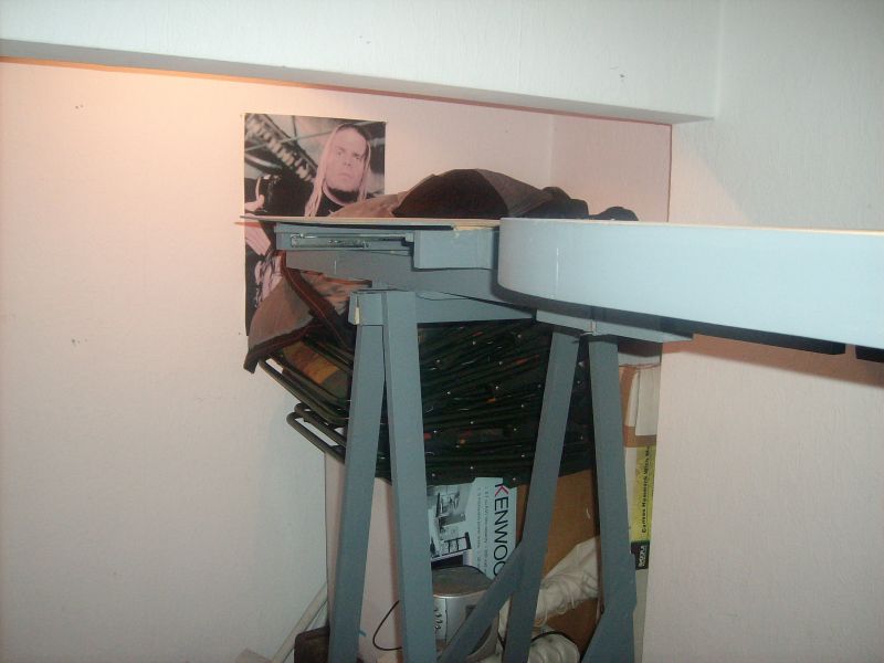

Traverser has been removed for time being to ensure the other three boards are level and true for refitting of pelmet supports.
Pelmet has been temporarily located until the morniong when I'll drill for holes for fixing bolts.
Jonte

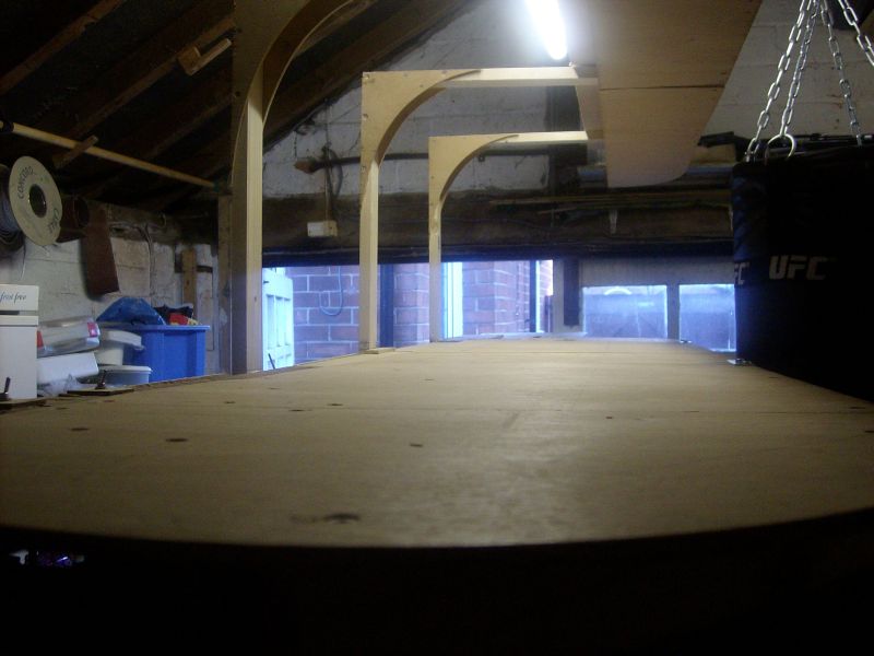

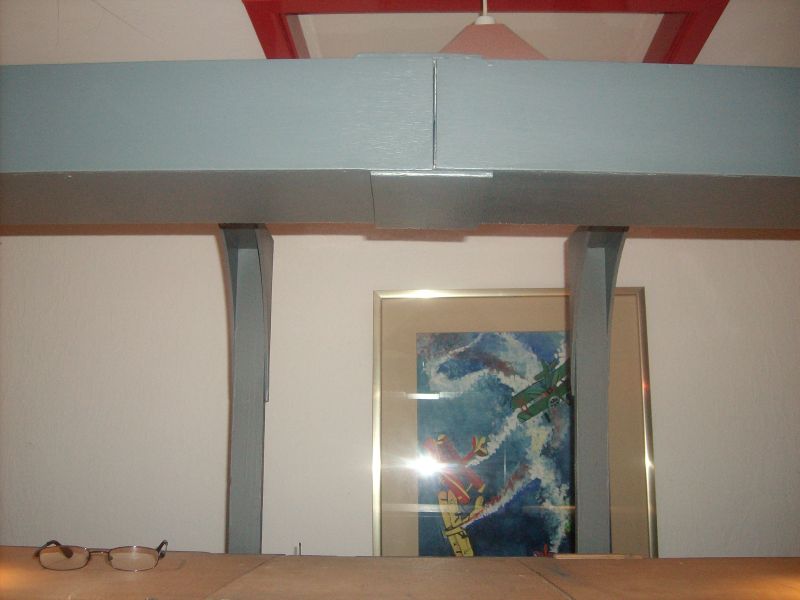

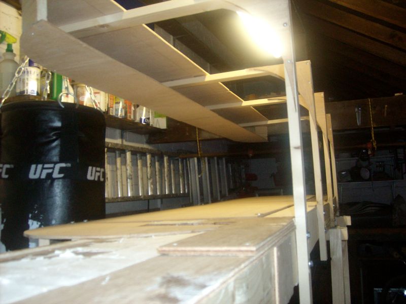

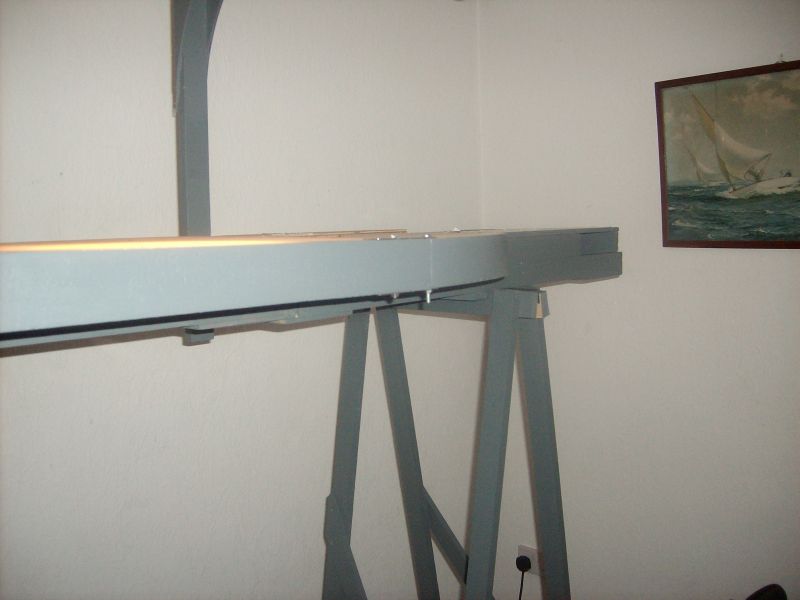

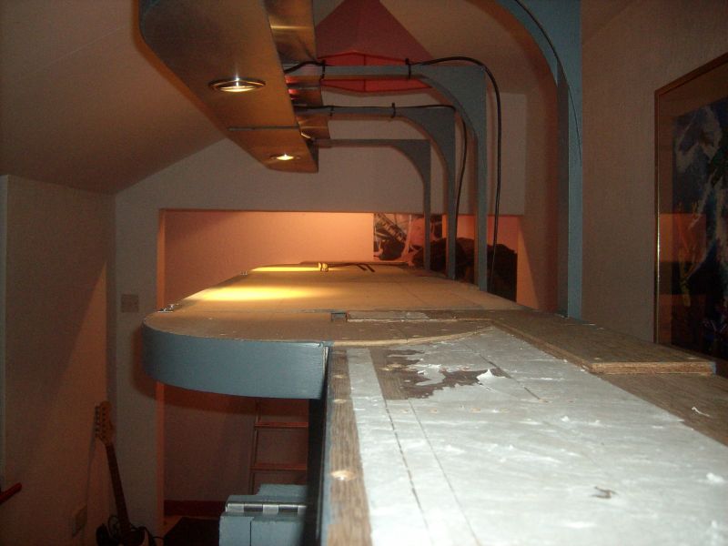

Hi

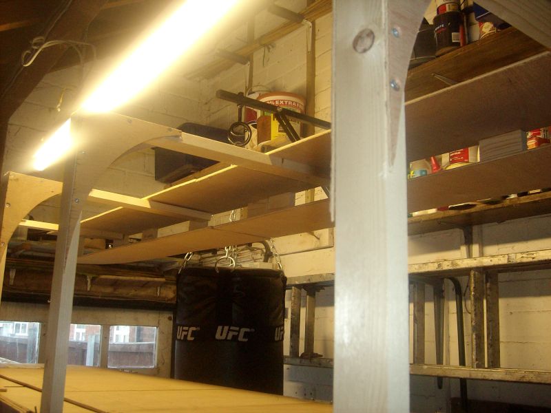

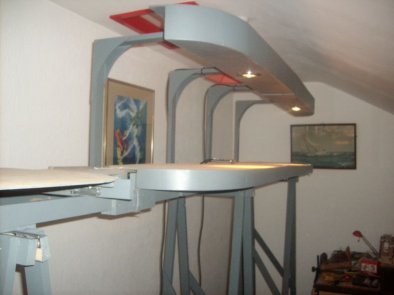

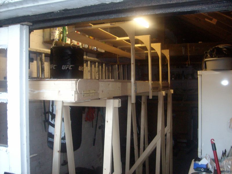

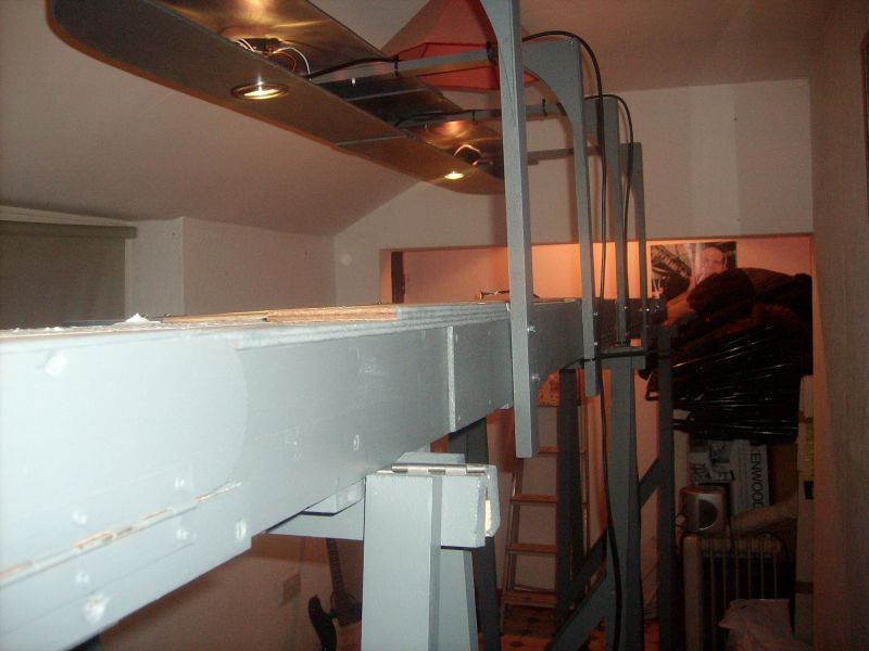

Baseboards and lighting pelmet have now been painted and the whole lot reassembled in my office-cum-railway room.
Low voltage gimballed downlighters have been fitted to the pelmet, however, they provide insufficient light therefore additional lighting in the form of fluorescent bulbs will be fitted.
Photos attached to show progress:
Jonte

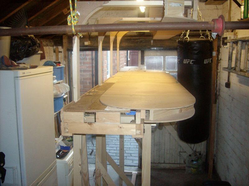

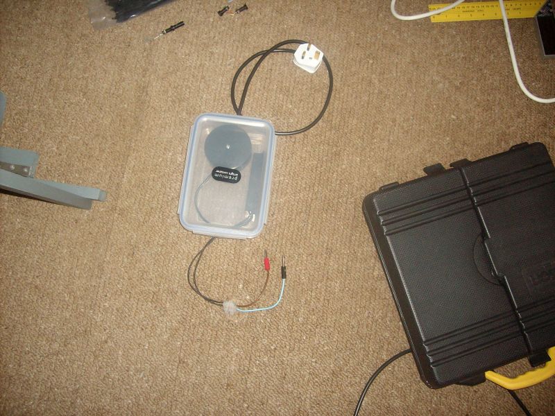

A couple more, one of which shows the wiring in place on the layout.

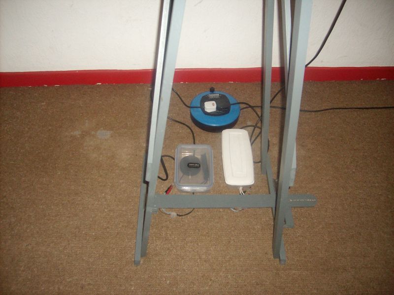

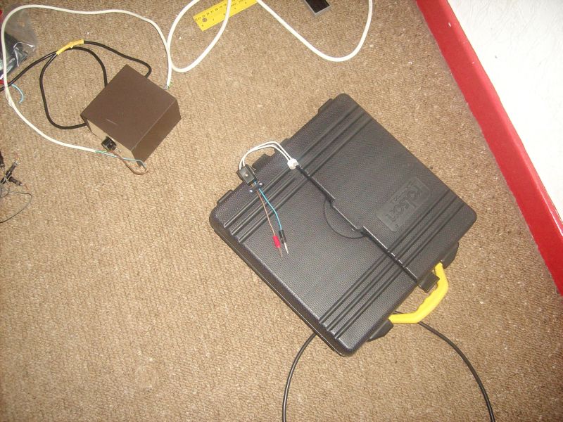

This last photo shows how the lighting transformers and junction boxes have been placed in plastic tupperware boxes with 240V in, 12V out.
Male and female connectors fitted to the transformer leads and lighting leads, connected via a flex cable make the lighting units a little more portable.
Best wishes,
Jonte

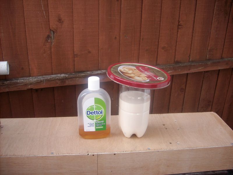

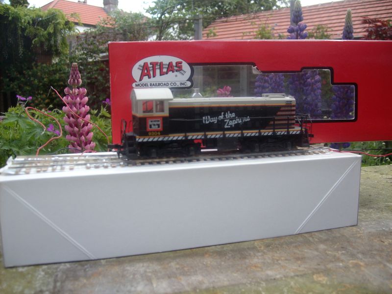

The dettol & tap water method was one I happened upon quite by chance, after I was also advised to go down the brake fluid route. Although I'm a new to the hobby, I'm not totally naive and alarm bells rang at the thought of plastic being dipped in brakefluid and the possible consequenec of a change of state from solid to liquid! To answer your question, Koos, it was easy peasy with most of the paint/transfers dissolving into the solution. The more persistant bits of paint that remained, had turned to slime that was easily shifted with the stroke of an old tooth brush. A rinse under the tap and a quick polish with a clean rag returned the loco to its pre-painted factory state. Admittedly, I returned the bonnet of the loco to a fresh solution for a further day or so as the plethora of louvre vents on each side showed a faint residue of paint had remained, and as I was just too lazy to go over them with a tooth pick as suggested, took the easiest option by putting them back into the solution. A quick clean with the old tooth brush and rinse under the tap resulted in a bonnet that was as clean as a whistle and I shall get round to starting the detailing in the next few days (the Microscale order arrived this afternoon - Friday).
Here's a link to the original instructions which I trust you'll find useful <!-- m --><a class="postlink" href="http://www.wikihow.com/Remove-Paint-from-Metal-and-Plastic-Models-with-Dettol">http://www.wikihow.com/Remove-Paint-fro ... ith-Dettol</a><!-- m -->, and I've posted a couple of before and after shots of the subject. As a footnote, the best part of this - unlike the brake fluid - is that there are no noxious substances that require care in their handling and disposal, and it'll even kill a germ or two!! The only word of caution I'd offer is that plastic cement/adhesive will perish so no Airfix kits
Before
After
Detailing parts as mentioned in text also shown, which will no doubt be familiar to readers from N. America.
Thanks for passing on the idea for the backscene; I shall give it much consideration.
With regard to the age of the Athearn, as you can see from the photos it's a red box not blue so don't know if that makes it older or newer? Anyway, thanks for the solutions to the issue with poor running qualities - it's okay at speed but I need this to crawl - however, the simplest solution ( I always opt for those!!) as I'm not going down the DCC route just yet, is to purchase a pulse controller from Black Cat Industries as kindly suggested by good old Jack shortliner - now here's somebody always ready to help I believe the proprietor is away until the 13th of June so will place an order on his return.
By the way, I had a quick 'butcher's' at you blog last night - an excellent purchase for your son BTW - my Bachmann GP 38-2 is a sweet little runner with one or two nice little details to boot - everything, I'm afraid, my Athearn switcher isn't. Their service is first class - being clueless, I emailed them to enquire as to how to remove the body after accidentally dropping the poor little loco from a great height, damaging a bogie in the process. I received a prompt reply with an offer of further help if needed. Despite the bad press Bachmann American HO has received, I am most impressed and I'm sure your son will be extremely happy with his new purchase. Talking of dropping locos from great heights: where did I put that darned Athearn switcher
Keep looking in and thanks again,
Jonte

Well, part of my comments in regards to the loco drive etc may not be valid. Unless the loco came in the wrong box, that loco is an Atlas, not an Athearn. Atlas were constructed a bit better than Athearn's were in those days, they generally have a better motor etc. However, this poor little switcher may have seen a bit of action perhaps, and is in need of TLC. If it comes with the instructions, have a look how it comes apart and then some of my 'tips' will be equally useful, as in cleaning out the gears, re-lubricating, etc.
Should you not have these instructions, Atlas may be able to provide a copy, or otherwise have a look on the following site: <!-- m --><a class="postlink" href="http://www.hoseeker.org/">http://www.hoseeker.org/</a><!-- m -->
Unlike the name suggest , this is not a site that provides services for the 'lonely' :-) Rather, it has a nice selection of scans of instructions/drawings of many locomotives (including your Bachman probably) and part sheets. It may be useful to you.
If you'd like, post a picture of the loco you have with the shell removed, so we can see it's guts, that will probably help in identifying if it is an Atlas, Athearn, or any other make , and was shipped in an Atlas box. :-)
