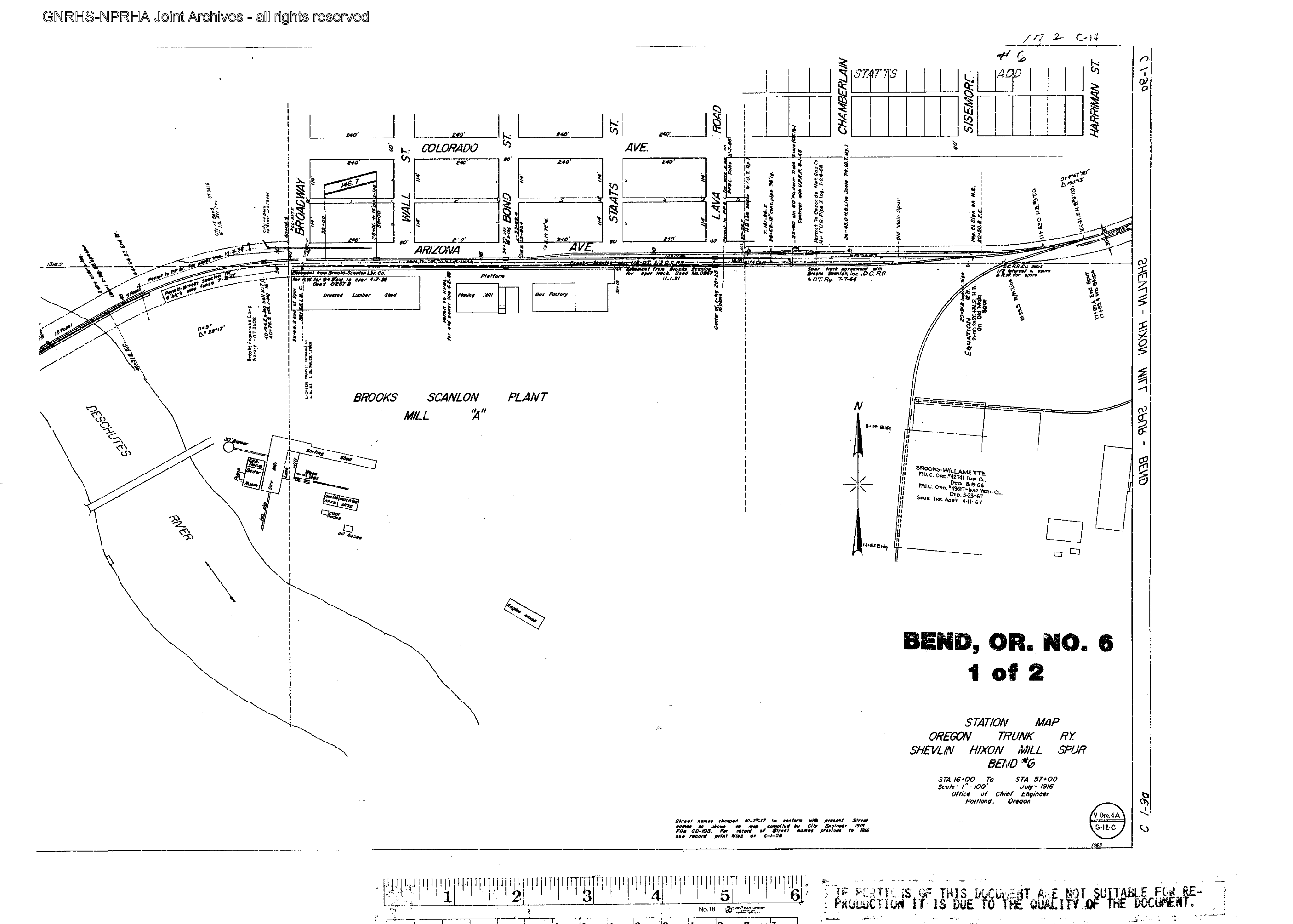

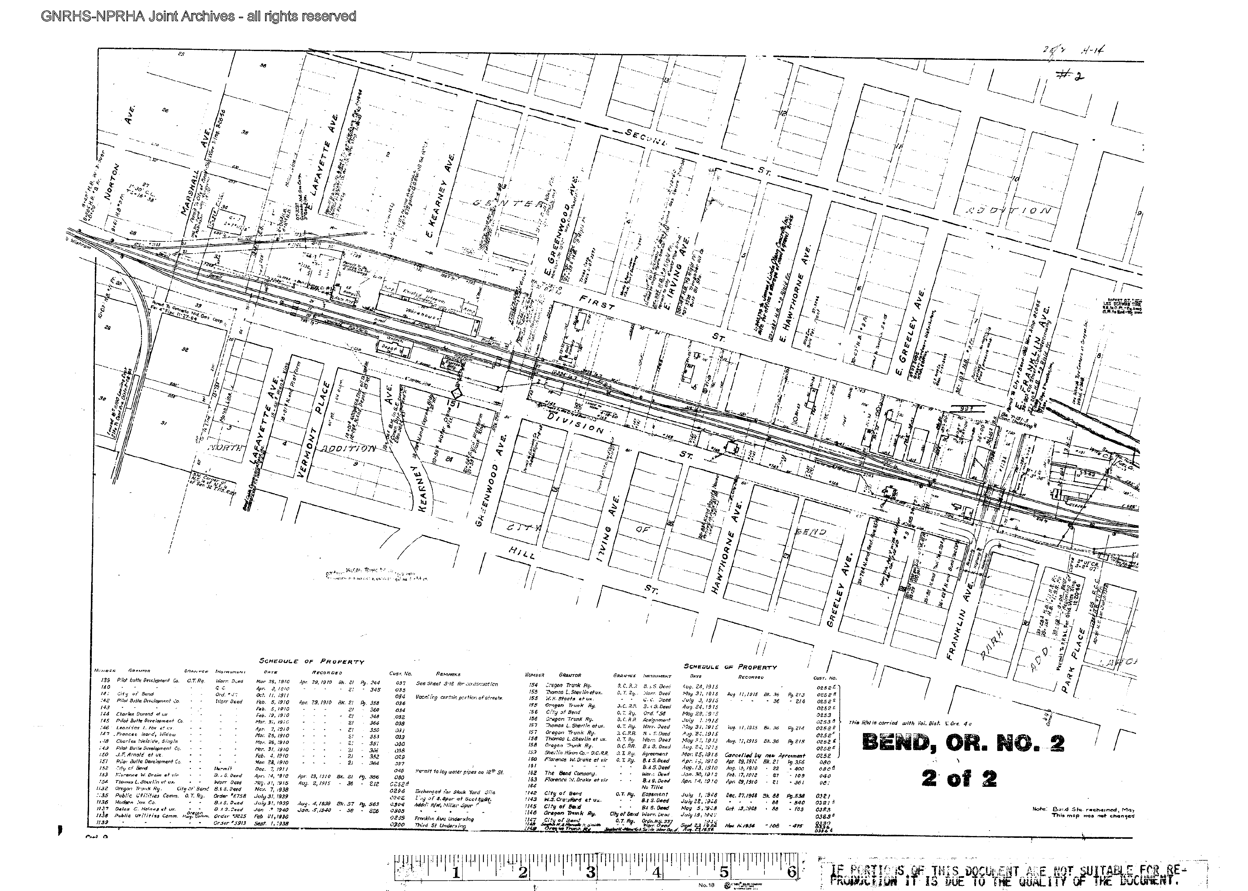

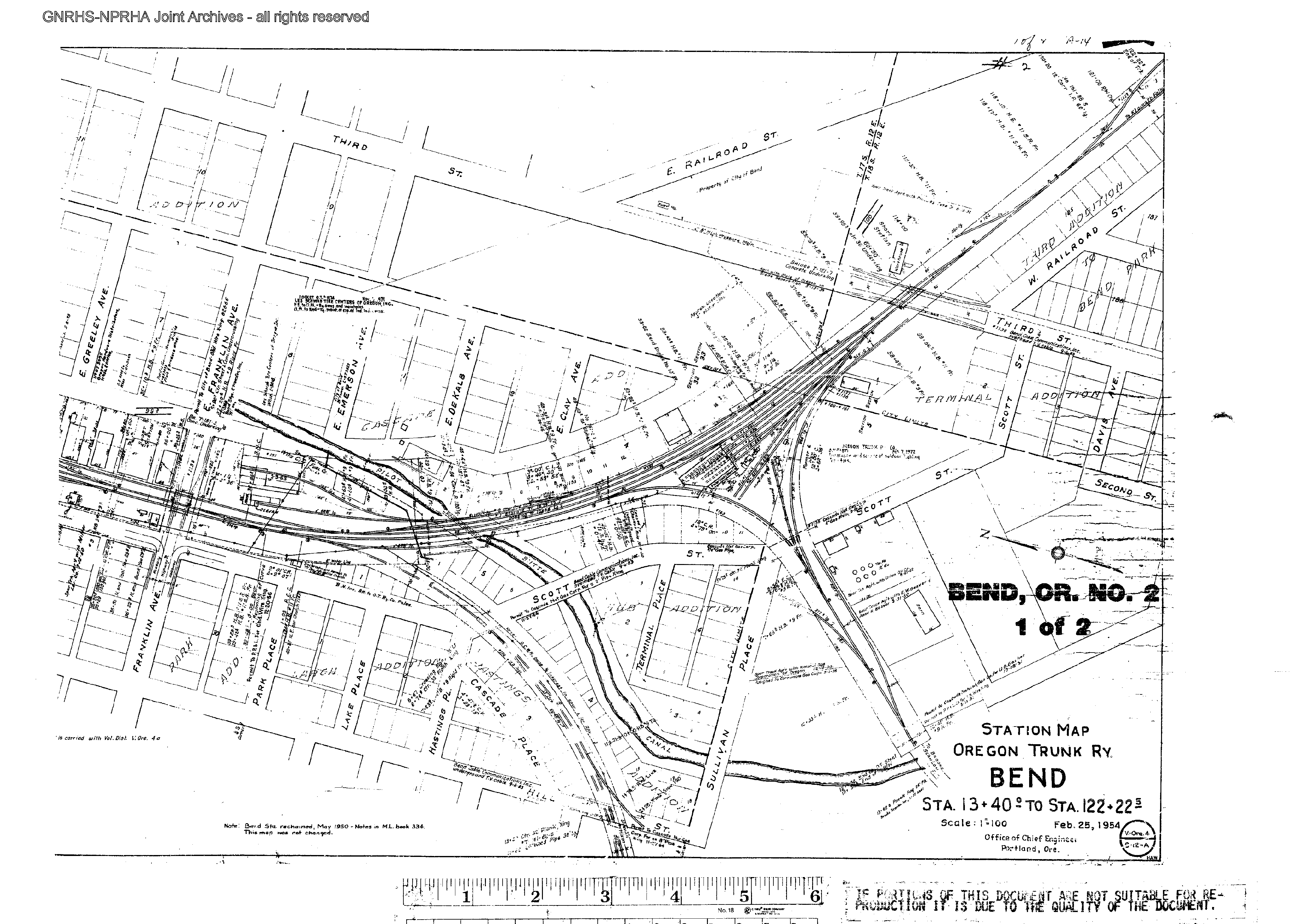

Yeah it is based on the prototype here are the station plats I am utilizing to base my plan from.
[Image: Plat013658.GIF]
[Image: Plat013657.GIF]
[Image: Plat013666.GIF]
As with most model railroading I have had to omit some tracks and compress everything to fit...they also do not connect back together.
