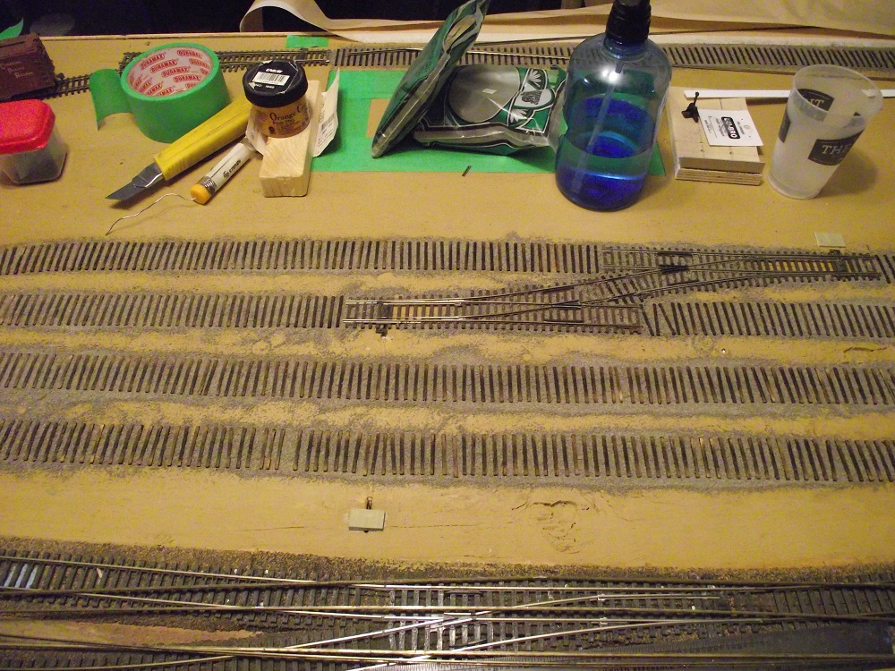

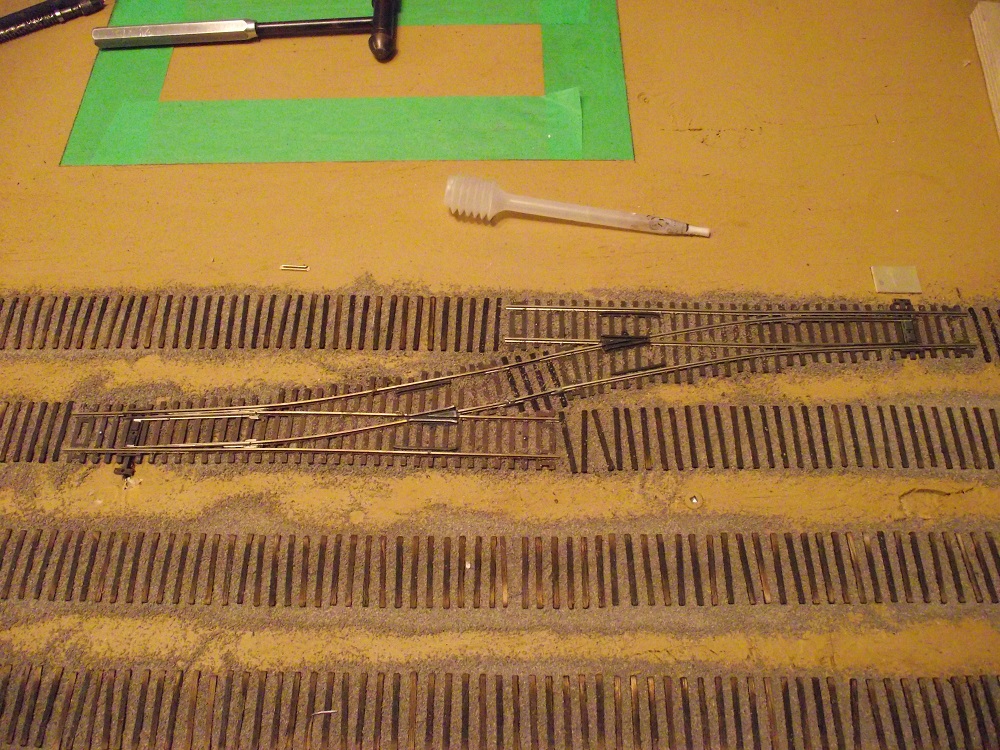

I ballasted the ties in this week:
I'm using WS fine gray as mentioned before along with my home-made scenic cement. After the cement had set up I went back and sanded the tops of the ties with 200 grit sandpaper wrapped around a wood block. This evened out the ties, removed any ballast that had become glued to the tops of the ties, and produced a nice weathered look.
I also ballasted around some of the turnouts, but not around the points. Still figuring that out. These still have to be cleaned up around the rails, frogs, and tops of the ties.

(08-07-2022, 10:27 AM)cnrglen Wrote: ...I also ballasted around some of the turnouts, but not around the points. Still figuring that out. These still have to be cleaned up around the rails, frogs, and tops of the ties.
I've found that a nice 1" brush with soft bristles is a good way to spread and level ballast, without flicking granules all over the landscape, as would be the results using a brush with stiffer bristles. I usually keep the brush handle close to the ground, dragging the ballast rather than pushing it.
When ballasting turnouts, I apply a little plastic-compatible oil atop all of the ties over which the points will be travelling, then park the points mid-throw within the turnout. If necessary, use some scrap wood or strip styrene to keep the points away from the rails.
I then mist the groomed ballast using tap water with a few drops of dish detergent add, then use a small squeeze bottle to apply the diluted white glue. On slopes where the ballast is deep, the setting time can take over a week.

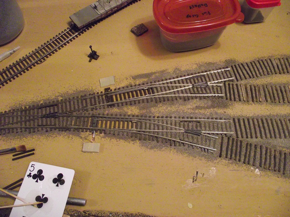

You advice worked great Wayne:
It needs a bit of cleanup but the turnouts all work the way they are supposed to and the ballast stayed where I wanted it. I do spray with the 'wet' water before but I used diluted Mod- Podge as my scenic cement.

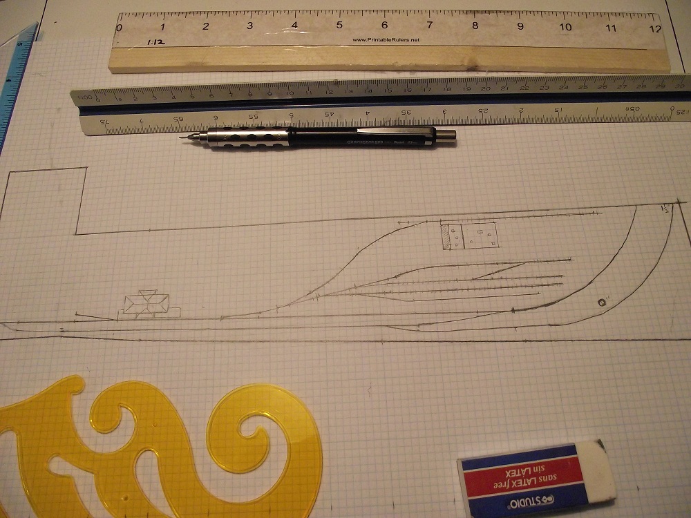

I wanted to make a scale layout plan for the section that I'm working on so I can figure out streets, buildings and other details. I watched a tutorial or two on line and drew this in a few hours. I know it's not perfectly up to draftsman standards but it is a fairly accurate schematic.
The scale is 1" to 1'. I went online to Printable rulers.net and found an imperial ruler that was divided into 1/12th on an inch and that helped with scaling down the layout. After that all I needed was a straight edge, a square, compass and a French curve. I added the warehouse and station buildings since I already knew where they were going.
I also hope this also helps to plan the engine facility down the road as I am still toying with the idea of a turntable, if it fits.

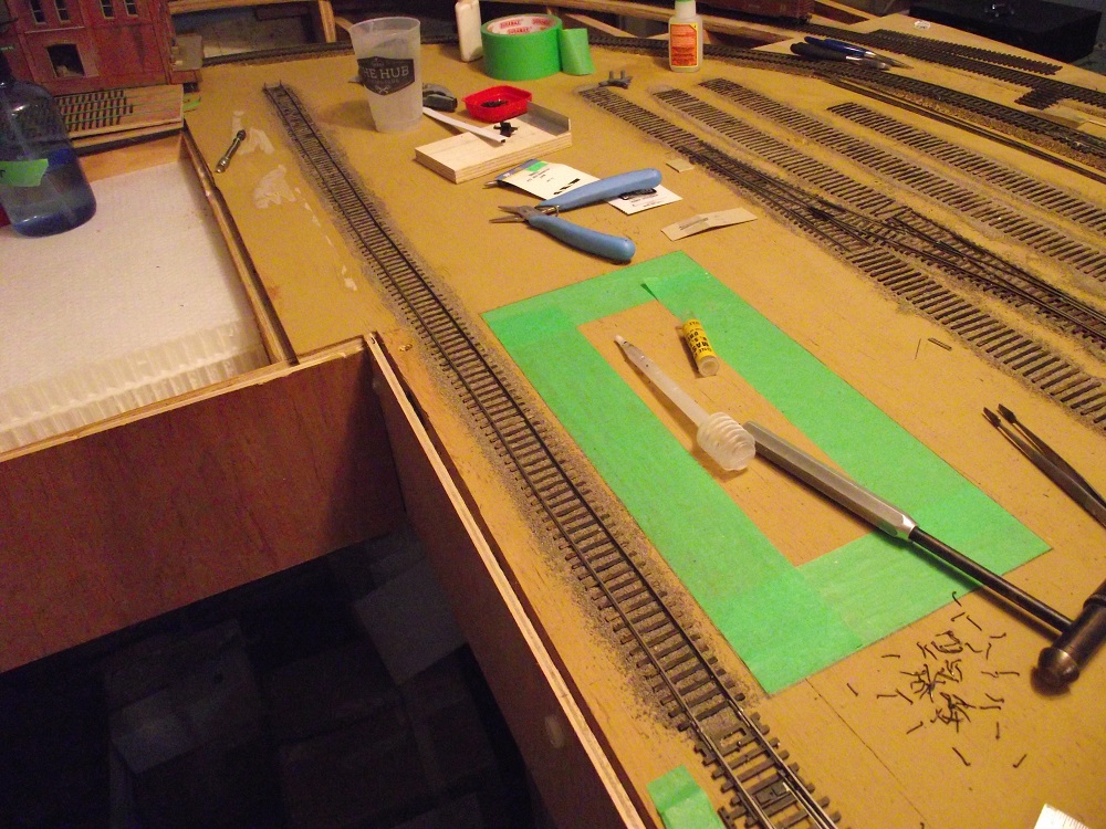

Well I may not be fast but I'm slow. I finished the first siding this afternoon.
It took a bit to get back into the rhythm of handlaying again. I also had to change the spikes to the Micro Engineering ones as I have almost run out of railcraft spikes. The M-E spikes have a slightly larger head and are a tiny bit larger in diameter so I went from a #75 drill bit to pre-drill to a #73 to avoid bending the spikes.
I like how the sanded ties, hand spiked rail and the gray ballast look together.
