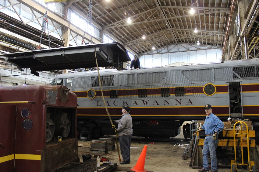

Not many pics of me doing anything here,,, I'm normally on the other side of the camera. but, I do show up in this Richard Jahn photo.
With the new radiators back in and the prime mover put back together it was time to put the top back on.     Next year we will have to remove the hatch one more time to replace the radiators on the other side. we have done what our time and money budget has allowed.

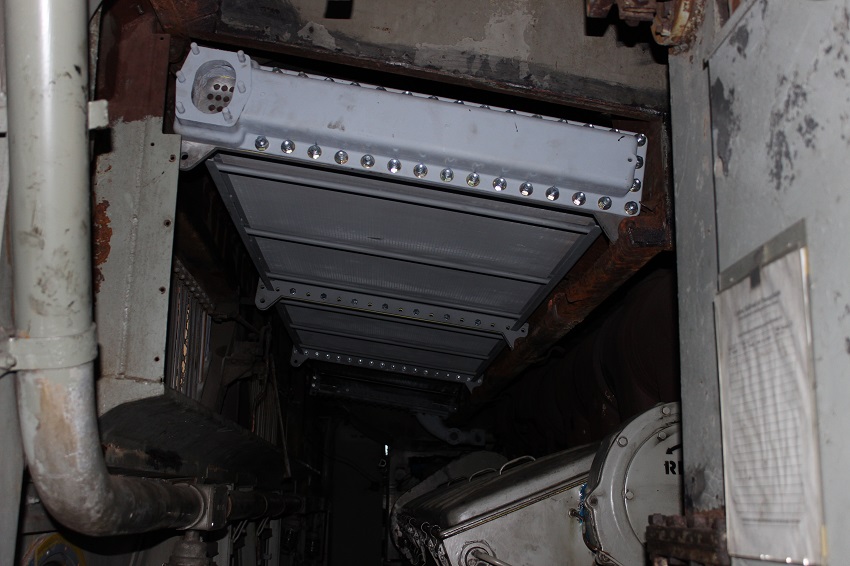

Here's a shot from the inside of what the new cooling system looks like. All the plumbing will still need to be connected,,, but that's for next week.

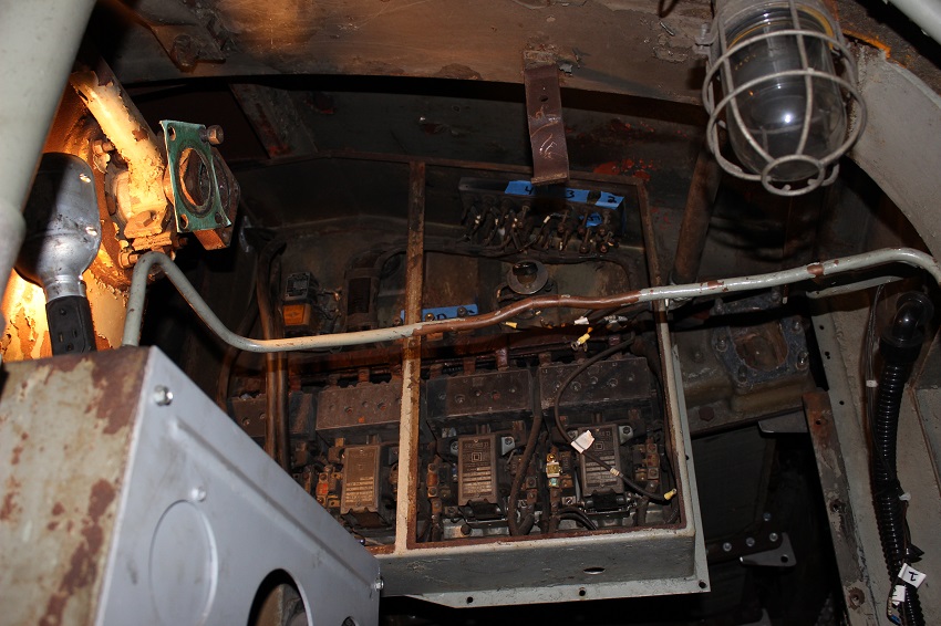

The conduits were reinstalled into the fan control cabinet., and all the wiring terminated on to it's correct binding post.

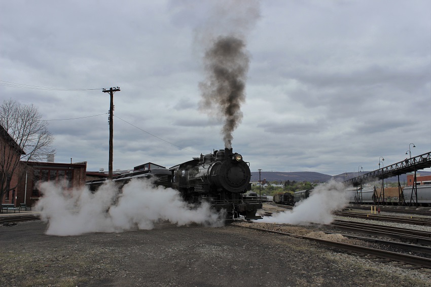

Then it was time to step outside for a little breather and watch #26 take out the yard shuttle.

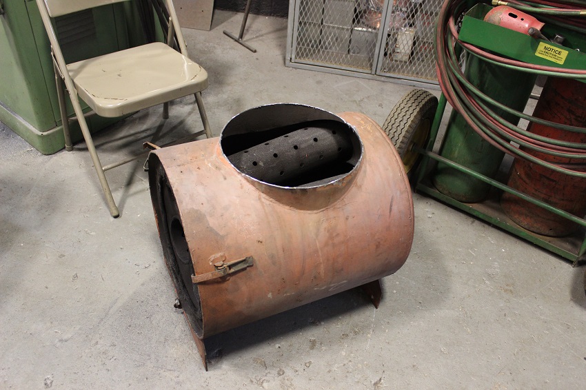

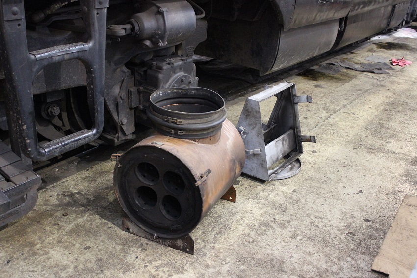

One of the upgrades that is being done while we are doing this is to remove the old "Oil Bath" type air filter housings that are no longer in service and attach the paper filter holders directly to the blowers.
The oil bath system on the left, mounts on top of the blower by the round flange on it's bottom (it's upside down in this pic). Then the paper filter bracket on the right, attaches on the open end on the left.     This set up makes it very difficult to change the filters and restricts the air flow into the engine. In this engine the old filter system hasn't been in use for decades so it will be removed. But, before we can send it to the scrapyard we must remove the old mounting flange and weld it in place to the paper filter bracket. Like so...
After all the plumbing for the cooling system is reassembled the new improved air filters will be mounted.

Ah, e-paw, which one in the photo is you?
Can I just say from a workshop OH&S rep. point of view, I am not crazy about the photo of you guys working on top of the roof without any means of fall protection, either a harness system, building a temporary timber or steel handrail on both sides and or placing a mobile scaffold against both sides of the locomotive. Now before we get into a heated debate about the issue, remember it is a long way down to that hard concrete floor, which like Gravity, is very unforgiving. A serious accident or death can and will result in a whole lot of trouble, think officialdom, investigations, even inquests, that no body needs and which a volunteer organisation is generally not well placed to deal with, and may well not survive.
Given that you will have to repeat this process next year, it is well worth investing some time and energy in solving this problem before the next work cycle.
I dont wish to be seen as a Safety Nazi, as I would rather raise this issue friend to friend, before it becomes a tale of woe. I will give some thought to a suggested solution or two for you as one friend to another.
Please just take some little time with your workmates to discuss and properly solve this sort of issue so that you and we via you wonderful blog posts can continue to enjoy the 1 : 1 scale modelling that you do.

This mornings work session was very productive... First off we installed the newly finished air filter brackets.

While all of this was going on Little #26 was outside putting on the best show she could.

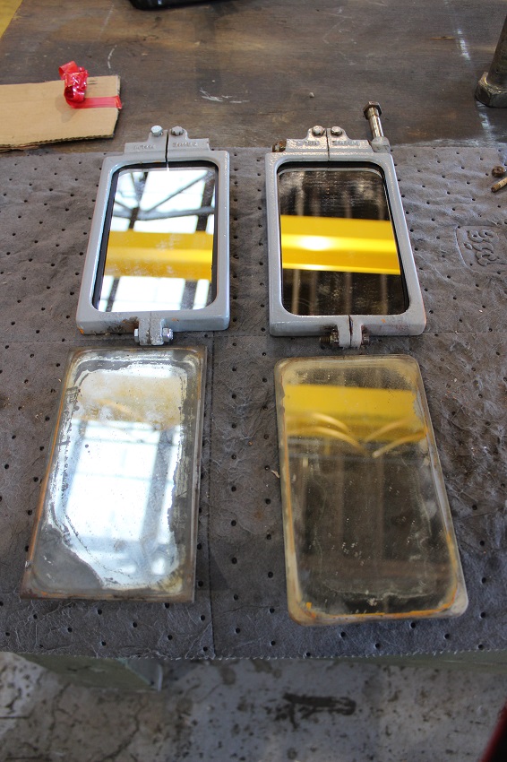

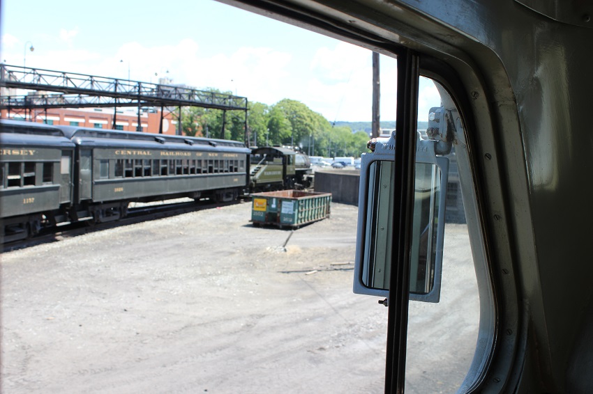

Another project was to replace the glass in the mirrors, these were also original to the locomotive. This shot shows the new glass in the frames with the old mirrors next to them.

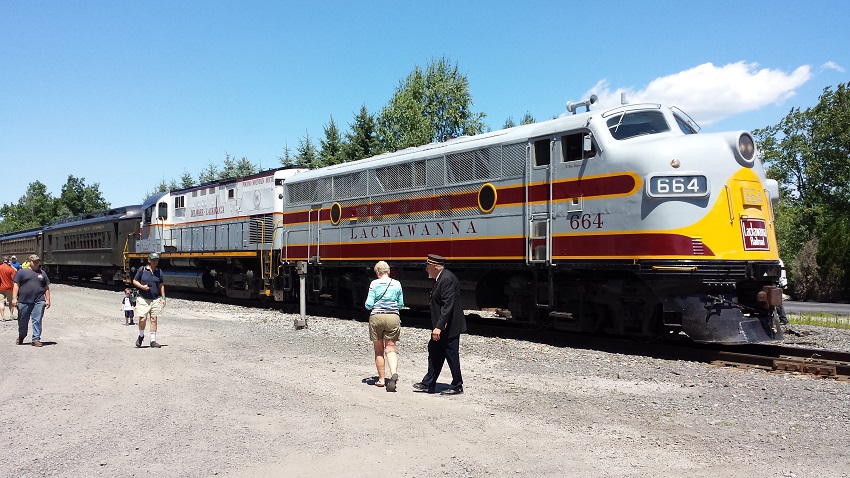

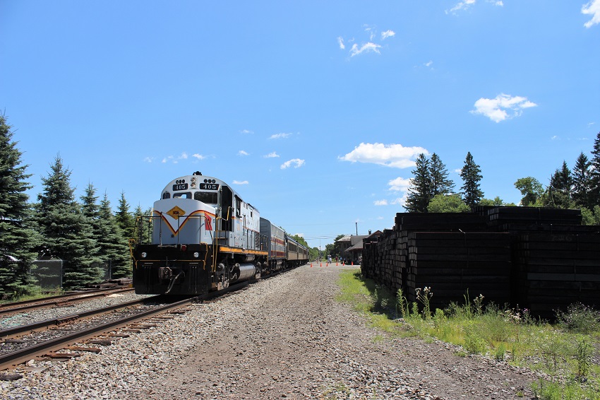

Just got back from today's excursion to Tobyhanna Where DL&W 664 and DL 405 did the honors of taking a group of passengers down to the Army depot and back to Scranton.

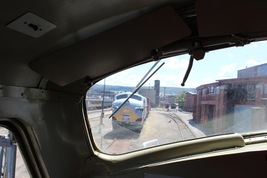

Ok.. what year is it??? Here we pass the display freight train as we gather our consist for today's run.

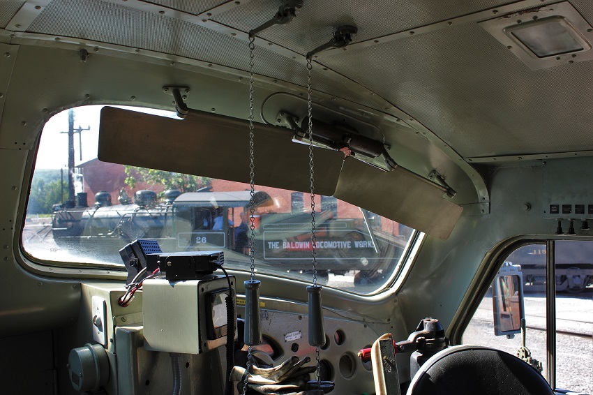

With our train in tow we pause for the yard shuttle with 26 on the point to get it's passengers and clear the tracks for us.

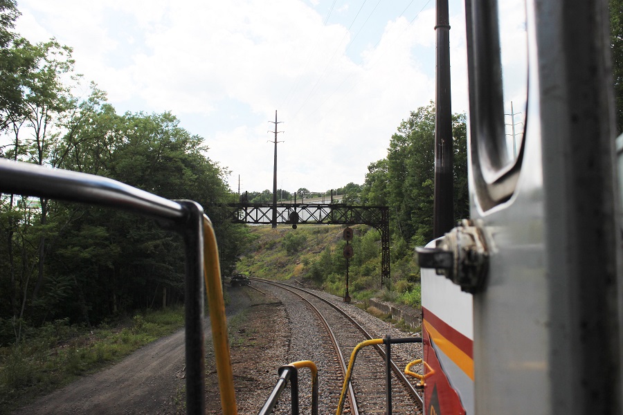

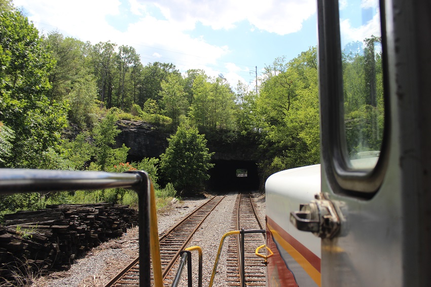

Approaching Nay Aug tunnel..

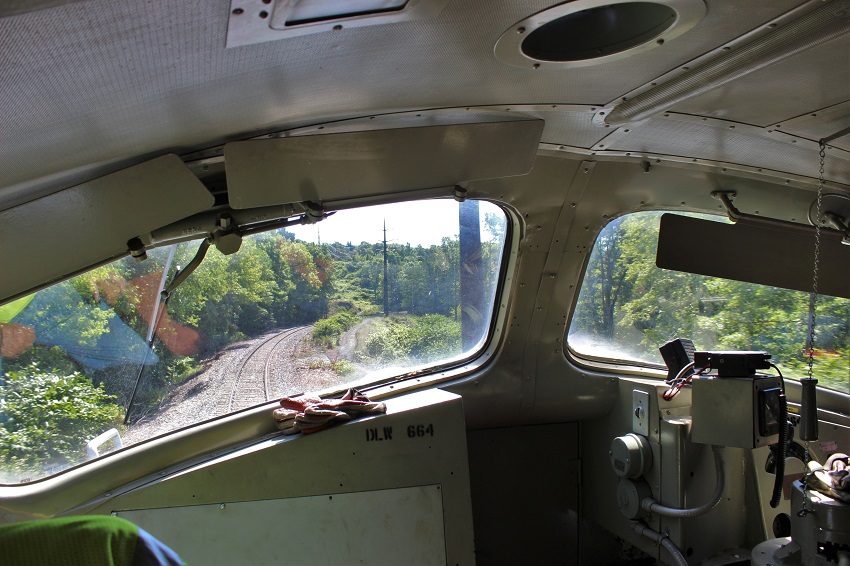

Thanks for the cab ride, Steve. Thumbsup Thumbsup
