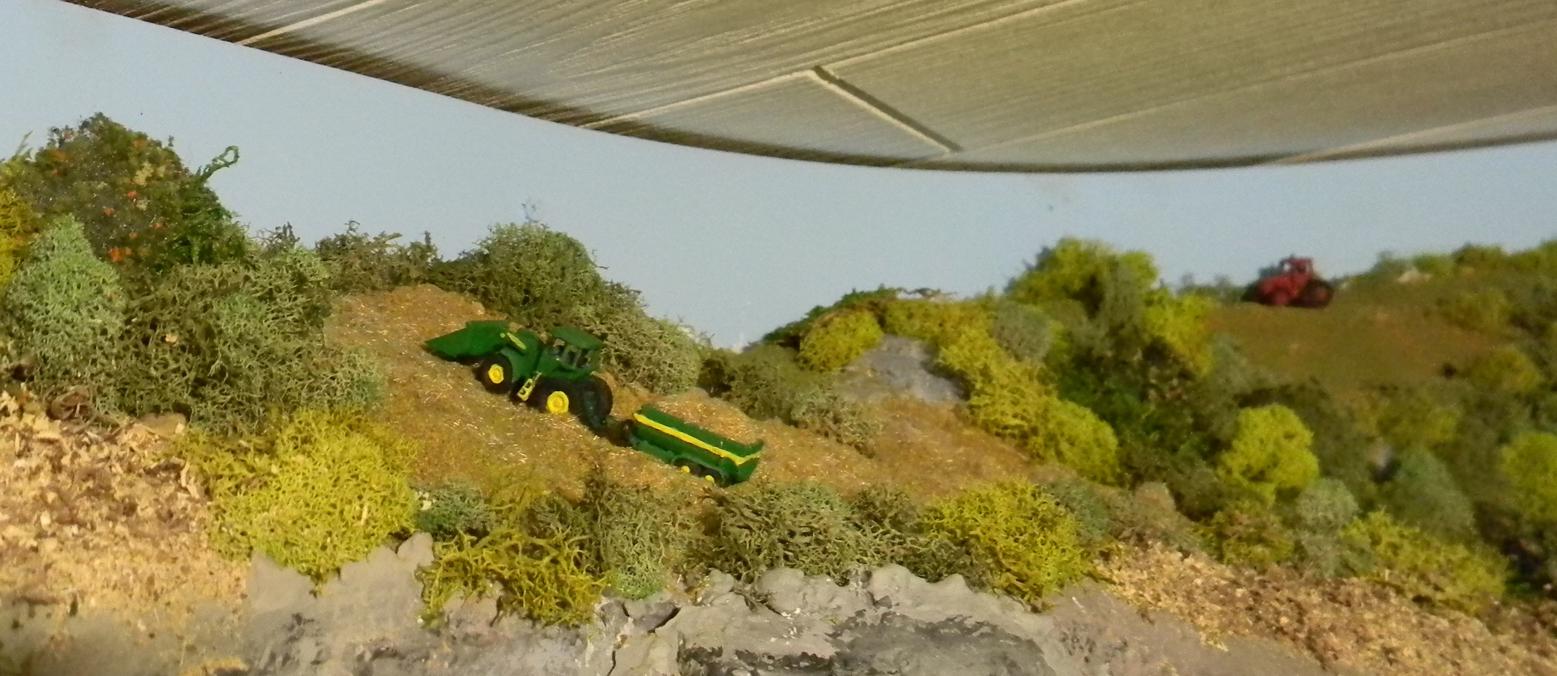

It looks alike the Chinamen have copied "Green" tractors. Paint the wheels of the green one yellow and you will know what i mean.

Lutz,
You're right! I had John Deere in mind when I painted the green one, and I knew I should include some yellow paint somewhere.... I'll get into that at some point today. I think the Red one was going to be an International Harvester/Case unit.

Amazing what a little yellow paint can do! Thanks Lutz!

The tractor looks great as does the scenery. You are right. It does not take much to make a model stand out.

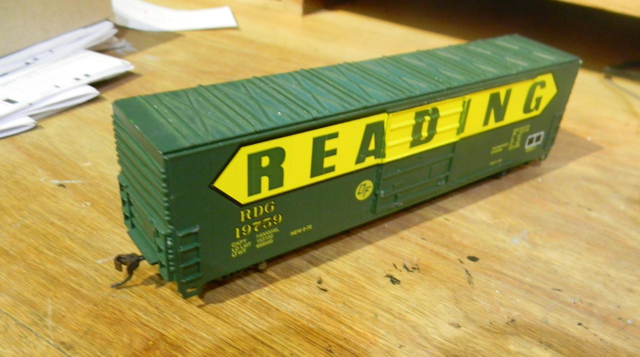

Well, that electronic marvel doesn't have any bids yet, but I've moved on to other items in the box. There were four box cars with body-mounted Kadee style couplers. The first was a C&BT Shops AAR 40' car in a decent looking Reading green. There was also what looks to be an Athearn high-cube 40' Conrail boxcar that was pretty nice, and the other two were Mantua 50' Reading cars in a glaring sea-foam green. I've been trying to research if the Reading maybe bought some Penn Central or New York Central plug door box cars, but I have not come across any in this color. What to do?
While I'm pondering, it was time to hit all of the surfaces with X-21 Flat base mixed with alcohol. Once it was dry, I brushed the white refuse from each surface.
I also took off the trucks and wheelsets and painted and distressed those with some flat acrylics.
Just for fun I'm going to try the RIT dye treatment like I did with the Reading loco on the sea foam units. The color difference was much smaller in that case, so I'm thinking that it isn't going to make the kind of difference I want. In any case, both of these cars have the same road number. I could get Reading decals and change that, but I've decided that at least one of these is going to be a Conrail patch out after the weathering and major painting is done. The high cube already has Conrail logos, so I'm hypothesizing that the whole thing hit the spray booth before the decals went on, and that one is not going to get more than road wash treatments. Not so the other three.... more to follow.

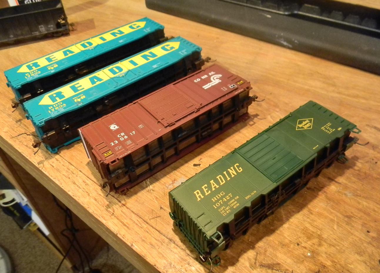

Gave the two 40' boxcars weathering treatments after dusting off the X-21. The Conrail high cube got a dose of black wash and then I pulled the wash off of the Conrail decals, while the Reading AAR got a black wash followed by good dose of rust on all of the rivets as well as a full-on rust and grime treatment on the roof and then some road spray on the lower sections. Certainly aren't the boxcars they were yesterday!
The Reading kit is a wobbler. One of the wheelset holes had to be filed open to go over the mating cylinder on the car, and I suspect some further opening up is needed. Could just be the cheap wheelsets and might be the motivation to buy some decent stuff using my gift certificates to modeltrainstuff.com that I received under the tree.
The sea foam 50-footers are receiving many coats of the dark green wash, and I think it's beginning to make a difference, but pictures won't be forthcoming on those for a few hours.

Todd, keep in mind the wheels with barbet bearings were always coated in oil so they seldom rusted on the outside. The dirt and oil would build up to a hard cake.

Thanks for the education, Charlie. I'll get the brushes back out!

Spent the afternoon on my day off with Kartrak decals, gray paint, wheelsets, etc. I may have some more Barbet's to get to in the future, but everything out on the layout currently has been adjusted.
The green dye experiment is a dud for these two sea foam box cars. I've decided on a different tact for both of these.

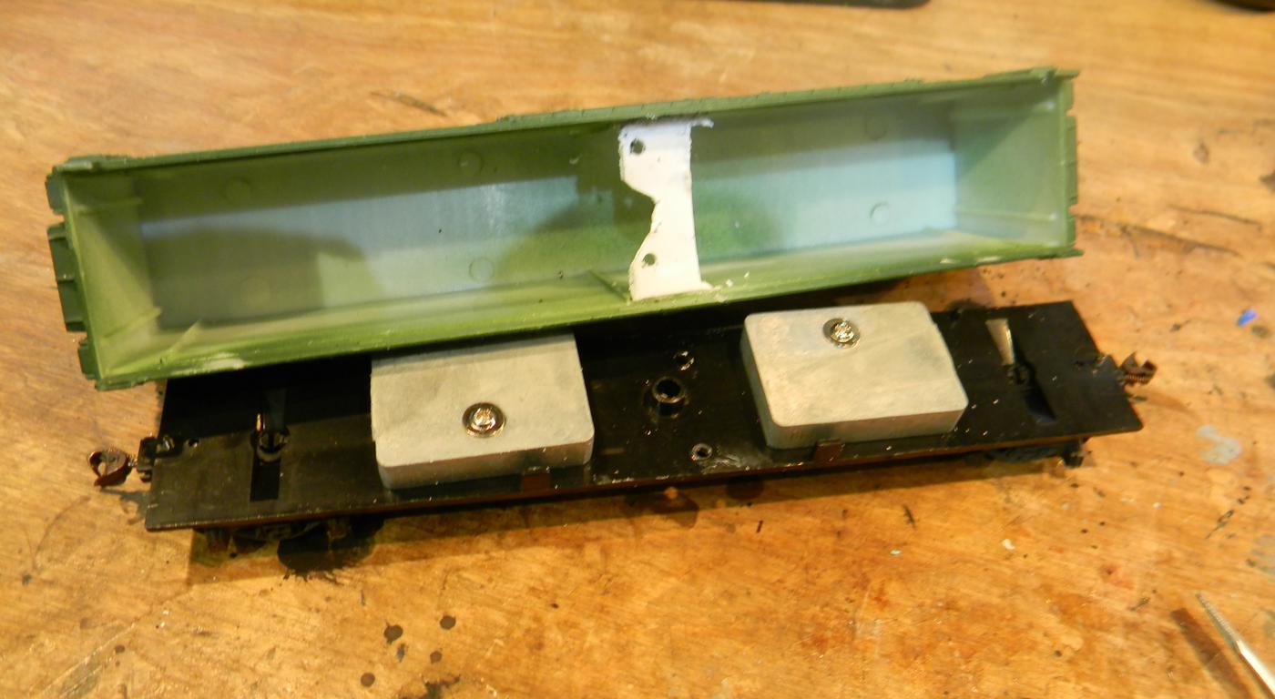

One of the other box cars was a Life Like Reading XMLF box car that has a more prototypical paint scheme.
Unfortunately the chassis was for truck-mounted horn hook couplers. So, I took the best of each car - the Mantua chassis and the Life Like car body. However, the chassis was a tad bit smaller than the body. I built a receiving frame (a piece of thick styrene located in the middle of the car just above where the chassis would sit) and glued it in the body. Drilled two holes for small screws in the chassis that line up with holes in the receiving frame and now the chassis is firmly mounted in the carbody but can be removed. Now it's time to weather that car.
The other Mantua sea-green boxcar received a paintout over anything Reading on the car inspired by this one here ( CR 147332 - RDG Class XMe | Conrail Photo Archive (thecrhs.org)). I plan on covering the paintout areas and weathering the remainder of the car and then adding white "CR" decals and an appropriate road number.

This afternoon was spent with paintbrushes, decals, makeup brushes, and washes to suitably (or maybe unsuitably for many people's taste) weather these two boxcars. (Yeah, the rust treatment on the un-patched Reading unit is probably on the excessive side - but I'll give it a few days and I can always tone it down). They now fit in quite well with my Conrail consist of covered hoppers and boxcars. I couldn't find an exact equivalent (turns out it's a Reading RBLa (modified and stretched 40' XMy) for the patched-out unit, so I made up a Conrail number for this car (230635) and decaled it accordingly.
I think that does it for the boxcars in that box. The two that remain aren't worth much time or effort.
