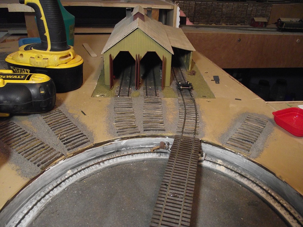

I found that the turntable track was about 1/16" higher than the outside level so I'm going to use some 1/16" basswood to shim the track to match. The enginehouse tracks will need the shim at the turntable but then will have to drop to the original deck height to match with the engine house's tracks. I glued this piece of basswood down, them sanded a bevel into it with some 80 grit sandpaper.
Then it was just figuring out the placement of the ties to line up both the turntable and enginehouse tracks. Then three sets of ties are ballasted but I'm adding more outdoor tracks so I'll add those ties and that lay rail on everything.

I was going to start tracklaying when I realized that the enginehouse was still a bit tall so I had to take everything apart and shim my splice blocks down the width of a toothpick. With that fixed. I added the ties and ballast for the rest of turntable tracks. I hand laid the first track by laying the right rail down first, spiking it down and then laid the left rail down using the right for proper guage. The two curved track are probably the hardest but not inpossible. I'll do the second curved track next.

I've been working on the turntable tracks. These are more complicated that you would think. Either that or I've complicated the situation myself with overthinking the project.
After I finished laying the three transition tracks to the enginehouse, I checked the alignment a second time. I found out that the tracks from the turntable were about 1/16" too high so I had to figure some engineering on the fly. My solution was to pry up the rails from the tiesabout 6 ties in, then use a manicure file to sand the ties down to where the rails would be equal with the turntable. I had to do the same thing with the other three tracks but there wasn't any rails laid yet. I was able to use the same holes for the spikes and everything went back together fairly easily. I'm going to add some diluted matt medium with a flow enhancer to 'glue' the spikes down into the ties.
This morning I finished spiking the last of the rail down. I had re-painted the sanded-down ties with some polly-s RR tie brown. the two longer tracks have wheel stops glued down on the ends as well.
