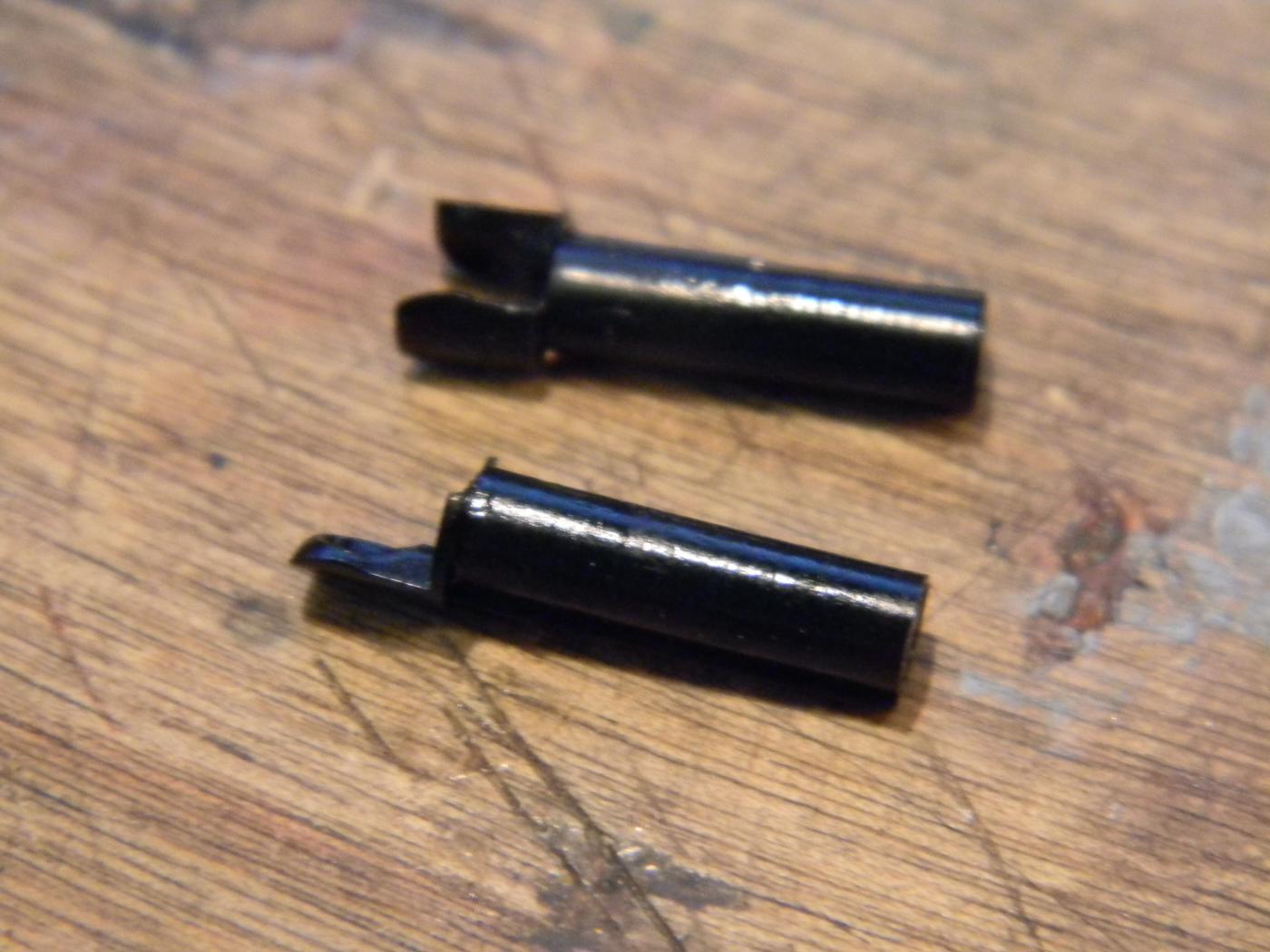

Well, that Roundhouse RS-3 I got for a song....  not so good.  Opened up the shell and the driveline tumbled out.  Defunct or half-missing motor mounts (Ok, I have spares) and a keyed driveshaft with a missing ear....
Anyone have a spare for purchase?  I can furnish some dimensions on this piece...  Only thing I can find currently on evil bay is a full set (two of each with the mating sockets) for a ridiculous price...

I appreciate the look, Charlie.  If push comes to shove, I will adapt something, but it sure would be ideal to have the shaft designed to slide into the housing and allow for some movement fore and aft...

The one I found right away is approximately 9/19 inches long on the shaft only with a 1/8 (approx) diameter total length is 3/4 inches and the jaw with is slightly less than the shaft diameter. The spline is no more than 1/32.
The price (if it will work is 17$ but with the Big Blue member discount of $17 that makes it free.  I hope it will work.
Charlie,
Appears to match the broken one exactly in terms of dimensions. The Big Blue discount is fabulous! I'll message you with an address... Many thanks!
