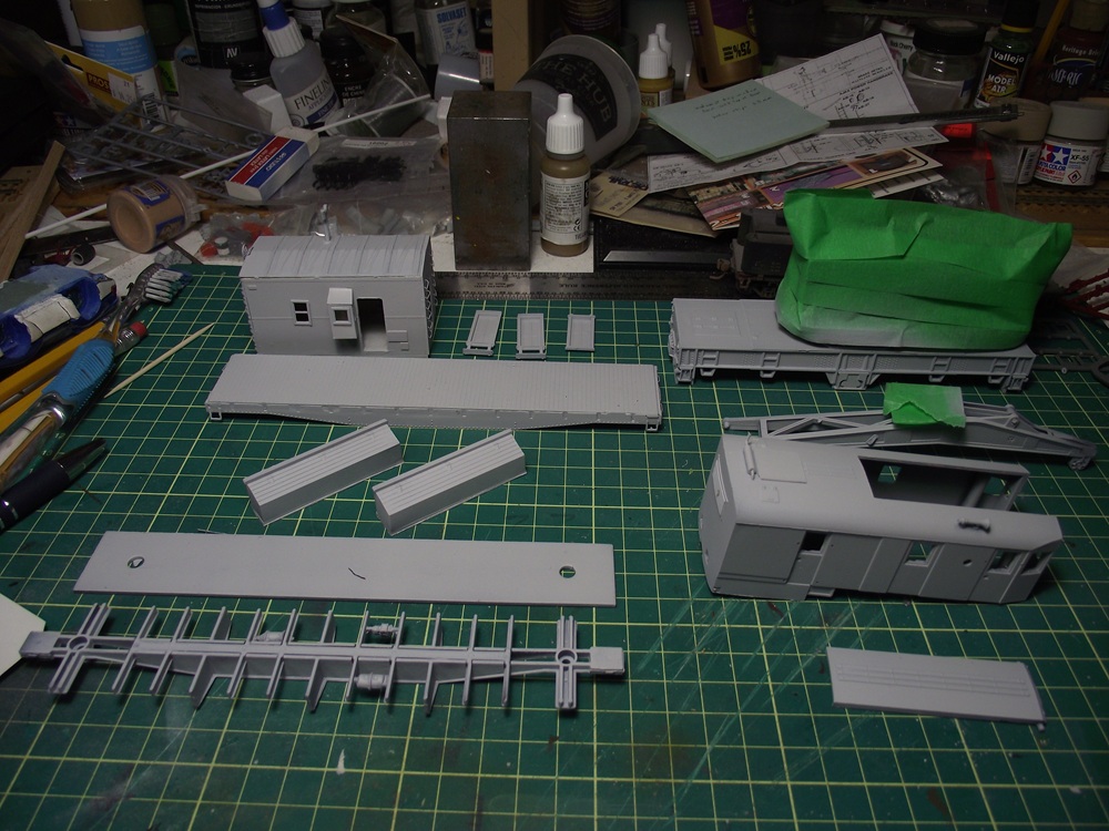

Since I last posted I sprayed primer on all the parts that will be painted:
I'll wait a few days before I start painting the first colors
